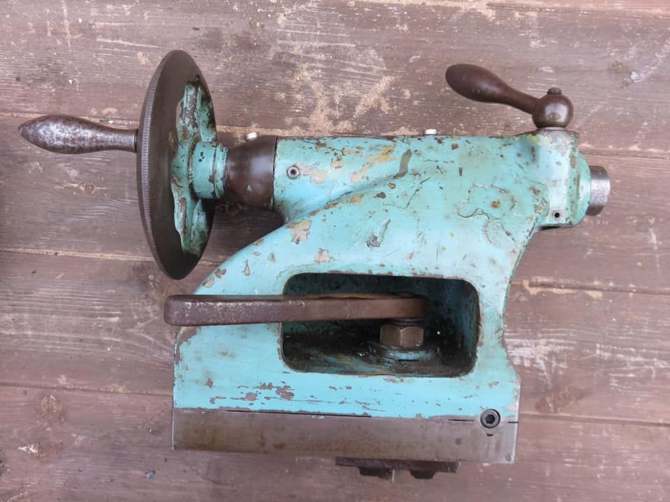

I'd still think a modification can be made to make a permanent handle, like the later models

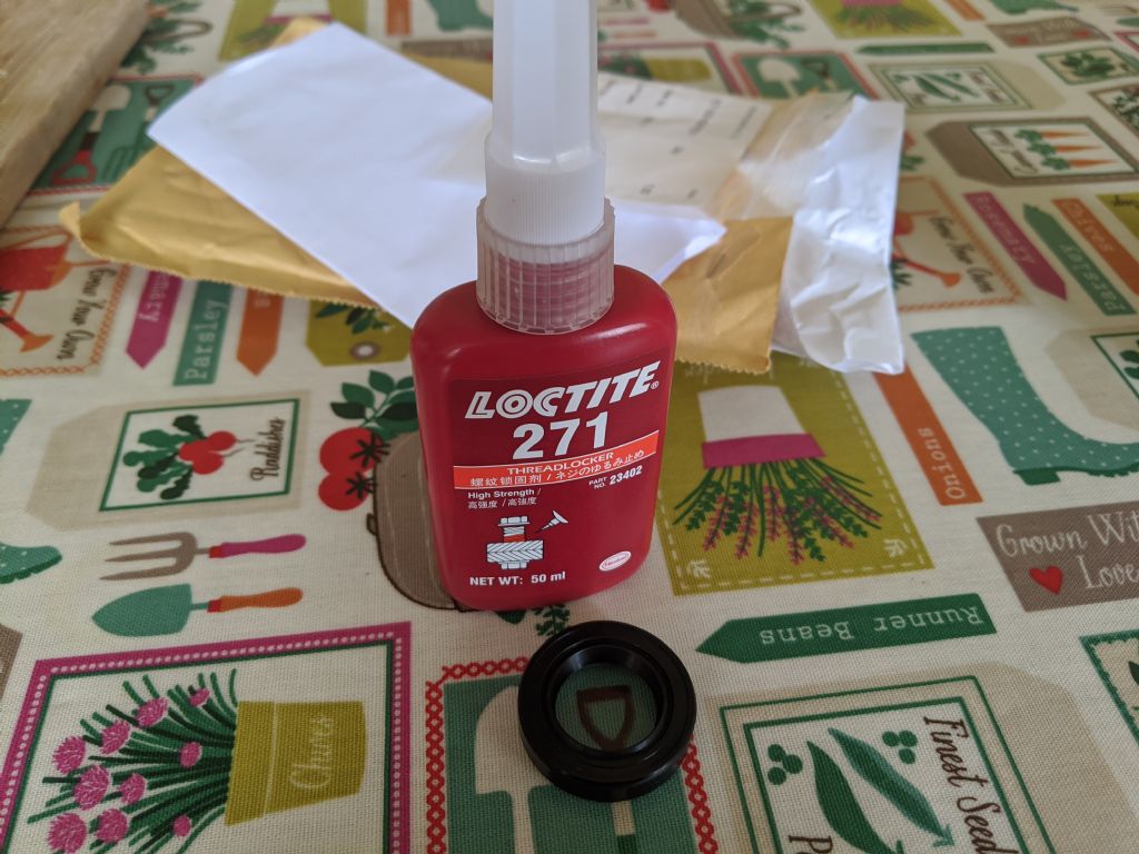

The bulb I used was the one Phil recommended, which I found to be the only supplier of that exact one in the UK. You might struggle in SA. However, it depends on the light and if you're going to run it from a separate plug, or wire it in with transformers as I did. I made mine to run from 12v since that's what the original was. I could have made my life a lot easier by just using a 240v Bulb and not putting in a low voltage transformer, might have been a lot brighter too! If you can't get that specific size of the bulb you can get an adapter so it takes more standard LED sizes. I'm sure Phil talked me through all the options earlier in the thread. I'm sure it's becoming tricky to find things in it now it's so long!
BULB

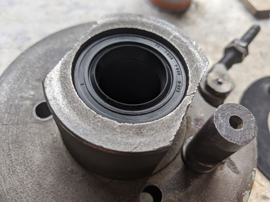

On another note, Loctite and oil seal arrived this morning, so we will have a working lathe once again, Perhaps even new and improved with the spanner! Still waiting for a nice cheap Chinese boring bar to arrive so I can get on with making some die holders
I didn't realise the Loctite was going to be pink. And it smells a bit like bubblegum? Or perhaps bubblegum smells like Loctitelaugh

I see no reason why you cannot make the clamping handle for the tail stock. You can even put the handle to be on the front. Try a lobe setup where you can get some leverage from the handle lobe to the clamp lobe.

Yeah Loctite has all these weird smells. Some people do not know the number, but the colour and smell for each type required. Give me the yellow one that smells like tulips...

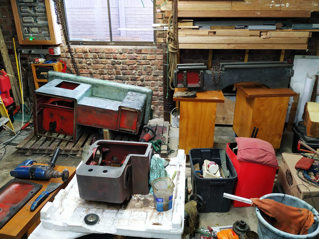

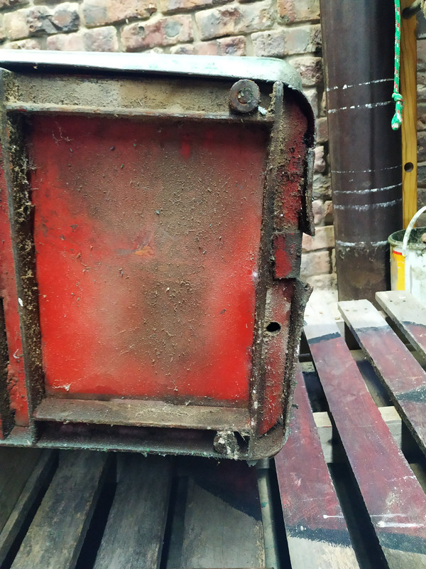

Have fun fixing your lathe. Here is where I am at.
The bed is heavy, so I lifted it with the block & tackle and put it down on two of my workbench cabinets with wheels and rolled it to one side. The stand is not heavy at all.
Phil I will post pictures of the fees of this stand so that you can see where it should be located.

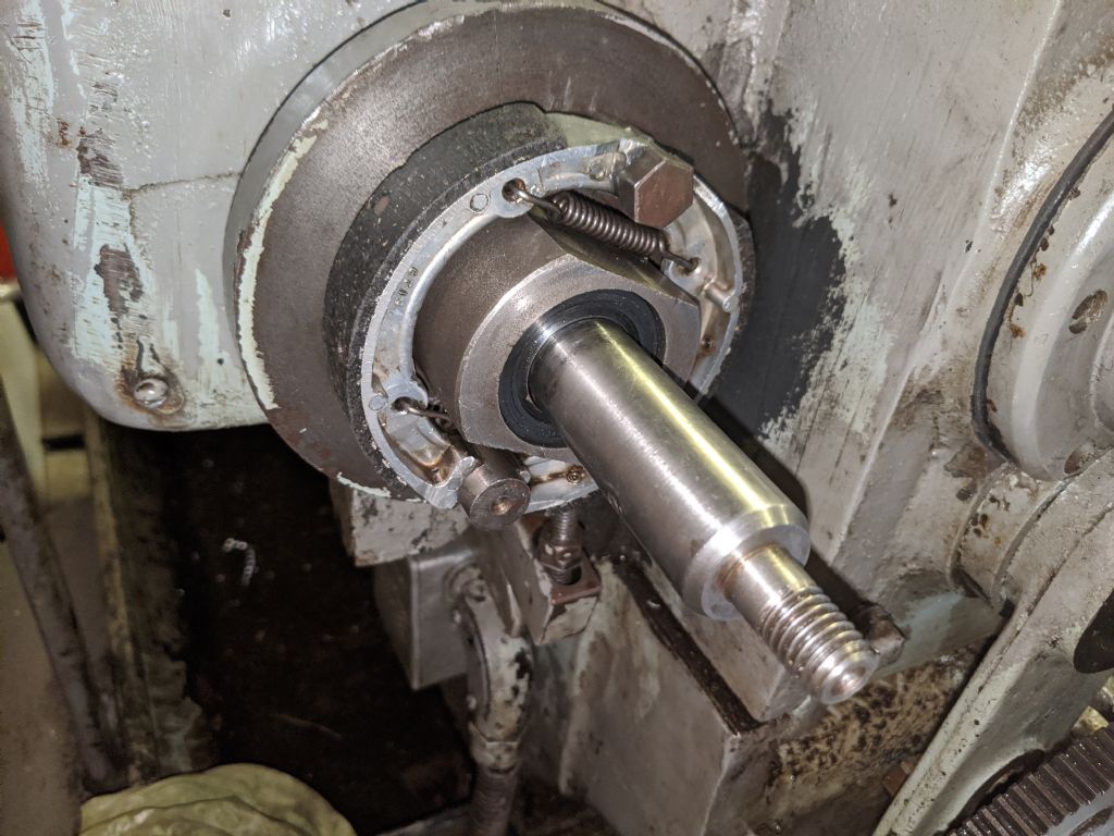

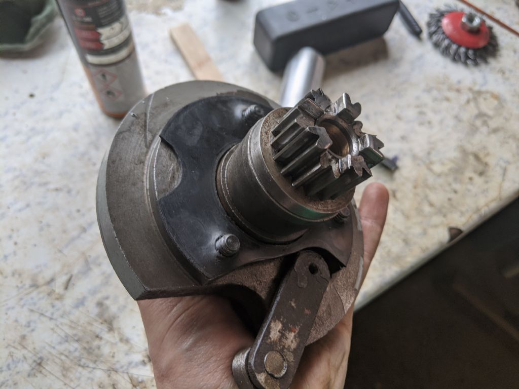

Lathe is all back together, loctited, tailstock handled and brake sealed nicely. Only time will tell if the seal is any good. Hopefully no more leaks!
Getting the sprung bit back on was an absolute pain, but I managed eventually. May be worth getting the right tool If I plan on doing it again

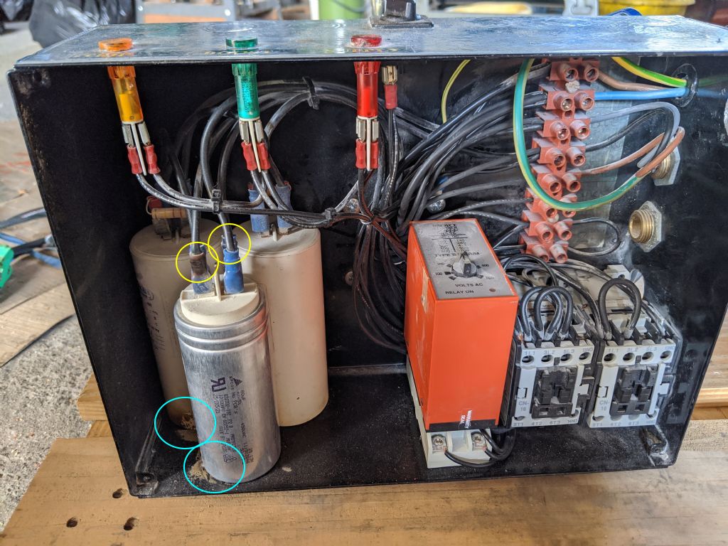

So, all is well, or at least it was until I switched the lathe on. Since the lathe had been in bits when I was testing the bulb, I never tried it with the lathe running.
There was power to the lathe, the light was on, the 'off' 'on' 'on with coolant' switch was on 'off', so I turned the switch to 'on' and the light went out. Not a good start.
So I had a bit of a play with the brake. It's working much better than before. I'll take it back off in a couple days to see if there's any oil in there again.
As I was playing and trying different speeds, the light came on and flickered and did all sorts. It seems to work in some speeds and not at all in others. When I switched it back to 'off' the light did not come back on, so I think there must be a loose connection that is being shaken somewhere. Perhaps my switch is faulty. Or could It be due to the three phase being from a converter?
Anyway, here's a couple videos, two of brake and one of the light. Opinions would be very useful. Thanks

Your LED is picking up phase cycling. Sounds like one of the caps in your Phase Converter is on its way out. Put a normal wall plug top on the light's black transformer input lead and plug it into a 230V wall socket. Should burn solid. OK it still pulses but your eye cannot detect the on/off cycles. LEDs are not solid on light sources. LEDs are diodes and will pulse as they chop half the voltage cycle off and uses only the unrectified half.
IMHO you have a cascading pulse issue. First Phase Converter -> Isolation Transformer -> LED switch mode transformer -> LED rectification. That is 4 pulse alterations/variations.
My solution? Just plug the light into a wall socket and put a 230VAC LED bulb in. They cost like nothing and you can buy them anywhere.
I would load test the caps in your Phase Converter.

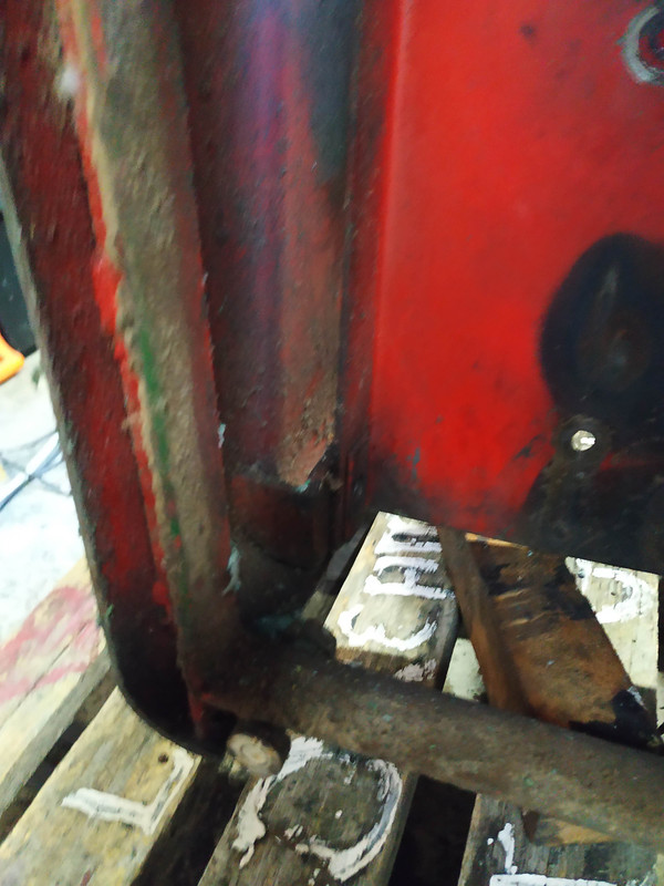

Phil, the adjustable feet. Hope it helps!
Right hand side. The one in the front fits onto the thick bottom shelf.
The left hand side. The back one is difficult to spot so another angle photo of it.

Hmm, adjustable feet? That makes me want to look under my lathe. Not quite possible while it's still together. However, I'm sure I had a hole in my lathe where your right foot is
Make yourself 4 large wedges from 4x2 wood and then use a crowbar to lift the side bit by bit whilst pushing one wedge at either corner in. Stable way of jacking your lathe. Clean the floor while it is in the jacked position and remove all the lost tools, nuts and bolts. wink

Question - How old are the caps in the Phase Converter? If more than three years, then they must be replaced.
Can you post the values and ratings of these caps?
Herman van der Merwe23/05/2020 13:35:15
avatar
180 forum posts
I had a look at you photo of the caps.
The silver one definitely has overheated as indicated by the two yellow circles.
The back left one leaked and maybe the front silver one as well. See the cyan circles.
Check if those are starting or running caps. The white ones normally are starting caps and they cannot continuously give the rating required.
The contactors are filthy and bridging can occur. You will need to remove these and clean them in an electrical cleaner.
Also, clean and check the monitor relay. What is the existing setting?
I also see a loose wire on T1 on the left contactor.
Heck clean the whole thing. It is really dirty for an electrical system.

Richard, I think I concur with Herman, who probably has more experience of artificial three phase systems than I have. The behaviour of the lamp does seem to be caused by a fluctuating power source, you coul;d try it on the mains, and if that is ok then you have confirmed it. Gasket material will be gratefully recieved!

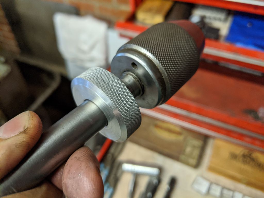

I'll look at the capacitors when the capacitance meter arrives. If they turn out to be bad, I'll message the machinery company that I bought it from, as I might be able to get them to pay for replacement capacitors since I don't think that's acceptable.

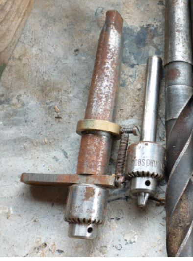

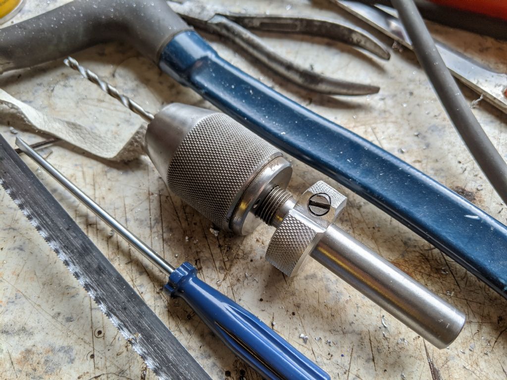

I ordered a large selection of morse taper tooling for my lathe. In the package there was meant to be this micro drilling attachment to allow you to drill small hole with feel so you don't snap your bits. Anyway, long story short, the man mis-sold me and i didn't end up getting them, just the drills. So, I'd like to make one. I've seen oxtools video series on making his own, but this version here looks a lot simpler, however I'm not too sure how it would work. Any ideas? I couldn't find anywhere they're sold, but i'm not sure of the correct terminology to search.
After finding Joe Pieczynski's video and thought I could make a similar thing just from a little chuck I had lying around. So, I made a collar to go on the shaft this morning. Knurling is still very satisfying and I am finding parting off much easier after all of your tips. I can't make any more of the parts since I still don't have a boring bar, chinese post is slow.
But, I even made my own screw. It's just the simple things that feel like big achievementslaugh
Then I've been occupied photographing about 20 bowls which I need to sell. And refinishing a table for my aunt.
Anyway, I hope someone can help with the micro drilling mystery. I have an idea, but I'd like to hear others as well.

@Richard, which capacitance tester did you buy? I do not want you to waste money as it is very simple to test a capacitor with a voltage meter, a stop watch and a battery (or other voltage supply).
Please let me know the details of each capacitor so that I can check for you which is starting and which running caps.
You will have to clean that cabinet and fix the wiring.
Where did you buy the drill bits? I would simply do a charge back if you bought via e-bay or similar. If you paid with PayPal even easier. Just reverse the transaction.
Your work looks good! Wish I could start turning.
