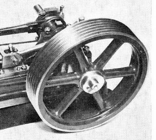

As well as flat and crowned flywheels, they may be made with rope grooves, like this. This is a Stuart Turner S9 Ian S C

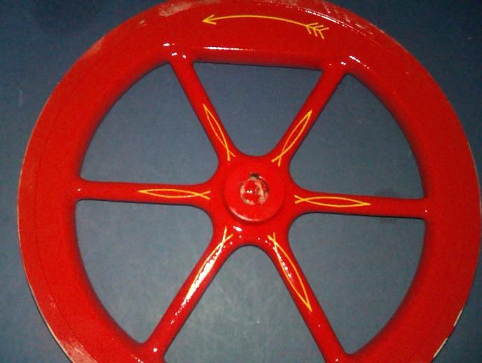

As you often need to hold the flywheel by the spokes or inside the rim you run the risk of damaging the paint.
I tend to just mask the outside face of the rim and the bore to keep the worst of the paint of any bare metal then when its dry mount the flywheel in a mandrel and just take any paint of the rim with some abrasive ( cover the lathe bed with a board)
Finish turned flywheels masked for painting
Add the pinstriping
Cleaned up to 400g which gives the satin finish I prefer to a blingy polished one
Edited By JasonB on 18/12/2014 07:34:42

Nicely done : how did you do the pinstriping ?
JasonB18/12/2014 12:53:39
avatar
25215 forum posts
3105 photos
1 articles
Mostly with just a ruling pen held against a suitable guide, in the case case of teh one above it was a french curve.
For rings around the flywheel I use the same ruling pen but steady may hand on the lathe toolpost as I rotate the flywheel by hand
You will probably have to thin the paint a little, the one above is Humbrol so just used their thinners. The one below was a gold acrylic so used some airbrush medium that I had.
