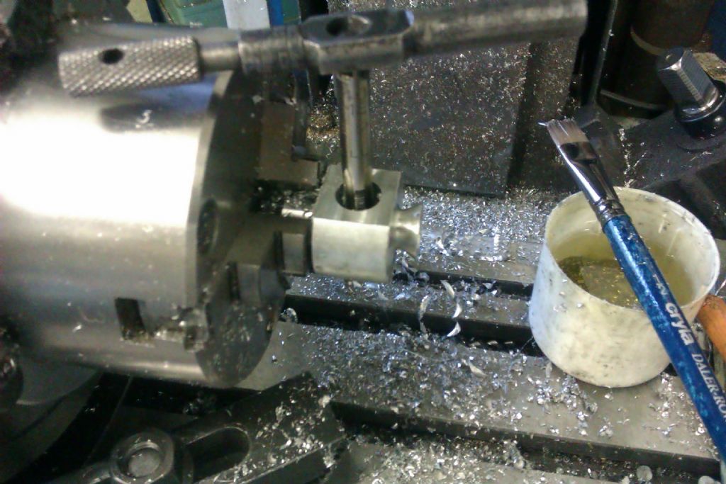

The wrist pin hole was then done making sure not to break through and allowing for the dia being larger than finish size.
Firefly126
The table was rotated 180deg and the 1.0mm hole put in.
Firefly127
Without removing the work from the chuck the table was mounted horizontally and clocked true to the mill axis, this ensured that the conrod slot is exactly at right angles to the wrist pin hole. I drilled two holes on 5mm ctrs 3/16" then plunged with 5/16" and 7/16" slot drills to remove most of the waste.
Firefly128
It was then just a simple matter of milling to the 12mm finished size
Firefly129

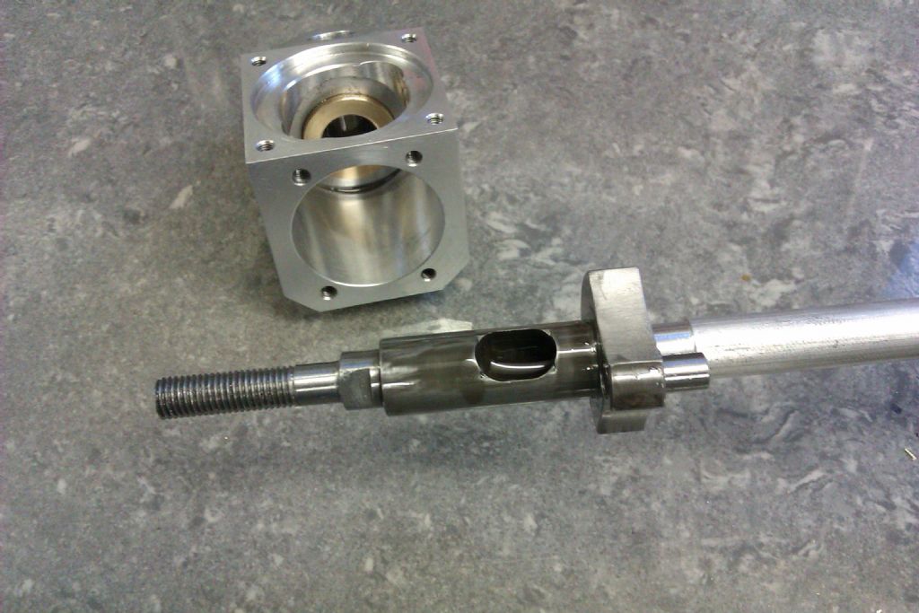

And here we have the finished liner & piston
Firefly135
Firefly136

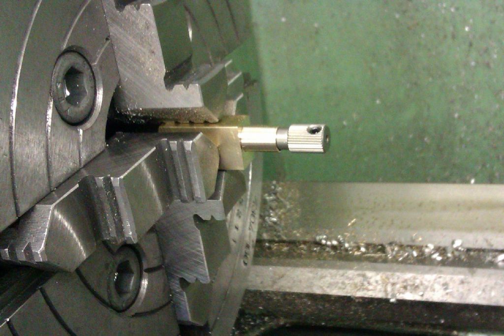

Little End Plug
Start with a bit of bronze, turn the spigot to a good fit in the gudgeon pin hole
Firefly99
Turn the OD to be a fraction less than the pin and drill the 1.0mm hole. I find a bit of cutting fluid helps when drilling bronze as it stops the drill bit getting hot and sticking. Then part off.
Firefly100
Hold lightly by the spigot and round over the end and thats it done.
Firefly101
Firefly102

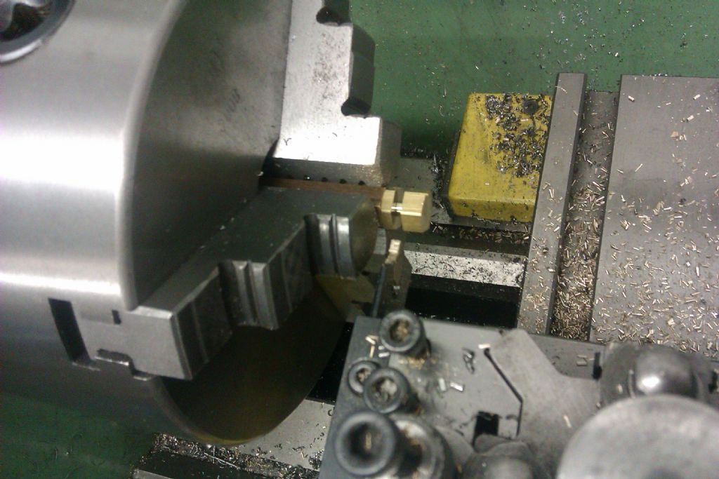

Fuel Nipple
I decided to use 1/4"x40ME thread on this rather than M6 so started by turning down a length to 1/4" dia.
Firefly112
Cut the thread using the tailstock die holder.
Firefly113
Use a small parting tool to cut the relief at the end of the thread, reduce the end to 2.35mm dia and then drill the hole, I went about half way from each end.
Firefly114
Part off and then screw the threaded end into a suitable hole in some scrap. I actually have several lengths of brass hex with threaded holes in one end and a male thread on the other all in various ME sizes they really come in handy whan making steam and fuel fittings.
I used a parting tool to cut the reduced dia behind the hose barb.
Firefly115
Turn down the remails to 4.25 and then cut the hose barb, I could not be bothered to set the topslide to 6deg so just swung the tool so the back edge was at an angle and used that.
Firefly116
Finish drilling the hole and round the end and the corners off the hex with a file and thats another bit out of the way.
Firefly117

So here we have the crankshaft and pin.
Firefly155
Which were pressed together in the mill vice
Firefly156
So they looked like this
Firefly157
I then turned up a taper mandrel from a bit of 3/8 alloy rod and used this to hold the crankshaft while it was hand lapped with 1000g until a nice fit in the bearing.
Firefly158
And here is the finished item with the drive nut on the end.
Firefly159
And all assembled with thrust washer and driver, no noticable end play but turns freely with a nut against the driver and a whiskers clearance on the backplate.
Firefly160
J
Edited By JasonB on 21/07/2012 21:04:51

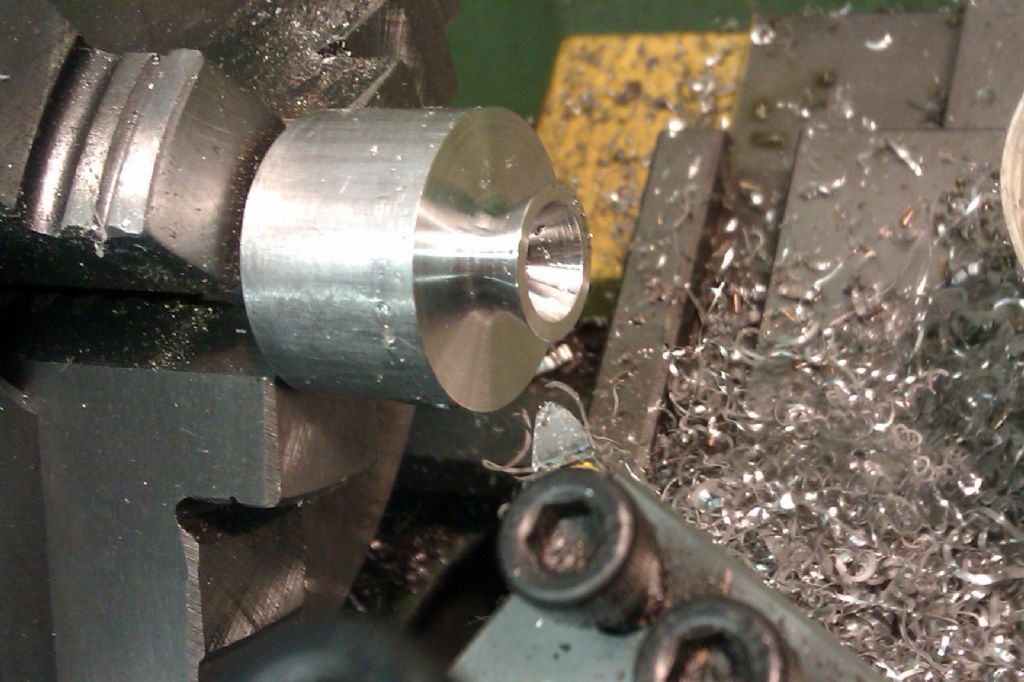

Carburettor Body
Once again I have deviated slightly on this one partly as I did not have any 3/4" hex bar and partly because I wanted a less bar stock look.
Starting with a length of 1" dia bar the spigot and step were turned using the inlet in the crankcase to test fit the spigot to.
Firefly173
The hole was than drilled and all corners chamfered
Firefly174

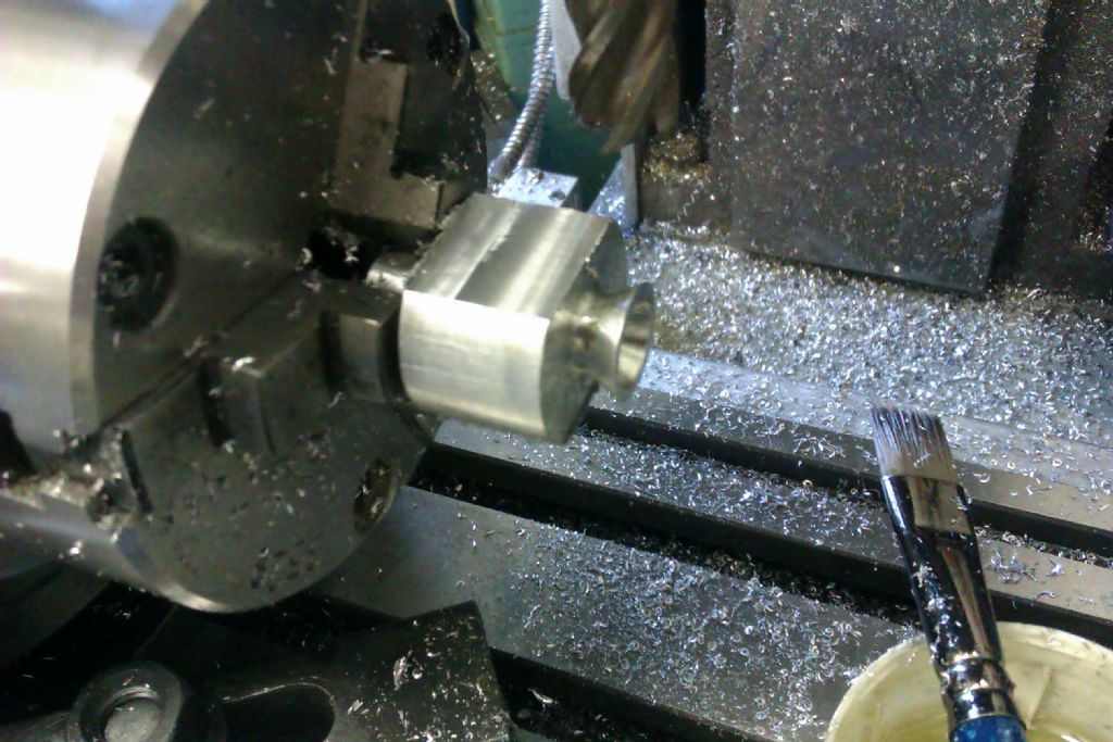

Sufficient was sawn off the bar and then holding by the spigot I roughed out for the inlet trumpet.
Firefly175
Then used a mini boring bar to cut the internal taper
Firefly176
Without altering the top slide angle a round nosed tool was used to cut the external profile
Firefly177
Transfering the work to the rotary table the two sides were milled flat and to finished width
Firefly178
I then drilled tapping size before using an FC-3 cutter for the 10mm counterbore, this gives a flat bottomed hole with the advantage of a turn or two more thread than the drilled hole shown, its also a better finish for a good fit of the barrel.
Firefly179
Tap the hole and while in this orientation drill and tap the 2.5mm screw hole

Jeff Dayman23/07/2012 21:00:18
2356 forum posts
47 photos
Hi Jason,
The crankshaft and carburetor look excellent, beautiful work as usual. One 'design' question - what seals the carb spigot to the crankcase? I am sure you have a close fit between carb spigot and crankcase, but ideally this should be sealed gas-tight. An o-ring or flat silicone gasket could be used if space and / or suitable counterbore were planned for at the joint. If there is no room, a smear of RTV could be used as a last resort. Just some thoughts....
(I had problems years ago in commerciallly-made RC aircraft engines with bad sealing in this area and rear crankcase cover seals leaking causing some running issues. I fixed several of these leaks with RTV sealant but felt it was a bit of a rough fix at the time.)
Again, great job so far!
JD
Edited By Jeff Dayman on 23/07/2012 21:00:48
JasonB23/07/2012 22:27:34
avatar
25215 forum posts
3105 photos
1 articles
Funny enough I was in two minds to leave off the step on carb spigot and fit an O ring but thought I Would try it first as Alex says it is a Gasget less design. If needbe I'll ad a smear of liquid gadget anywhere that needs it or machine the step off and go with the O ring.

Carb Barrel
As the cross hole is quite close to the edge I chose to drill first a few mm from the end and also from larger stock (1/2"
Firefly184
It was then turned and faced to size before lapping to the carb body

Mixing Disc
This is fairly straightforward tutning to form the spigot, drill and then part off a bit over long
Firefly187
Before reversing in the chuck and facing to thickness

The centre of the hole was marked and set to run true in teh 4-jaw and the spigot turned a nice running fit in the disc
Firefly191
It was then drilled, tapped and counterbored. Make sure you use a M4x0.5 metric fine thread if going with the OS needle
Firefly192
Needle was test fitted before removing from chuck.
