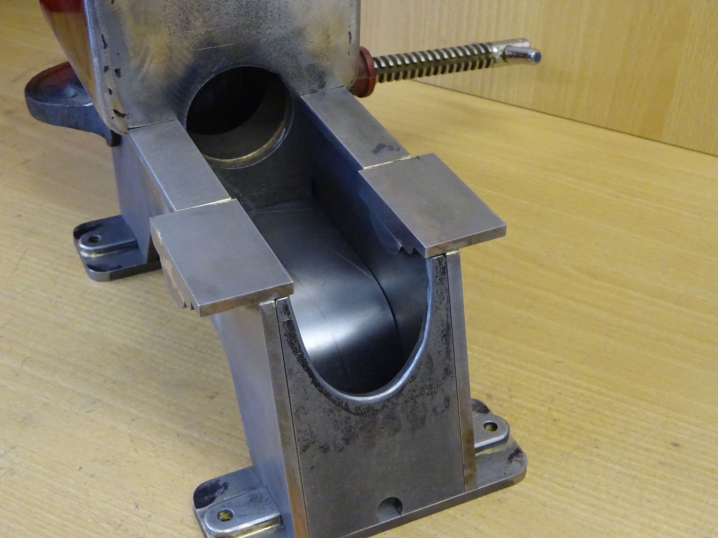

If you are mainly doing thin sheet work like Ian shows or small section stuff then the 404 may do you. I wonder if the 404 would be able to silver solder let alone braze something like this which is 10mm thick plate at the ends and 5mm wall tube. Silver soldered with the 7.7Kw Sievert?

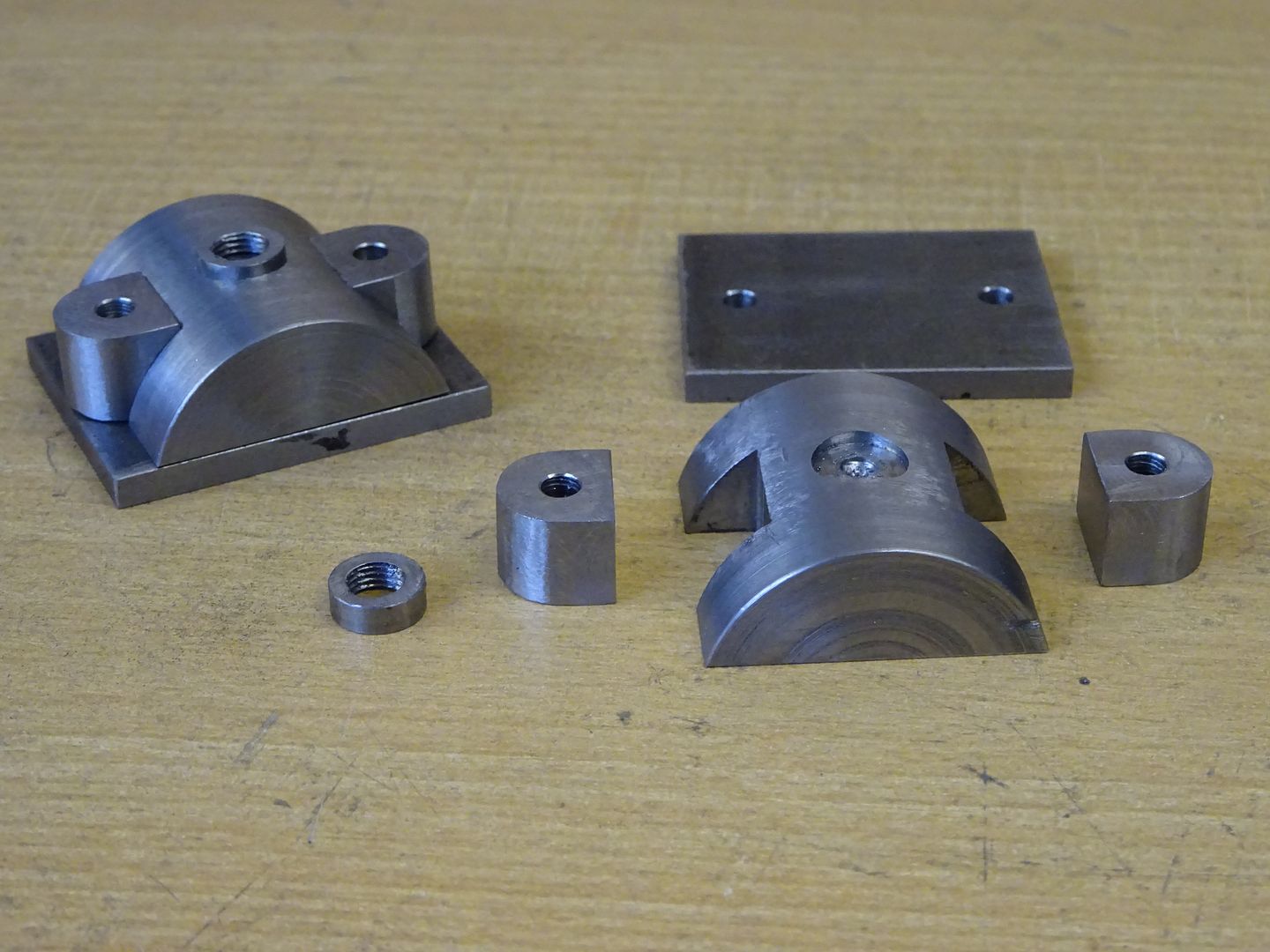

At the other end of the scale something like this small 20mm tall brass fabrication can be done with the same 7.7kw burner. The 630deg temp of silver solder means you are a long way from risking damage to the brass part which is far more likely at brazing temperatures. It starts to get to a point where the brass and bronzes become soft enough to distort even if thin parts don't melt particularly if you ar eapplying any form of clamping to hold the items together.

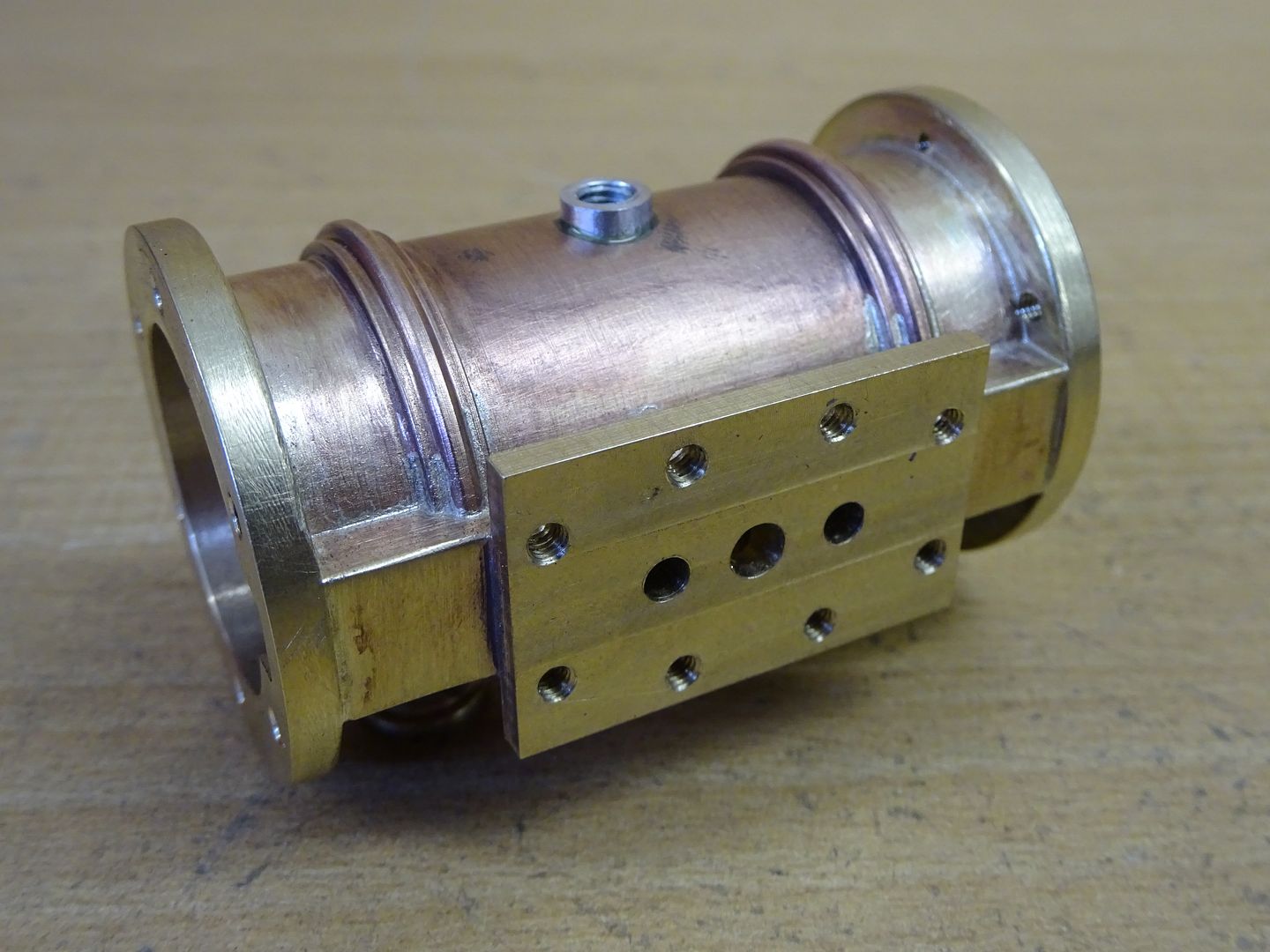

Typical cylinder fab, 24mm bore brass and 660 leaded bronze again stuck with silver solder and 7.7Kw burner

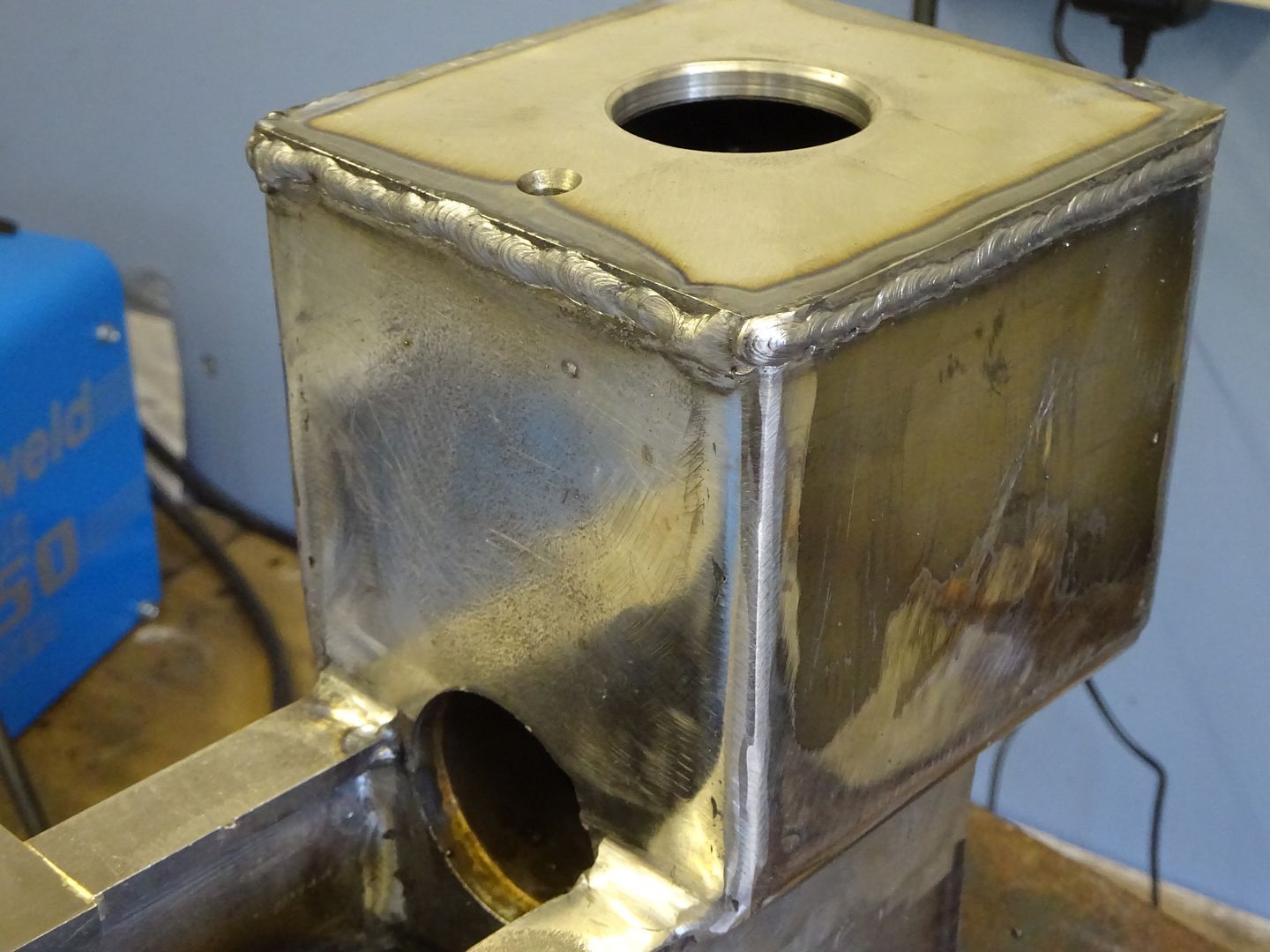

Most of the main plate work was Welded with my poor stick welding work

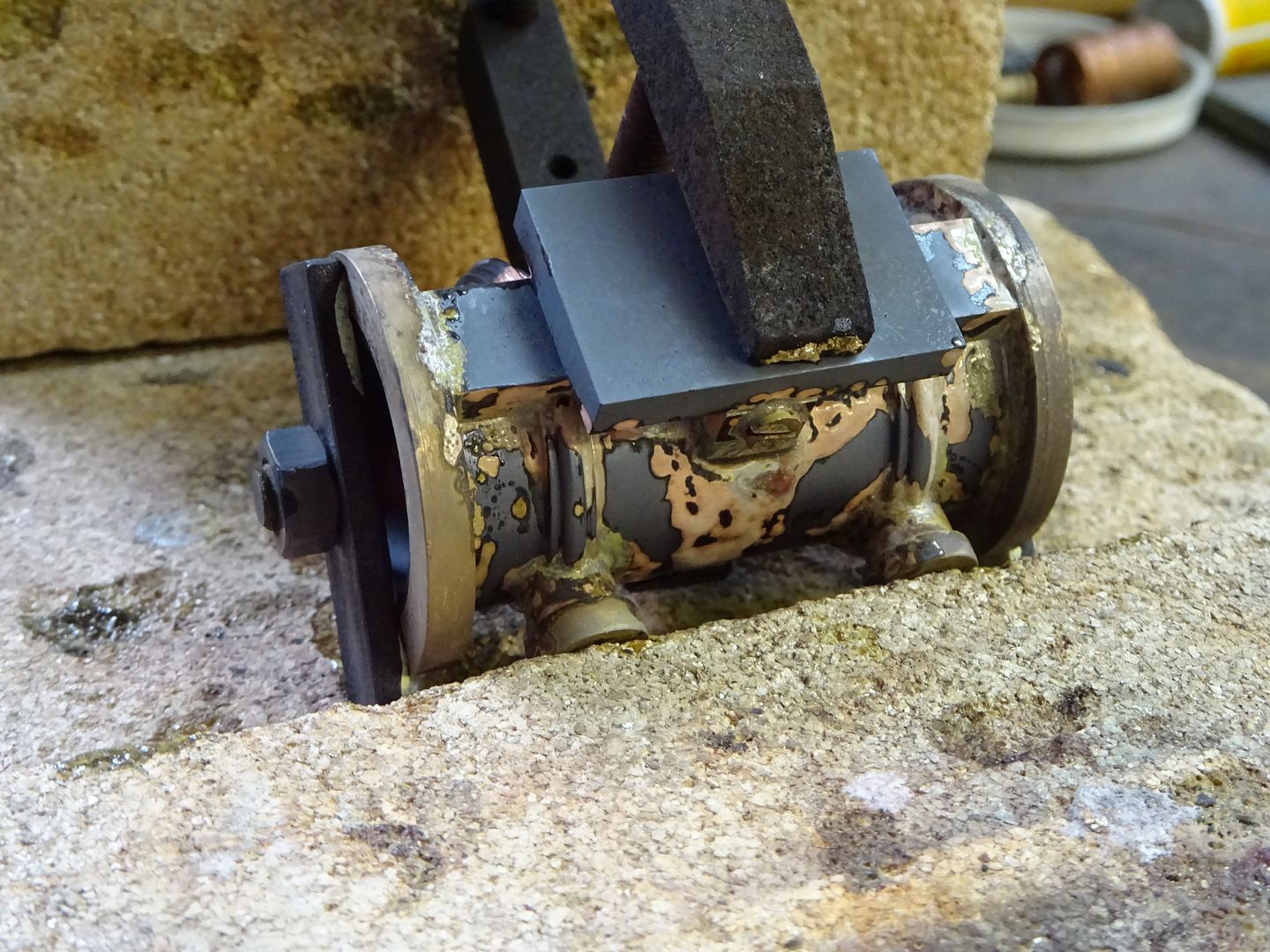

Smaller parts were silver soldered onto that like the lower bearing housings, bosses on the fet

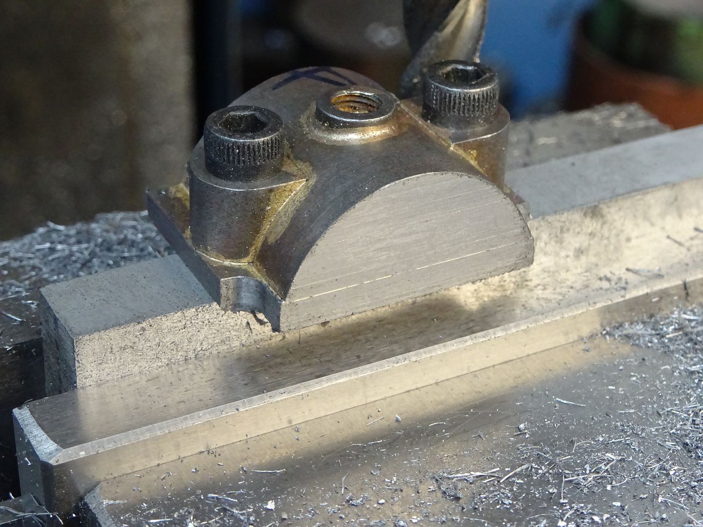

The upper caps were also silver soldered fabrications (M4 screws for an idea of scale)

PPS, Jason is the cooling water tank stainless ?
Edited By noel shelley on 06/06/2023 14:17:12
JasonB06/06/2023 14:39:52
avatar
25215 forum posts
3105 photos
1 articles
No just a steel fabrication, should not be much worse than cast iron like the original. I usually slosh something around inside to as a bit of protection. Three is a cast iron sleeve that passes right through to form the cylinder Loctited in at each end which is the usual way that most of these models from castings are done as it makes for a much simpler core to form the hollow inside rather than having to have it wrap around a cored cylinder to form the jacket
