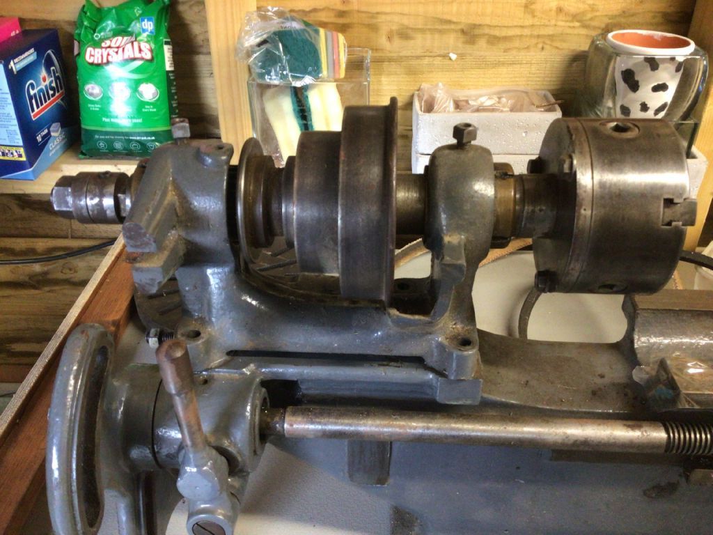

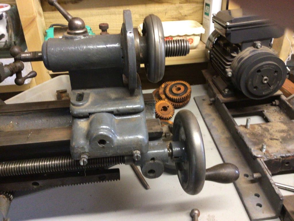

Hi, if you compare these two photos of Haydn's, which I've turned round, they look just like the headstock and tailstock of the picture of the unusual Myford lathe J1102 one that I mentioned in my previous post, even to the saddle rack just extending past the tapered shape of the bed at the tailstock end.
Haydn, the leadscrew is driven by change wheels between the leadscrew end to the left of the clutch lever and the headstock end at the left, the change gears being mounted on pins that fix onto the banjo that swings round at the left of the clutch lever, the change wheels you have do seem to be the correct ones for your machine, but you will probably need a few smaller and larger ones.
Regards Nick.
P.S. It does look like a Drummond type, but it's not a M type.

I think its an M series headstock with parts of the casting hacked/chiselled off
and we'll probably have the same sort of damage on the other side where the backgear should be

e1ca26d7-f4fa-4b5b-bca0-fce1f2608957.jpegAdy1….hummm ! I see what you mean….the bed is not damaged, in fact most of this lathe seems in very good condition, all bearings/slides are nice.
sorry about the inverted photos…working on it.ac21780c-3659-4b6a-a431-8a7d94dd501f.jpeg

Yes that picture gave an innacurate bedstock situation
Unfortunately I was right about your headstock, it's basically a wood lathe headstock when there's no backgear, slow speed high torque things like thread cutting are far more difficult
Nicholas looks right about it's provenance, he's even sawed off part of the rear lug to make that sheet metal cover fit snugly
Perhaps the lathe was adapted for woodwork, which is very messy indeed

Strictly speaking it isn't a wood lathe headstock just a standard one that has had bits sawn off. - the front part of the backgear guard and the rear arms for the layshaft. Headstocks do appear from time to time on ebay.. You can still get a lot done without backgear and some modern lathes don't have it nor the old Drummond roundbed.

Strictly back gear is built into the headstock and uses gears not belts and pulleys. You can use a seperate shaft and pulleys to achieve a similar result.

"Back-gear" is a low-ratio gearing on the headstock itself, used when extra low spindle speed is necessary, especially in screw-cutting.
Only, your lathe has lost it, unless it is all in the assorted bits that came with it.
The holes in lugs on the back of the headstock show where it may have been fitted -but the spindle seems to have nowhere for its back-gear wheels.
It would show as a large gear on the chuck end of the spindle, and a smaller one at the other end, but both inside the headstock. They would have been matched by two gears on a shaft mounted on rearwards extensions (bolted on, on this machine) of the headstock; with an arrangement for engaging / disengaging them, and for disconnecting the larger spindle-gear from the spindle to allow it to work.
That separate assembly with the pulleys is the Counter-shaft, acting as the primary speed-reduction from the motor, and carrying the speed-change pulleys. With the back-gear lost you could replace it by additional belt-gearing. It would be feasible to make a new back-gear, but not easy, and a lot of work - then you'd need make up a set of change-wheels either with additions fully-compatible with the existing ones, or all-new.
Unless you intend cutting many, long, large threads, it is perfectly possible and indeed not unusual, often even advantageous, to do so by slacking the drive-belts and rotating the spindle by hand-crank. Remember to remove the handle before using the motor again! Myfords do sell a mandrel-handle for their lathes but it won't necessarily fit this one. Various designs for making them are in the model-engineering literature, and can be adapted to the specific machine. The basis is an expanding collet a bit like a masonry-bolt.
It is sad to see an old lathe damaged by some previous owner, as appears here. It is very hard to imagine why he removed (and lost?) the back-gear, and cut off that lug on the front of the headstock. If it was to allow fitting a new belt-guard, the motive is good but the method poor!
I think the forked lug still at the other end was for a reversing-pinion used when cutting left-hand threads.
