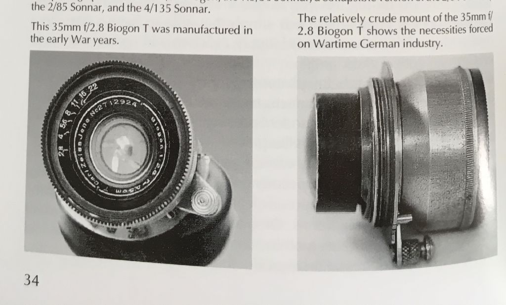

KEITH BEAUMONT19/09/2021 12:33:11
213 forum posts
54 photos
Michael,
I have contacted one of the leading dealers in classic cameras regarding this question and he has sent me several pages of a reference book on the subject of Leica thread Zeiss lenses.The problem is my lack of ability to put them on this forum. If you message me with your e mail address I can then forward them to you and you can decide whether they can be displayed.
Keith

Michael Gilligan19/09/2021 20:29:32
avatar
23121 forum posts
1360 photos
With enormous thanks to Keith and his contact … We have something reasonably approximating hard evidence:
That Biogon is Wartime issue, so a little later than the ‘Holy Grail’ pre-War 5cm 1.5 Sonnar … BUT we do have a photo of the mount : It’s still not definitive, but it does look like a Whitworth thread-form to me, and crucially, I see no reference in the text to any 60° metric pitch approximation.
