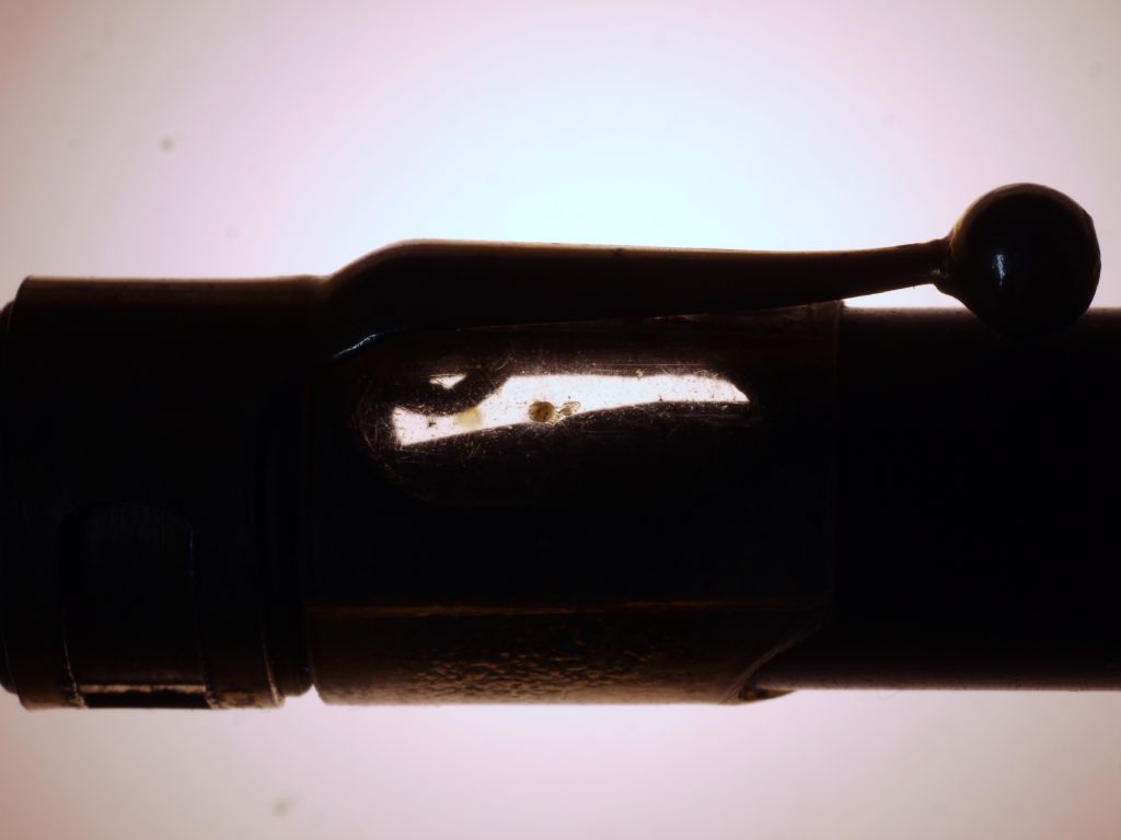

The strange device arrived in today’s post, Martin
Many Thanks yes
There will now be a [probably long] pause, whilst I try to decipher its function.
Michael Gilligan18/08/2021 19:35:32
avatar
23121 forum posts
1360 photos
Some minor discoveries already [but no real progress towards identification] …
A) The body and the screw are both made primarily of Ebonite, or similar … suggesting, but not guaranteeing, that they are acting as electrical insulators.
B) The screw can be removed completely, and it carries a brass rod which is tapered to a conical point.
C) There is an insert within the tube, visible through the ‘windows’ … and adjusting the screw changes the gap between this and the cone. This has the ‘feel’ of being a spark-gap, but there doesn’t appear to be a connection to either pole.
D) The pocket clip is plated steel and presumably a ‘bought-in’ commercial item; and it carries the number 5 and the words MADE IN ENGLAND, stamped on the inside of the straight clip.
E) The other metal parts all appear to be brass.
F) The gap in the engraved line above the scale is clearly ‘real’ not just missing paint.
Pictures anon

Michael Gilligan19/08/2021 11:28:14
avatar
23121 forum posts
1360 photos
Some photos to illustrate last night's observations:
The final one of these shows the conical brass point in situ
Michael Gilligan19/08/2021 17:40:40
avatar
23121 forum posts
1360 photos
I have re-formed the peep sight into something approximating its [presumed] original shape, and it now aligns as I would expect.
I have also removed the pocket-clip and the ‘transparent’ plastic sleeve.
Doing this has revealed a spring strip which contacts the brass rod [presumably this makes electrical contact rather than just providing friction : but I’m not yet sure] … There is evidence of this rubbing, in the first photo.
I have not yet been able to separate the brass portion from the main tube … and am wary of applying much force, in case there are other surprises lying in wait.
Time to stop for a while and do some thinking/searching.
… any new ideas as to what it’s for ?
