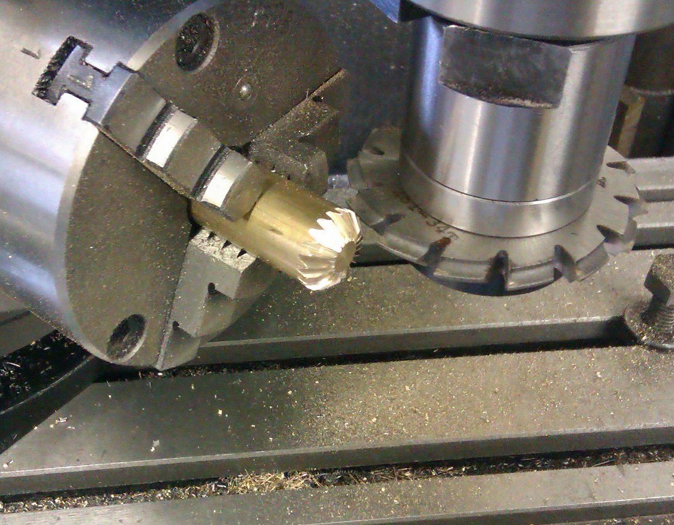

Also how do you produce a bevel gear on an RT that will only align to H or V?
Use a CNC mill:
After Final Cut
Unlike with a dividing head and involute cutters the above method produces a true bevel gear.

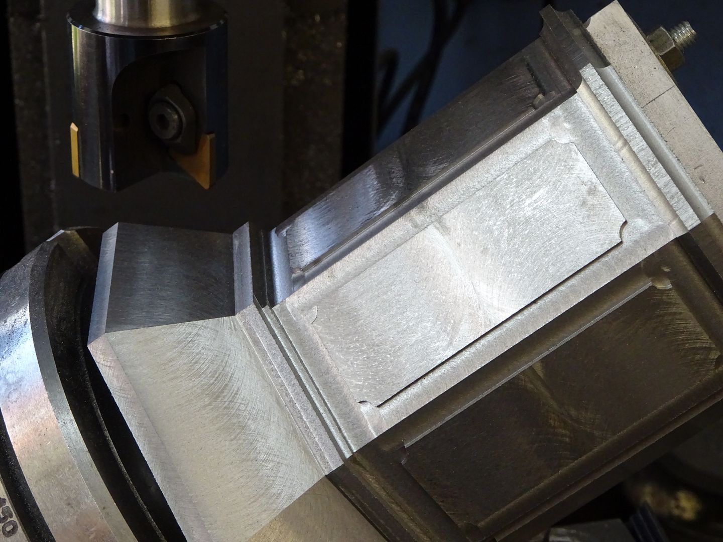

Or you mount the R/T at an angle across the table if you want parallel depth method bevel gears.
The vast majority of beginners would also have to mount  a dividing head in the same way as they are unlikely to have horizontal mills. May also have to do it this way as not all dividing heads tilt.

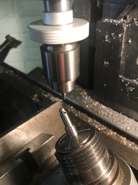

To give beginners the correct info I would have to disagree with that too, here is my R/T set to cut 45deg surfaces
And about a 3deg taper
Cannot see the set up so no comment - I presume an angle plate 'twix table and RT
The 3 degree tapered flutes, although looking good, it does appear to be tettering on the edge of the acceptable (really - sash clamps!!??) I would not have stretched a machine envelope in such a way as you have shown there.

Firstly setting the RT at such an angle directly on the table looks unsafe - given the need to swivel a vertically mounted RT (I note the lack of a tailstock support to your component - not something I would recommend) I would have looked at a swivel platen between the table and the RT.
Reply
I'm not sure what is unsafe, I can use the same two fixings that I would if it were mounted across the table. With such a short stubby workpiece do you really think that a tailstock was needed in that case?
Reply
Yes stretching the machine to it's limit, look closely and you will see the F Clamps are in addition to the usual clamps supplied with the R/T and used to hold the R/T so actually a firmer set up than just the supplied clamps..
