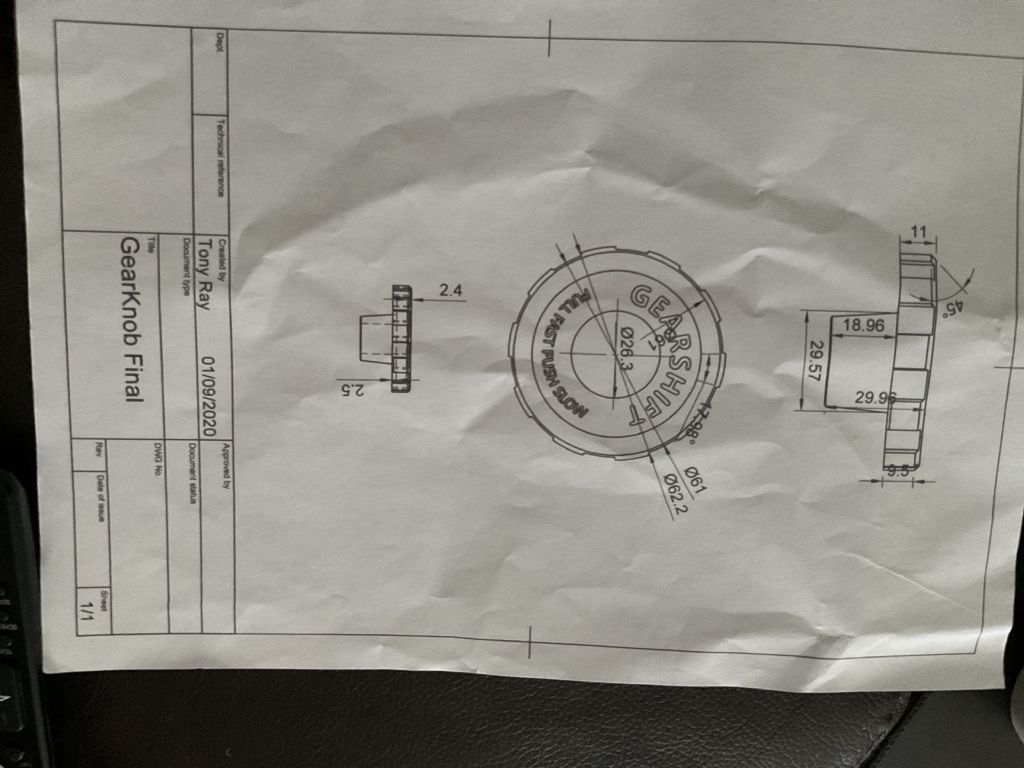

Tony Ray26/02/2021 16:48:12
238 forum posts
47 photos
Here is my drawing for the gearshift knob. My intention is to make it from acetal, my friend has a cnc router and the intention is tfor him to do the lettering . It will probably take a few trial runs to perfect, if all else fails I’ll leave it plain. If anyone would like a copy of the 3D model just let me know.image.jpg
