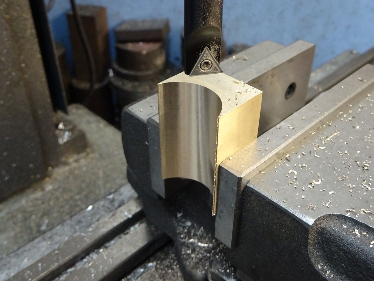

Although the size in this case would not suit the method there is no reason you could not bore a circular groovewink 2

Seems like you might be able to slide the ballnose end mill up into the collet until only 5mm or so is sticking out so less likely to snap off under side loading. Or to avoid risk of the cutting edges damaging a soft collet, turn up a sleeve to fit over the cutter, slit it lengthways with a mini hacksaw and fit the cutter plus sleeve into a larger diameter collet, again with just the nose protruding.
Or grind a radius on the end of a piece of square HSS steel lathe tool bit and swing it in the mill like a fly cutter, held in a piece of round bar like a lathe boring bar.
Or Google for "Shank Type Convex Milling Cutter" (sorry, not allowed to post a link or even mention a site name as previous posts have been deleted for doing so.) and find a cheapo cutter that is like a woodruff keyway cutter but with the radius on the ends of the teeth to cut a half-round groove.
