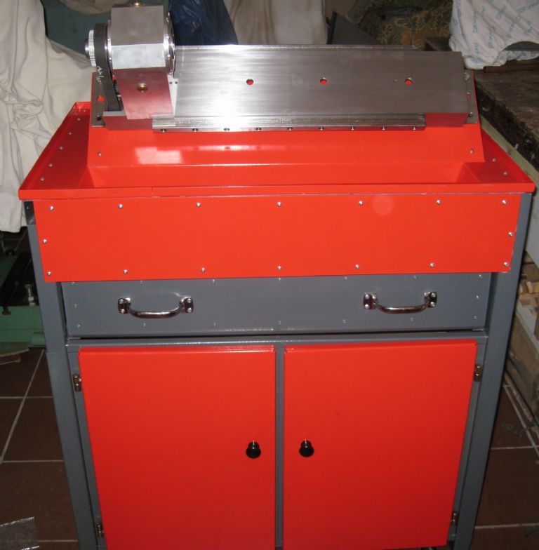

Joseph Noci 130/01/2021 13:34:50
1323 forum posts
1431 photos
Lathe Frame and cladding back from powder coating, and part assembled.
Front View:
Lathe bed and headstock fitted.
The Grey horizontal part with the two horizontal handles is the Swarf drawer / coolant drain . The Swarf would be persuaded to go down the forward and rear swarf slots, seen in photos below as does eventual full flood coolant. The drawer has a shaped base to lead coolant to a drain hole, back to the reservoir and pump.
Left side view shows the front swarf slot - about 150mm at the mouth.
The Rear swarf slot, 80mm at the mouth.
View under rear slant cover showing the Brushless 2KW motor - driven by step/direction pulses, with a 12000 step/rev resolution - will serve as the C axis as well eventually.
View of the rear wall, ( cladding to be fitted still) - shows the swarf drawer and its slope.
Lots to do still - On the cabinets - coolant drain, reservoir, pump, Electrical box and wiring, Upper cabinet sliding enclosure for splash guard,.
Then the lathe itself, at least it now sits on the cabinet, itself on sturdy casters, so I can get to all sides of the lathe and continue with the carriage and cross slide and associated ball screws, etc.
Have got together all the electronic modules (MESA Cards) and a suitable 64Bit mini-PC, with LinuxCNC installed, starting the great adventure with HAL, and the .ini files...Have got that all running and driving my CNC Router as a test bed - LinuxCNC is a whole new game!
Joe
Edited By Joseph Noci 1 on 30/01/2021 13:36:02
