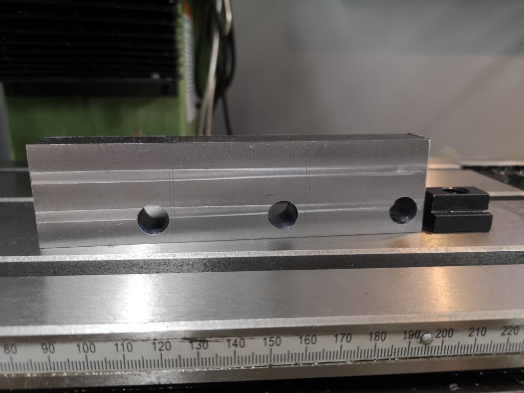

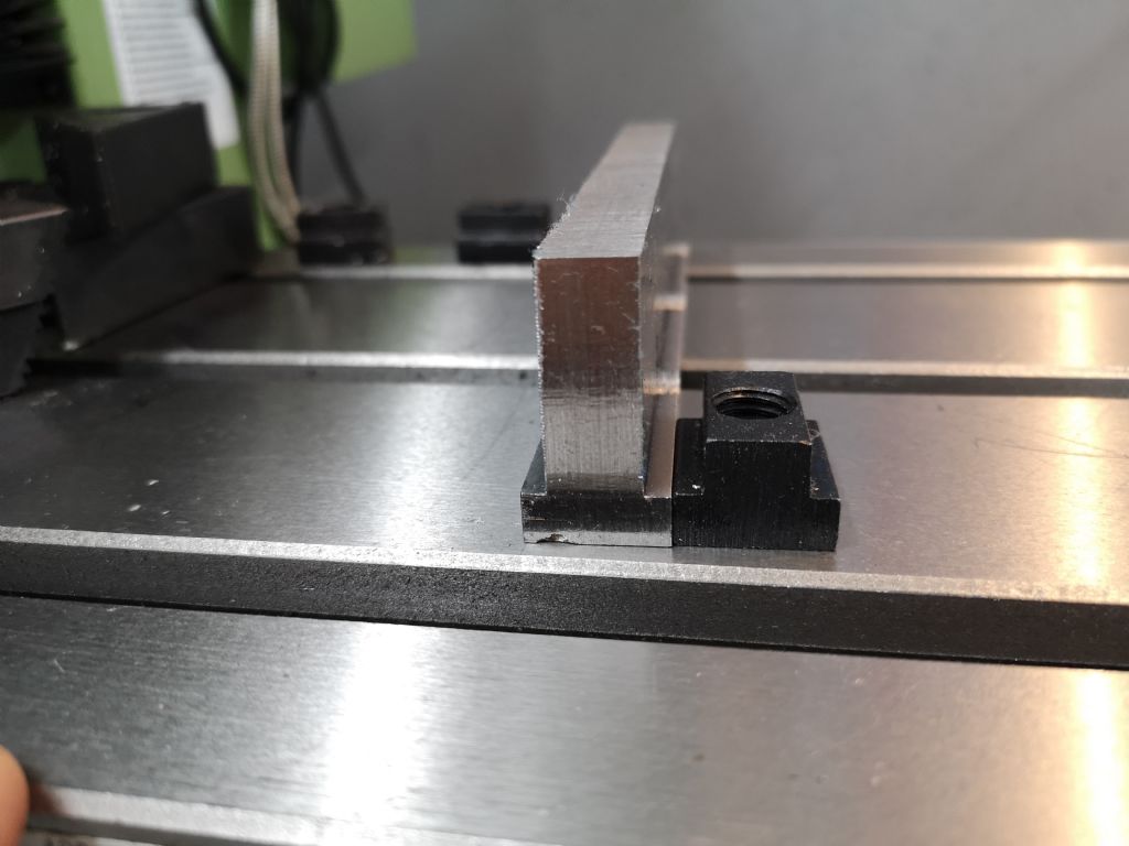

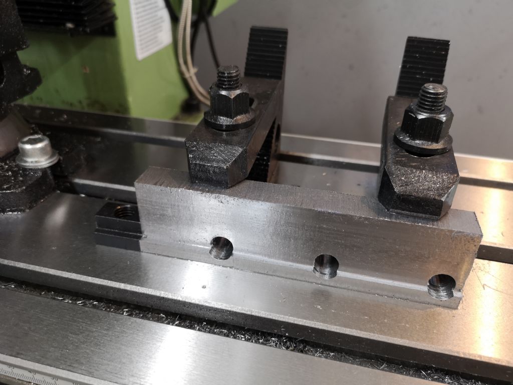

Lee Jones 627/05/2020 14:36:06
258 forum posts
125 photos
Thanks Martin. For the video and the link.
Lee Jones 627/05/2020 14:40:18
258 forum posts
125 photos

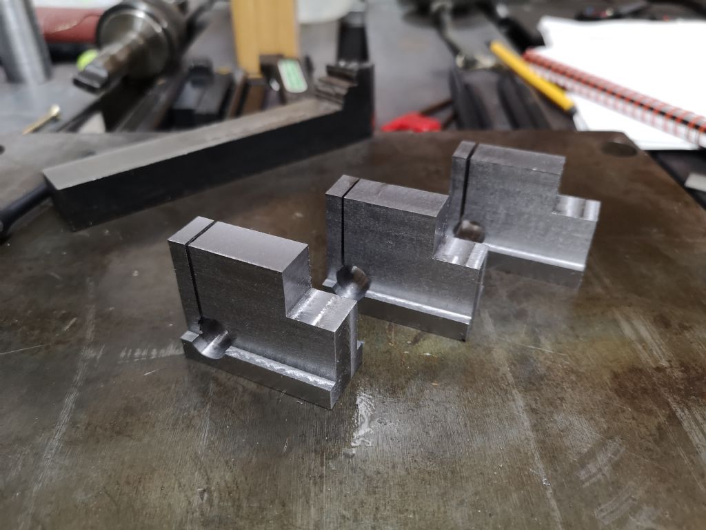

Sneaky nap-time session:
Lee Jones 627/05/2020 18:40:45
258 forum posts
125 photos

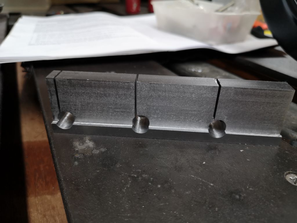

Other side milled:
Lee Jones 627/05/2020 18:41:11
258 forum posts
125 photos
Not sure how I'm going to do the vertical cuts yet.

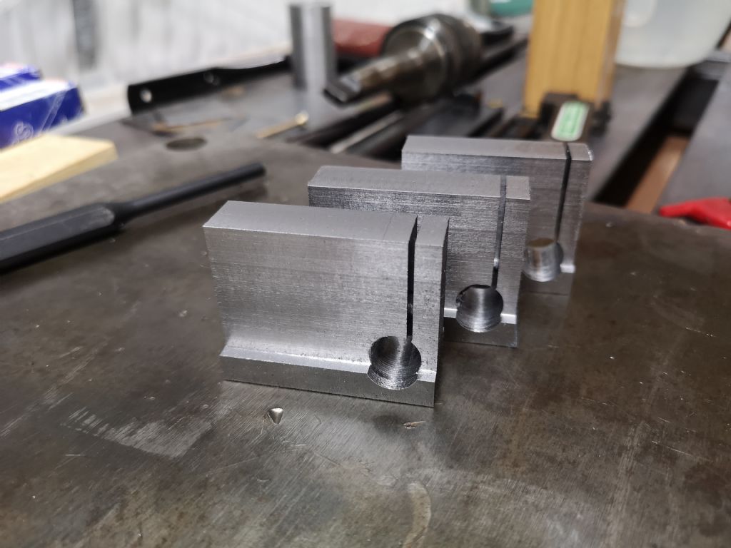

Lee Jones 627/05/2020 22:28:00
258 forum posts
125 photos
Finished for the day:
