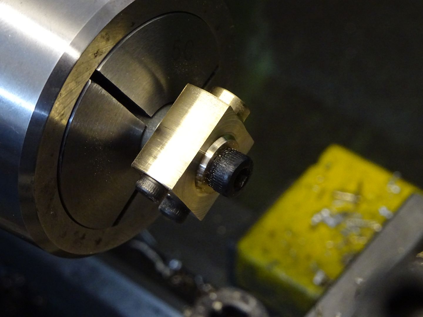

So today I re-made the spot facing tool, this time in Silver Steel from M-Machine, rather than Stainless (which I used by mistake last time). I've put all my known and marked steels in a box, the rest I've kept in reserve in 'deep storage' (the shed) just in case.
Made a jig (thanks for the ideas Ron and Jason) for the milling machine to make the tool more acurately than I could by eye:
Then hardened by getting cherry red and dunking in brine:
Made another spigot, brass this time, to keep everything concentric:
The test:
Perfect!
Thanks for the help, and bearing with me on the spot facing issue - got there in the end!
Also separated the main bearing stock and faced them off with my new ARC premium mill, which performed beautifully:
So a bit of progress I think. Cheers.

Still puzzling over how to retain the bearings on a mandrel and how to make a centering bar, so in the meantime I thought I'd finish the box bed. The mounting lugs are cast with dimples to drill to, but they didn't look central to me, and since thre are no dimensions given on the drawing I just got one with it the best I could.
I trued the casting up with a DTI along its long egde, and then milled 0.8mm off the top surfaces of the mounting lugs. I used 0.2mm cut depths. I did the side-to-side cuts by eye. A 12mm end mill covered the width of the lugs in one pass.
I wanted to get the mounting holes concentric with the end radii of the lugs, and since the cast radius doesn't cover 180 degrees, I opted to find a washer that was a good fit, and measure the diameter of that:
Then a fairly simple task of finding the middle of the casting, and using the edge finder to find the apex of the radius, then move to the centre using the DRO, centre & and drill to 3.5mm diameter:
Worked OK:
Pretty basic stuff, but one step further on.

For small beaings and such parts like this your arbor or mandrel can take many forms.
1. Most simple is to put a piece of bar into the chuck and turn to a good firm fit in your bearing and then slip the bearing on with a small amount of loctite or superglue, once machined heat will break the bond. The downsid eto this method with four ends to do is that you have to remove the mandrel each time to heat, it can be marked so it goes back in the same way but not ideal to remove it.
2. Similar to above but turn the spigot that fits into the hole about 2/3rds its length but put a very slight say 1 deg taper on the rest so the diameter increases towards the chuck. You can then slip the bearing onto the parallel part and then wring it onto the taper with a slight twisting action, if light cuts are used it will hold and the part can be wrung off again so mandrel stays put ensuring it's concentric.
3. Again turn a spigot to a good firm fit in the bearing and just shorter than it then drill and tap the end for a bolt or screw to retain the bearing, M5 with a cap head screw would work nicely on these bearings as screw head is just under the diameter you want to turn. Again mandrel does not need to come out of chuck. I'd go with this option.
4. Turn spigot to full length or a bot longer, drill and tap with a taper tap so you get a few full turns of thread. Mark the bit of bar you are using so it can be removed from chuck and then saw down the middle of the spigot before putting back in chuck. You can now slip the bearing onto the spigot and wind in a screw which will expand the spigot as it gets to the tapered part of the thread.
I tend to use aluminium for these sort of things and you soon build up a collection that can be used again and again, maybe skimming down to the next size or shortening.
