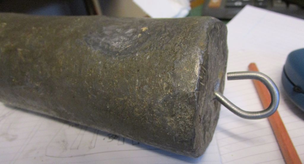

How about using a oxy -acetylene torch or (a propane torch, I have not not got one so don't know if you would be able to get a small enough pool of molten lead) and create a molten puddle in the centre top, and with a pair of pliers pull the nail out you could then insert your eye bolt into the molten puddle an allow to cool, or just allow to cool drill and tap as necessary.

Thanks Neil, I think lead would likely go all over the place with too hot a flame however with propane might do it. Removing the nail is the easier bit could even snip off flush, punch down and loose with lead but the issue is what will stick with lead. if epoxy will do it then 2 holes and barbed steel bent into a loop will give a far better look.

Chris, you could possibly use a screw-eye, not tried this but cant see why not.
Lead is so soft just drill a small hole to depth and screw in. you could use thread-locker but probably not necessary.

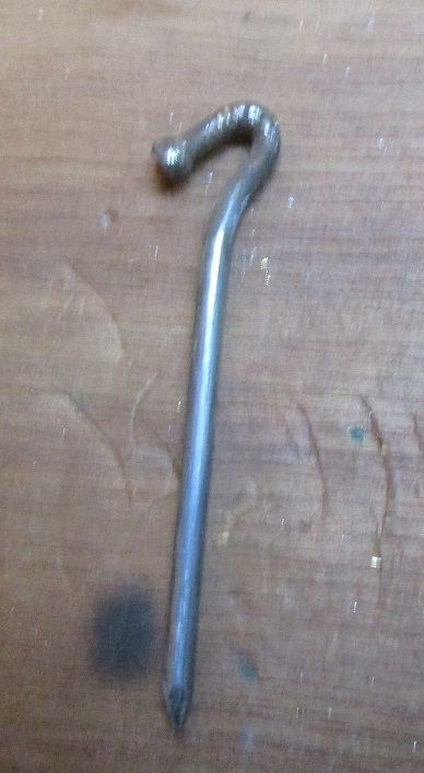

Likely to be much safer than the previous repair yes
... which looks like a rather ordinary wire nail
[Chris] If you do pull the nail; please let us know how short the engagement was.

If it were me looking for a sympathetic repair, Bazlye's suggestion (post 3), is surely the best. Not necessary to make a hole saw, they can be bought rather cheaply, like this Makita set on Amazon.
Drilling a cored hole leaves the exterior of the weight in authentic aged condition. It doesn't matter how much damage is done removing the core, perhaps with a chisel, because it will be refilled with lead (most of it original!). The eye can be re-fixed in the original way too, by thrusting the end deep into the molten lead so it's firmly gripped when the lead solidifies. Not difficult to melt lead with a DIY store blow-lamp and a small steel pan.

hookreplaced.jpgnailfrom weight.jpgOK I decided to do something about the nail as it looked awful and possibly dangerous. This is not a top class clock by any means but there are limits. note nail pulled out easily, there was nothing left sheered in the centre so i got lucky. I drilled a 10mm hole to put a nut on so hope is at least safer.
