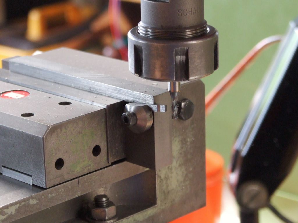

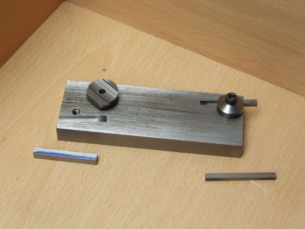

The jig above is for 1/8" and 3/16" square Silver Steel, (if you can get hold of it), or Gauge Plate, better known as Ground Flat Stock these days.
The centre line of each blank is 12 mm from the fixed Jaw face of my Machine vice. As I always work with this face set to Zero I know exactly where each cutter is in relation to my index.

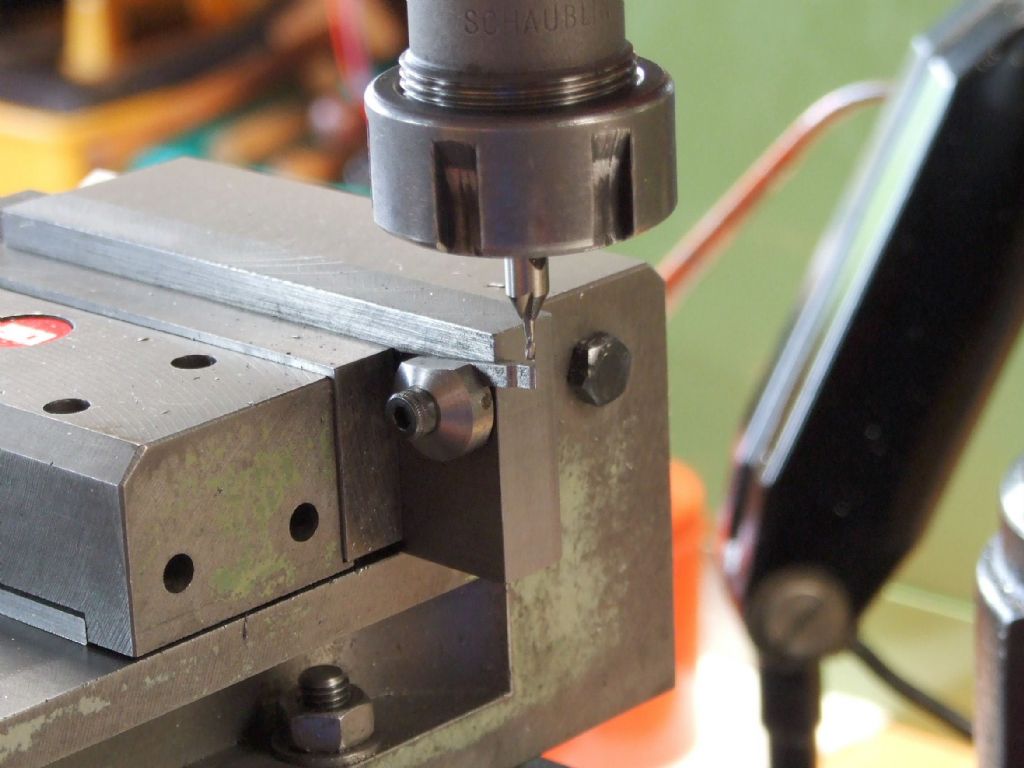

This is a sequence of photographs showing how I go about making a gear cutter. IN this case this is a special for a Centring Device I made some years ago. I think the Gear was 0.4 MOD. The cutters in the jig are inclined at an angle of 10 degrees to the Horizontal.

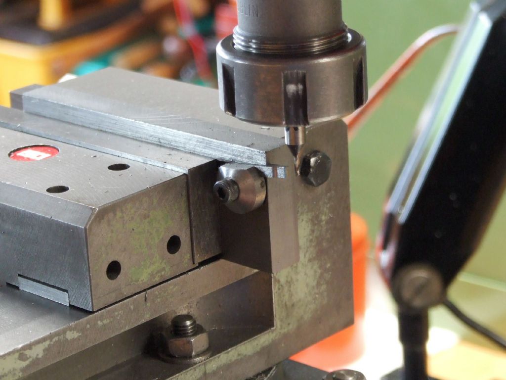

fig 10c taking a light skim across the end face with 0.0625 diameter cutter.jpg

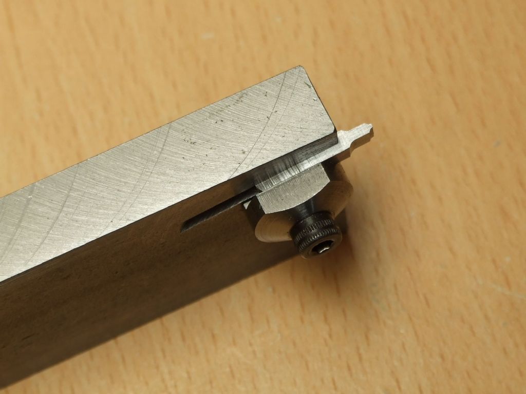

These last three images show how the gear form is created using in this instance a 1/16" Slot Drill. Most of my cutters are made double ended, that way should I have a calamity I can quickly change the cutter end for end.
I have a photograph somewhere of how I hold the cutters in the mill.
