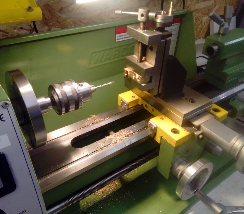

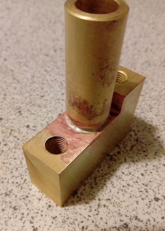

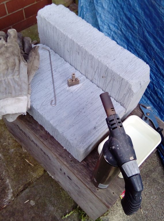

I'm a fairly new member and I've only had my WM180 lathe for the twelve months now so somewhat inexperienced although I did go through the engineering training school nearly 50 years ago. I am following this series with interest and noted that someone commented on the assumption that a mill was needed. As I don't have a mill yet I did the pump body machining on my WM180 with a jacobs chuck (!) and vertical slide fitted as in the picture. Taking fairly small 1mm cuts didn't really have any problems. Coming to the brazing, not having a large brazing torch, i used my plumbing torch on the body and achieved a satisfactory result as far as I can see (first time I've brazed anything). Thought this might be of interest and I'm looking forward to the rest of the series. I imagine I might need a bigger torch for the boiler itself.
