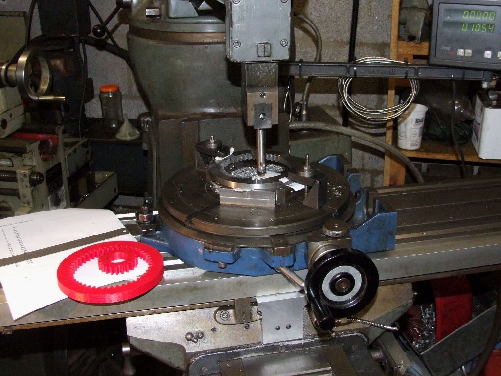

Rotary table - Not used that much, especially as the DRO has a bolt circle function, but has it's uses:
My rotary table has a 1" parallel central hole, which I reckon is a darn sight more useful than a Morse taper, as it is easy to make up mandrels for locating the work.
