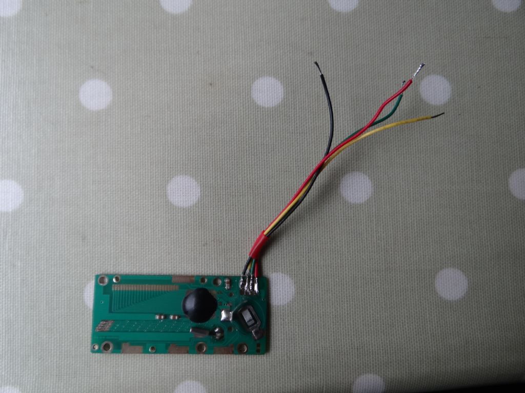

Lack of progress report!
Good news, my old Powerfix Caliper came apart easily after exposing the screws behind the sticky label on the back.
Even better, a signal appeared on the 4 pin interface after I cleaned out the swarf so I shakily soldered on some wires. (I was surprised how much muck was inside the case.)
Reassembled I detected this output on the clock and data pins. The yellow trace is the clock, and the blue is the data. As expected I found the caliper never switches off. The ON/OFF button disables the display but everything else carries on working.
After this promising start the project's gone pear-shaped. The NPN transistor level shifter quickly drains the caliper's battery. I've been unable to decode the data with any of the Arduino sketches available on the web. I can't see any difference between positive and negative numbers on the oscilloscope trace. This might indicate this caliper has an unusual variation on the usual protocol. Or that I'm a bit thick.
Perhaps a mug of strong coffee and an hour on the lathe will sort me out. Electronics and computers have lost their appeal.

Hi Bob and Les,
I can confirm that this caliper is using BCD. This screenshot is of 4.56mm and you can see the first three nibbles are 6, 5 and 4. Hurrah!
At the moment I'm using a slightly modified version of Bob's sketch. The main differences are: I've commented out the I2C LCD stuff and am using the Serial Monitor instead; I've also inverted the start logic in ReadX()
The start logic change is because my caliper appears to be upside down. After making the change I started receiving numbers and was able to confirm that the delay between each transmission is correctly detected by the Arduino.
Trouble is that the decoded numbers jump about and don't have any relationship to the input. I'd be much happier if the output numbers were stable even if wrong. As it is, looks like the Arduino and/or Sketch aren't detecting bits properly.
It may be noise on the caliper's "power supply". I'm running a LED off the 3.3V line and tapping 1.5V off that smoothed with 6.8uF. I don't think the erratic numbers are due to logic inversion or Bob's code, but might be. My main suspect at the moment is the level shifter: the clock signals in particular are suspiciously round-shouldered!
Many thanks for the advice. I have a way to go yet!
