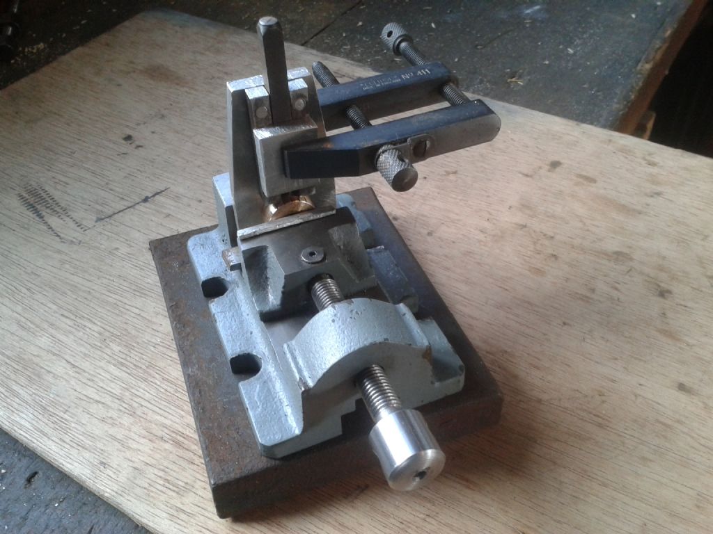

20141005_152457.jpgThis worked well for me Claus.
It's only a small dial but all that was necessary was positioning the engraved line in the middle of the two guides.
You also need soft jaws and a soft base in the vice to protect the dial.

Posted by geoff walker 1 on 04/02/2017 17:12:05:
Nice one Geoff. Elegant in its simplicity and use of existing kit.
