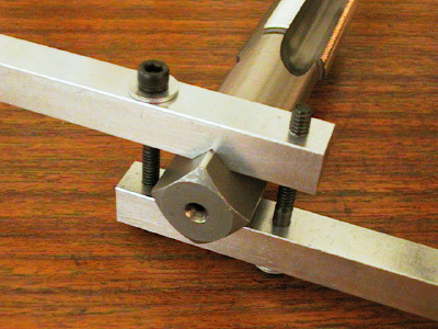

That should be handy to correct any distortion you may get after welding, as for a wrench a couple of 6ft lengths of 40mm bar should do the job, just make sure your vice and bench are fixed down wellblush

Perhaps hold the square end of tap in the vice with packing and spanner the nut.

Posted by Andrew Johnston on 07/08/2016 20:46:01:
Just need a suitable tap wrench now ...
What size A/F is the square, Andrew ?

Hi Andrew, do you have a stock for your 3" diameter die's?
**LINK**
If you do, you could cut a square hole in a steel blank and maybe use that.

Posted by Michael Gilligan on 07/08/2016 21:30:08:
The answer is 1.23" AF, approximately.
Nick: I don't have a suitable diestock, but then again I haven't needed to use the linked dies yet! For this particular project the UNC bolts already exist. If I was going to make external threads I'd screwcut them on the lathe rather than use a die. I'm not sure how you'd even start a die with a that that coarse?

Posted by Andrew Johnston on 08/08/2016 11:40:08:
Give me a few minutes ... Just off to check something in my 'hoard'.
UPDATE: I have a suitable tap wrench ... Will send a PM forthwith.
