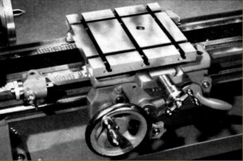

The cross slide T slots are much more rigid than the ones on the boring table Ian. That is really intended for lathes that lack the ones on the slide. It locates in place of the compound slide using the same location method. John - I beg to differ the table replaces the cross slide rather locating in the same place as the compound slide see **LINK** Bob
Ian Rees 1 | 01/01/2016 20:14:21 | ||||||||||||||||||||||||||||||||||||||||||||||||||||||||||||||||||
36 forum posts | That vertical slide has "Myford" stamped in it John, from what I've heard, the Boxford ones are rare. I've seen some pretty nifty modern ones on ebay that interest me, either that or maybe I'll rig something up myself with an angle plate and an old top slide or something.
Bob, have you looked at the dimensions for that boring table? 8"x8" seems a bit small for mounting on the cross slide but you could be right. I'm not really prepared to spend that much on a guess though, especially for something I might never use. Edited By Ian Rees 1 on 01/01/2016 20:16:29 | ||||||||||||||||||||||||||||||||||||||||||||||||||||||||||||||||||
Bob Brown 1 | 01/01/2016 20:21:43 | ||||||||||||||||||||||||||||||||||||||||||||||||||||||||||||||||||
![]() 1022 forum posts 127 photos | It should sit on the saddle like this May be the 8" is an error. I have done milling work on my AUD with the compound slide removed and work piece spaced and clamped to the cross slide. Bob | ||||||||||||||||||||||||||||||||||||||||||||||||||||||||||||||||||
