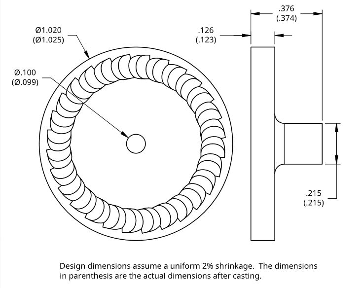

Turbine Guy04/06/2021 16:39:14
541 forum posts
578 photos
I received the casting of Drag Rotor 5 described in the 16/05/2021 post from Shapeways. The following photo shows the face of the rotor. I hope you can see from the photo that Shapeways was able to make the open pockets very close to what was in the step file I sent them. The edges are sharp and the surfaces pretty smooth. To use the overlapping pockets in a drag turbine, I need to force the gas in the direction it flows down the channel. The overlapping of the pockets results in the center of the pocket having a clearance from the face of the rotor. This clearance will increase the leakage unless the gas has to reverse its direction to move toward the exhaust port. I will show in the next post the cover plate I designed to force the flow to move in the right direction. This is something I think will increase the performance with the other drag rotors.
Drag Rotor 5 Cast 1

Turbine Guy07/06/2021 19:42:34
541 forum posts
578 photos
I measured the actual dimensions of Drag Rotor 5 Cast and added them in parenthesis to the following drawing of the design dimensions assuming 2% shrinkage. The assumed shrinkage appears to be about right for this size and shape. I finished the machining of Drag Rotor 5 and show a photo and a drawing showing the finished dimensions in the next post.
Drag Rotor 5 Cast 2
