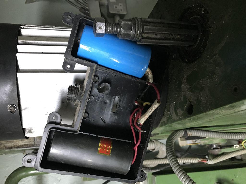

31/01/2021 13:39:15
d95d99c4-0fed-42d6-ad95-ce7c9c4a52fc.jpeg98415712-5f9b-45e7-b2b5-e12d832cfc3c.jpegAfter a bit of playing around. The z and x axis motors work ok. So the fault lays in the main head motor. Which I can’t get off for some reason. Does anyone know if these just pull out from the top, or do I need to remove the top of the head which I don’t truly wish to do as it holds a bearing. This is a picture of the machine, I have know idea what the black and blue units are.d95d99c4-0fed-42d6-ad95-ce7c9c4a52fc.jpeg
31/01/2021 11:53:16
Hi chaps, so today my warco stopped working when I switched the milling head on. I have contacted warco with know reply as yet to ask them what I need to look for to find the fault. Now this is an older mill around 1985, and as given good service. So does anyone out there know if it’s possible to replace the motor with something a bit better which will do away with the Chinese electrical system. I was also thinking of making the mill able to run cnc so any help in both areas would be great. Thanks Michael

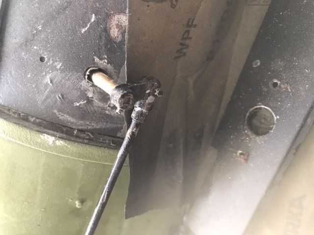

04/04/2020 11:31:46
Thanks chaps, here is a picture of the centre linkage. I think that using bolts is a bad idea as there is far to much play if you add up all the kinks. The movement of the regulator main body is less then a 1/4 turn at best. I think nick your case hardened fork with close fitting pins maybe the answer. Do you think using silver steel for the pins would be ok. 648a21e5-221c-403d-8a5a-f389b4cc015c.jpeg

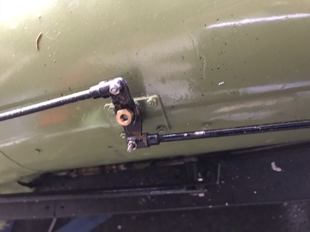

03/04/2020 17:55:35
Hi chaps.i am trying to sort out a Martin Evans design Columbia. The regulator control runs along the outside of the wrapping and is made up of two rods and three fork connectors. My problem is with having too much slopp in the movement. The rods are on two levels and as a link arm in the middle. Due to lack of space in the position the rods are in the fork connectors are quite small, with only a 2mm hole for a fixing pin. I have tried just fitting a nut and bolt, but the play is too much. What would be a better way to lock the fork connectors, . Thanks.
