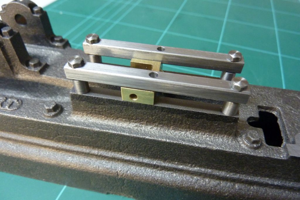

Drilled and tapped the base casting of the S50 for the slidebars. Only a simple job to most of you but it took me all afternoon, most of which was lining it up on the mill.
Gary
