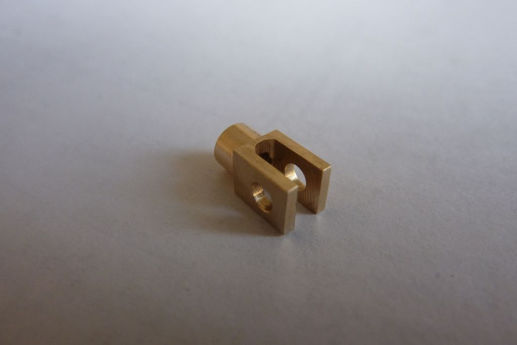

Well here is the result. It fits and seems to do the job, but it's not pretty. In the end I adapted Jeff's idea and drilled a piece of 3/16 bar with 7BA clearance so I could use a 7BA screw to hold it, which made working with it much easier. Slot still ended up rounded even with a flat needle file. If I decide to make another I'll try slitting it before the turning operations and while still on the stock. Might be a good learning exercise anyway as it's only a small part. I didn't fancy soldering or gluing as I thought it might take me longer to get it clean afterwards.
John S - I thought I knew the Arc catalogue inside out but hadn't spotted these small clamps. Worth having some at the price (that should get you your £2 back).
Again thanks for all the suggestions, even though I didn't use some of them they are stored away for the future.
Gary

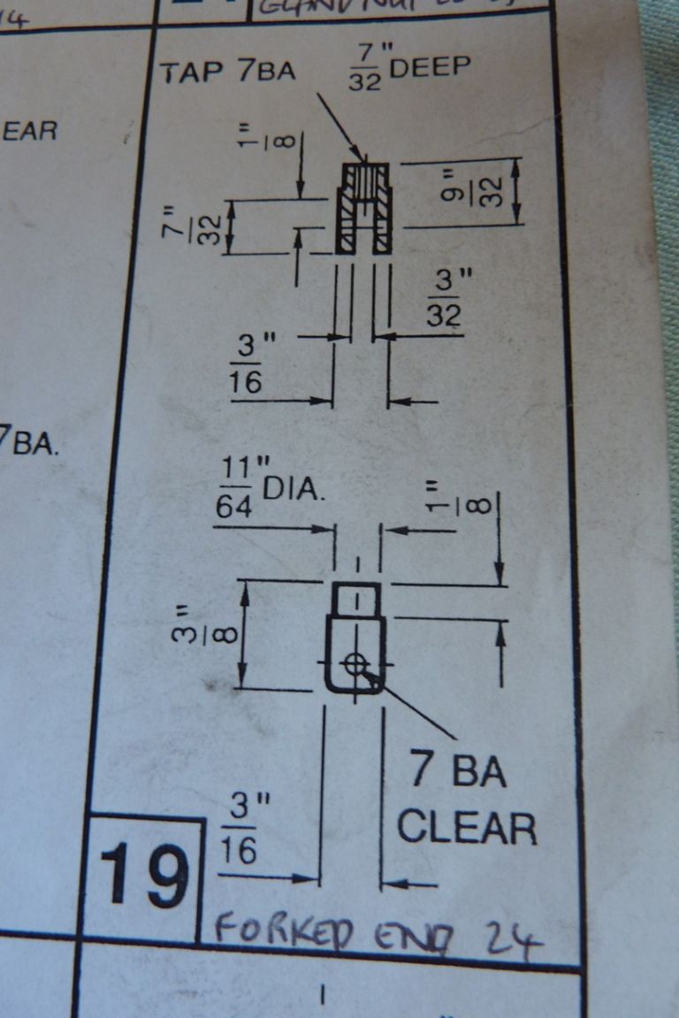

Thanks for the suggestions chaps. For this project I have been following a Tubal Cain article published in ME Aug 92 to May 93. His instructions were for someone who only had a lathe and for this part he suggested mounting on a vertical slide and using a 3/32 slot drill. With hindsight, it may have been easier to mill the slot first then part off last. I could have then tapped the hole afterwards. As Jason says you don't get much to play with in Stuart kits (about 5/8" in this case) but obviously that doesn't stop me using another bit of brass bar. Jeff's mandrel idea sounds appealing if the vice won't hold it well enough. I've got some 7BA screws so I could just fasten it to a short piece of 3/16" bar as suggested which would give extra support.
Bazyle, my problem would then be finding it again in my brain. wink
As I said above I'll try holding it in the bench vice first and sawing and filing it but thanks for the ideas. I'll let you know how I get on.
Gary
01/02/2014 11:23:40
Hi,
The photo below is a part-made forked end for the S50 I'm building. I need to cut the slot for the eccentric rod in the square end. I'll probably hold it in the bench vice and use hacksaw and file but I was wondering how you would do it. I thought about holding the round end in a collet block and using a slitting saw but thought the clamping might not be good enough. Any suggestions welcomed.
Gary
