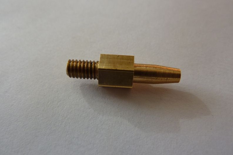

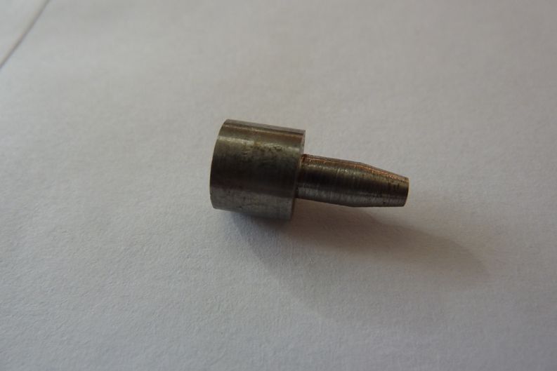

03/03/2014 10:33:43
Hi Allan,
By 'cable' I assume you mean the hose attached to the pump. I used a length of flexible clear plastic tubing from B+Q, about 6mm O/D. I made a little adaptor to attach to the engine, threaded one end and with a short taper on the other to go in the tubing. At the pump end I just turned a small piece of steel (anything will do) to fit the tubing on one side and at the other end the same size as a car tyre valve so the clamp on the end of the hose would fit it. This was for the oscillator in my avatar (picture next to my name). As you might have read in the 'what did you do today' thread the S50 is not quite ready yet. sad
I'll take some pics later today.
Video of the little oscillator running from foot pump is here **LINK**
Ignore the mounting board, that was just to keep it still.
Gary

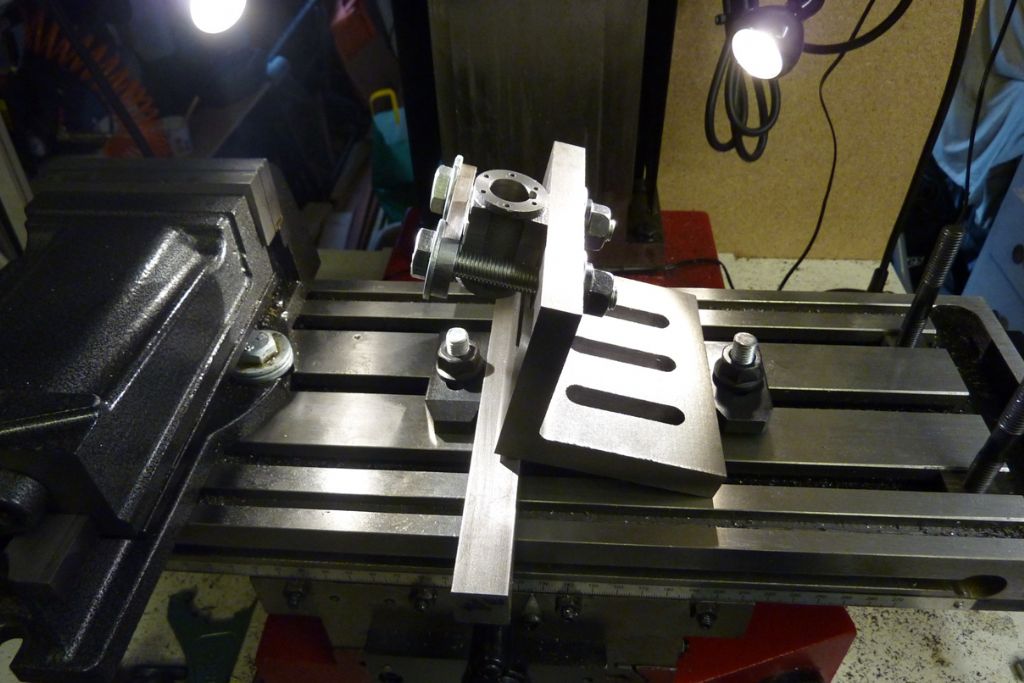

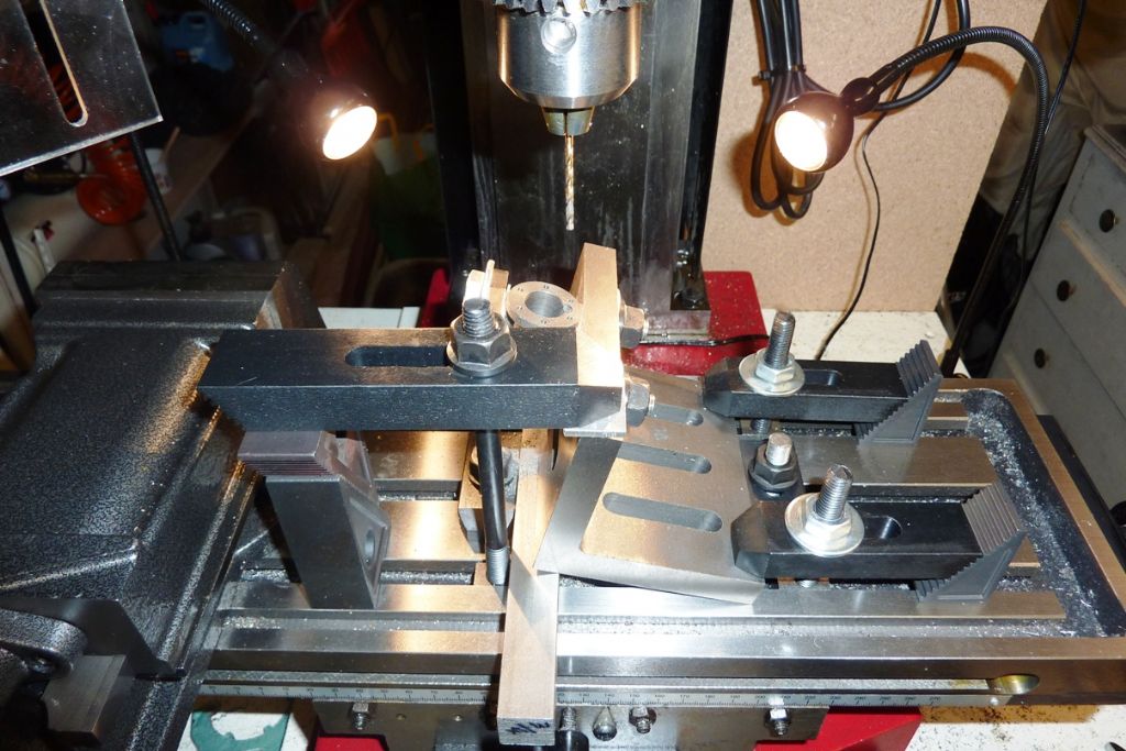

17/02/2014 21:40:45
I came up with a ridiculously (to me) complicated arrangement to drill the steam passage on the S50 cylinder at an angle. According to Tubal Cain's article, that I'm following, the angle is about 14 degrees. So, not having an angle vice, I clamped the cylinder on an angle plate and rested this on a piece of 3/4" square bar that was clamped 3" from where the angle plate touched the table giving an angle of 14 degrees. Was quite pleased with the result although I haven't taken a pic of it.
Before the final clamps were fitted.

Final arrangement of clamps
Gary
