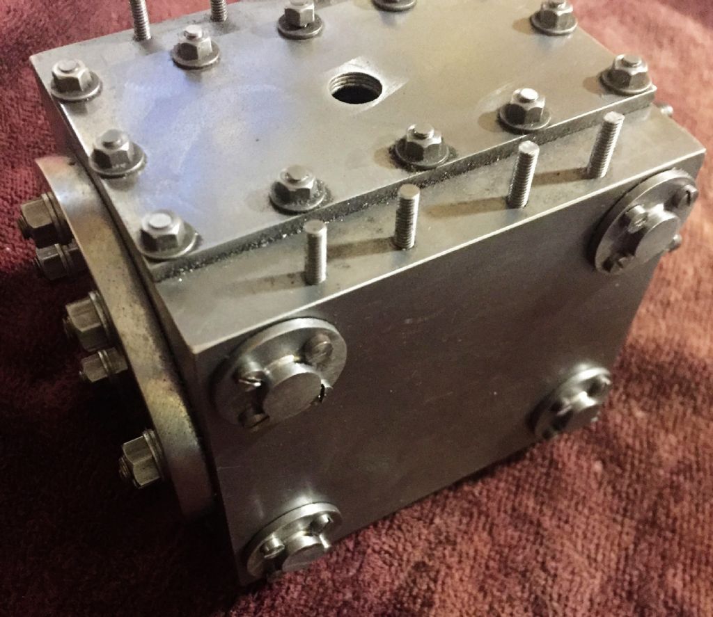

Over the Christmas period using the MEM designed plans I have completely re-drawn the Corliss engine and scaled it up by x 1.5. There have been a lot of small changes to the original plans but the geometry is pretty much the same. So I thought I would share a few photos of the build so far - its a very heavy thing! For some idea of size the cross centre of the crank arm is 1.125" A big shout out to JB for his kind help.
