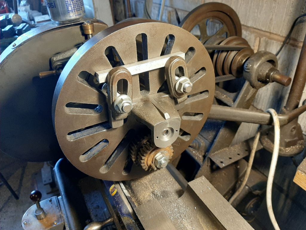

20200522_120155.jpgToday I completed a long overdue upgrade on the m type20200522_104459.jpg
A new bronze cross slide nut fitted, supplied by David George, thanks again David.
The nut has been made very accurately and the feedscrew is a near perfect fit with just a tiny amount of backlash
Also took the opportunity to add mini thrust bearings front and rear of the bridge plate, similar to the ml7 improvement.
The whole job makes for an amazing improvement, feels like I have a new lathe
20200522_120727.jpggeoff
