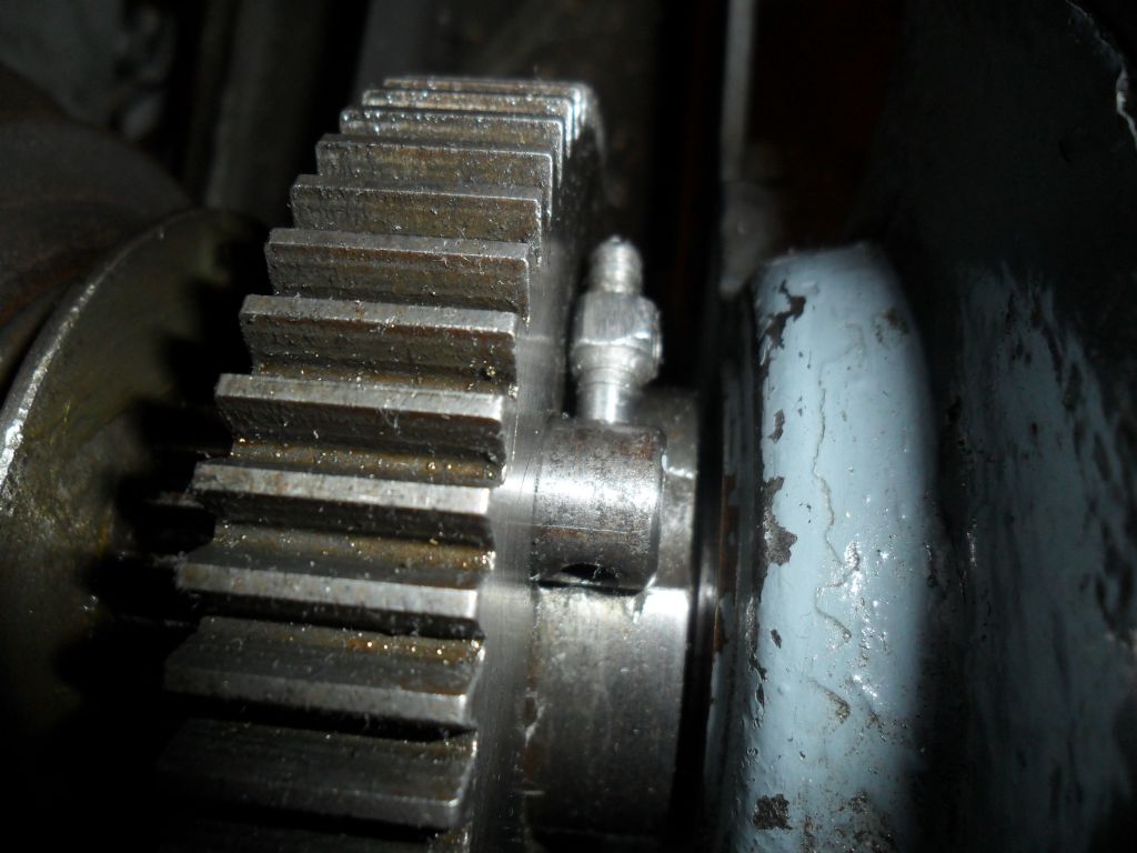

Thread: Clicking from Super 7 headstock.
26/06/2014 12:46:49
Hi
I had the same problem . I made a lever with a small grub screw to lock against the gear
Nobby
