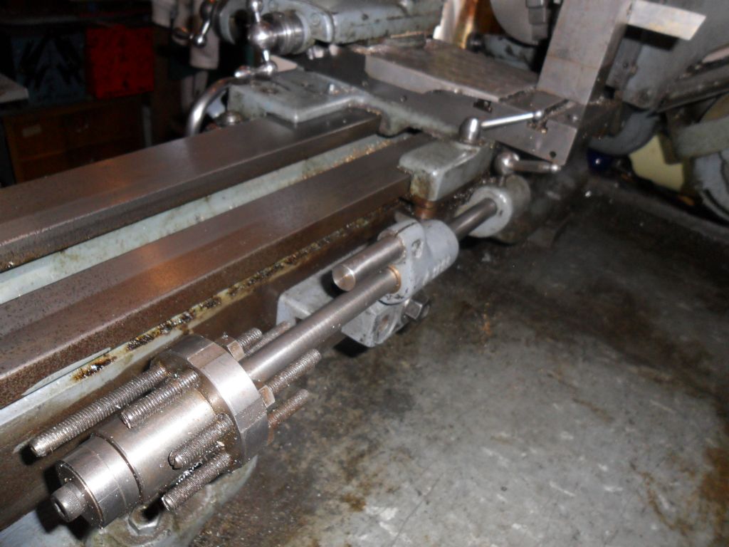

Hi Matthew
Here is a photo the part you are missing you can just see it in this photo . I can post details measurement later. Regards Nobby
6  position  stop

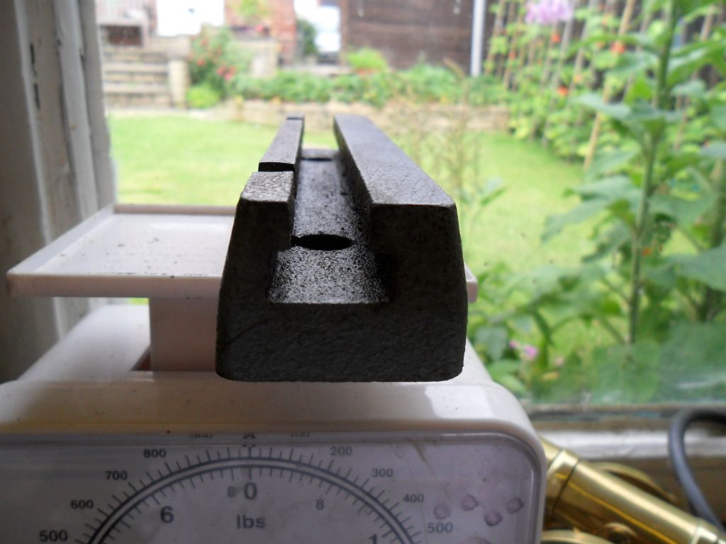

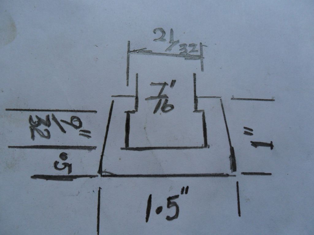

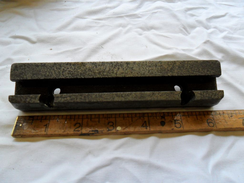

sam_3034.jpgsam_3037.jpghere we go Matthew Overall Length 6&5/16" hole ctrs. 3&15/16" hole to suit 1/4" whit Mtrl. Cast ironsam_3036.jpg

Thanks guys, that's brilliant Nobby, I really appreciate you doing that, I even know what it weighs to!
Once I have sorted a bit more of his stuff I will get on with making one, I didn't realise the T slot was not in the centre, but from this I will have no problem.

I can put it back on the machine now . I will have to brush up on my drawing.

your skills cant be that bad I managed to work it out, and thanks I hope its not to much trouble putting it all back together
