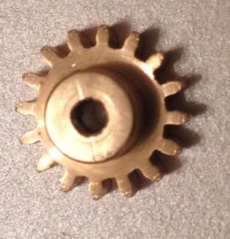

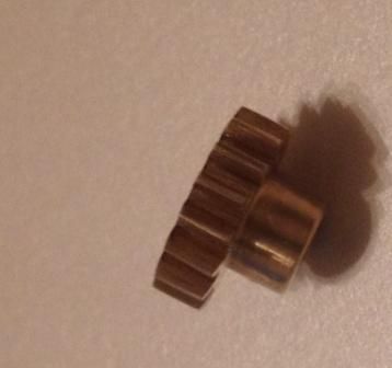

24/09/2012 21:31:11
Posted by Stub Mandrel on 24/09/2012 20:44:07:
If its as small as the grain in the paper suggests, very good, although the teeth may be a little thin.
It is quite small 10mm total depth shank is 8mm and the gear is a fraction over 17mm, I didn't have the correct gear cutter at the timeso i had to improvise!(slitting saw and various files) It's only for the steering on a large scale vintage boat. I tried running it with the damaged gear whilst it was in the lathe it all seems ok and at reasonably high speed. I think this will be 360 degree turn and back at most so can't see a problem. I've now picked up more gear cutters so will make another, but I was just wondering what people thought as it was my first attempted at gear cutting
Regards Mexican Jon
24/09/2012 19:18:05
A gear I made by machine and hand profiling, not the best pictures. But what do ya think.
Edited By David Clark 1 on 25/09/2012 09:50:12
