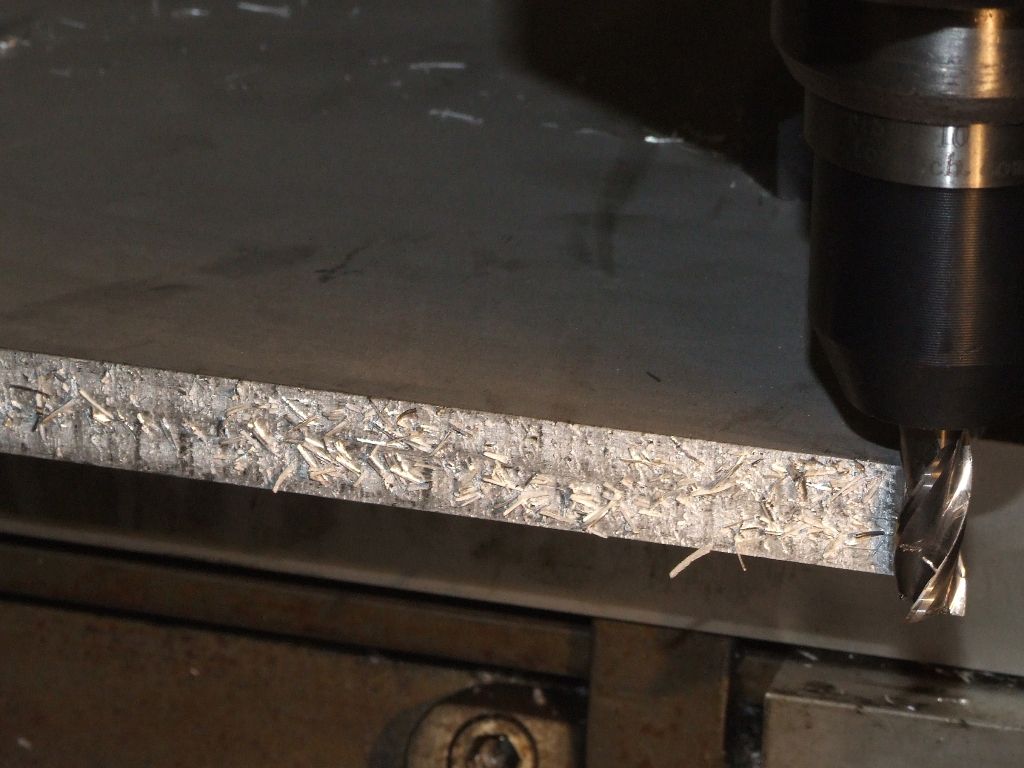

A few pictures for interest, milling the edge of tooling plate, 25mm thick, with a (worn) 10mm carbide endmill. First, conventional milling and cutting dry:

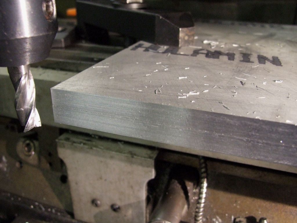

Climb milling, cutting dry:

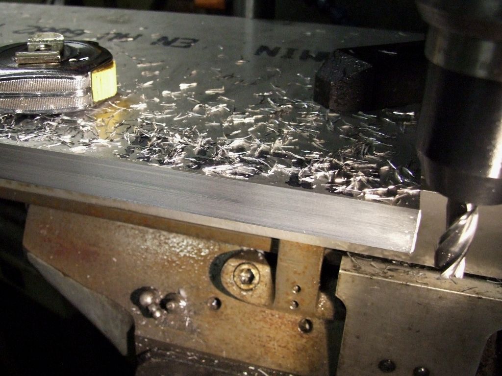

And conventional milling with a squirt of WD40:
