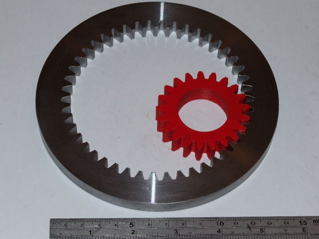

The calculation for the OD is correct. The addendum is one over the diametrical pitch, so 0.1". In theory the dedendum is the same, but clearance is normally added. Common values are 1.157 or 1.25 divided by the diametrical pitch. Total tooth depth is addendum plus dedendum, so 2.157 or 2.25 divided by the diametrical pitch. The larger tooth depth is used for smaller tooth counts, but there is no hard and fast rule as to the changeover point. The tooth depth will be 0.2157" or 0.225" depending on the clearance allowance. If the cutter is old stock it should have the tooth depth for which it was made marked on it. If in doubt I'd start with a tooth depth of 0.2157"; you can always do another pass. But it's more difficult to add material. For scale these are 10DP gears:
