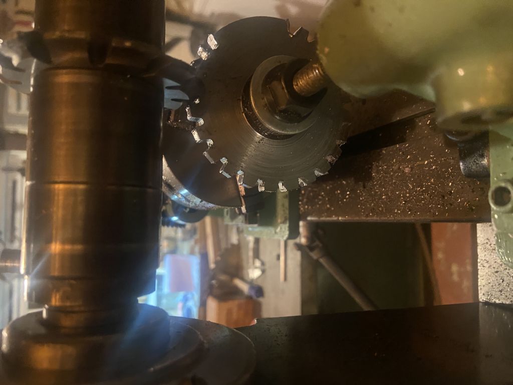

Steve35513/04/2022 19:47:13
321 forum posts
235 photos
Well, I’m not currently having much success.
The cutter is c. 2” with 13 teeth I think. Spindle speed is 250rpm, which I think is about right for mild steel @ 120 sfm. My calculator says the feed rate should be around 10 IPM.
But it’s not really making chips, more rubbing.
What would be a suitable depth of cut?
Andrew Johnston13/04/2022 20:30:55
avatar
7061 forum posts
719 photos
Spindle speed of 250rpm is on the fast side, I'd be aiming for around 60 sfm. As setup 10 ipm gives a chipload of 3 thou per tooth, which is reasonable. Depth of cut is the full depth of the tooth; cut in one pass. Multiple passes just waste time and blunt the cutter.
Andrew

Steve35513/04/2022 21:04:10
321 forum posts
235 photos
No Jason, even I know which way the cutter should run
Unfortunately that’s the slowest it will go Andrew, I thought about changing the motor for a VFD a while back, but couldn’t justify the cost really. Originally the mill had a geared motor, but that’s long gone. Whoever replaced it replaced it with a motor that runs too fast.
But …. Success… I was about to give up for the night, but thought I’d try another cutter that I have. I didn’t bother recalculating the tooth spacing, I had already failed with that blank. It went through it not quite like butter, but quite easily. So it seems simply that the first cutter was blunt. Is it possible to sharpen them? Can’t imagine it’s easy.
looks a bit like a gear…smiley
Thanks for the advice all.
Andrew Johnston13/04/2022 21:19:56
avatar
7061 forum posts
719 photos
I assume the depth of cut isn't full tooth depth yet?
Involute gear cutters are designed such that grinding the front face of each tooth on a radius reduces the OD of the cutter but preserves the correct tooth form. To do so an indexing method would be needed. If the cutter isn't too blunt try giving each tooth face a lick with a diamond hone.
Andrew
Steve35513/04/2022 21:38:02
321 forum posts
235 photos
No, the depth of cut in the pic is full depth. The reason it looks wrong is that it’s a different cutter, with a smaller tooth size, but I continued with the 13.7x  degrees I was using on the dividing head. Obviously it’ll never work as a gear, but I was just learning how to do it today. I will cut a new blank tomorrow, recalculates for this second cutter and try to cut a better gear.
I’ll get a diamond hone also.
it looks like there’s quite a lot of deburring to do. Is there a trick to that?
Edited By Steve355 on 13/04/2022 21:38:28
Andrew Johnston13/04/2022 21:51:32
avatar
7061 forum posts
719 photos
Posted by Steve355 on 13/04/2022 21:38:02:
...quite a lot of deburring to do. Is there a trick to that?
Just tedium with a round needle file. sad
If there is a sacrificial blank on the exit side of the real blank the burrs where the cutter breaks through can be almost eliminated.
Andrew
