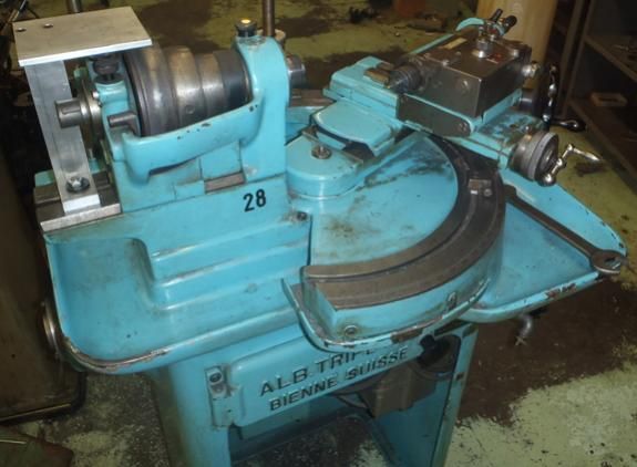

Why is it that all the drill grinding jigs I see have the drill pointing up? This seems to need a fairly high grinder and a tall jig. Why cant the jigs be mounted horizontally and use the bottom of the wheel?
Only asking as I am thinking of turning a tripet grinder like the one below into a tool and drill grinder and I have never used a drill grinding jig before.
