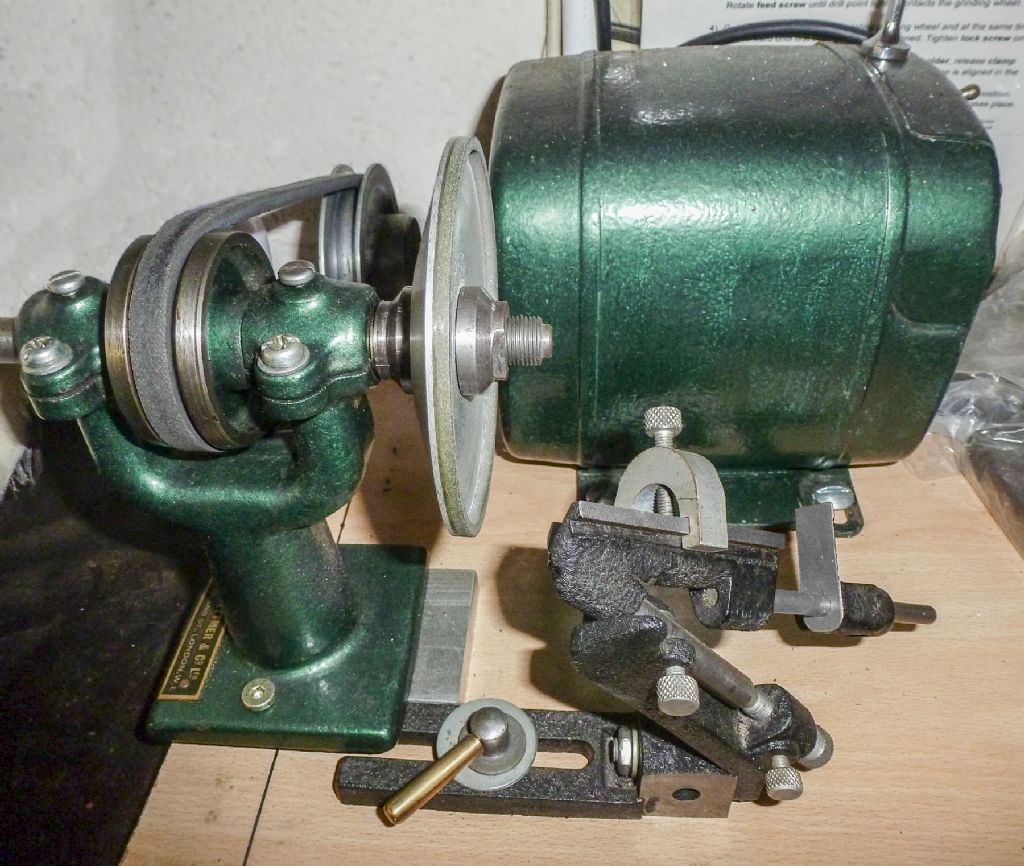

Thread: Reliance drill grinding attachment.
08/08/2018 00:09:59
"It doesn't have the triangular shaped stop."
Not querying that and sorry for any confusion. It was just that your picture at first sight appeared to show the same type of end-stop as mine but closer examination then revealed the differences - hence the edit.
Would it be worth drilling your end-stop for a silver steel rod, secured by a screw somehow? I''ve considered doing that on mine when sharpening the ends of short centre drills, thus avoiding an imprecise loose "spacer" in the jig.
07/08/2018 22:46:03
Re: your 2 queries about the Reliance.
(1) You shouldn't need any spacer for shorter drills. Take off the end stop and replace it so the triangular part now points forward, to lay along the groove as below:-
(2) Looking at the images of your 2 drills, it doesn't appear there's enough back-off from the cutting edges. As there's no adjustment on the jig for the angle ~ are following the Reliance instructions for overhang vs. diameter? Also you must pull the drill carrier back against the stop i.e. towards you with the lip aligned vertically as described. Then advance the whole jig up to the wheel so it's just touching. Release the little knurled screw and push back the drill carrier to traverse the wheel. Then of course advance the "cut" with the bottom screw after slackening the others before retightening.
In the above image, there's a new Dormer 10mm drill against the wheel. You might just about be able to see the angle is correct.
Edit: I ought to have paid more attention to your post and images. I now see you have a smaller Reliance jig and therefore the comments above may not be applicable. IF you ever spot a larger size Reliance for sale,
07/08/2018 11:51:04
Re: Clive Foster's posting, whilst not professing much (if any) knowledge of the finer points of drill geometry, I fully endorse all his comments about "perfectly flat and perfectly aligned at 90° to the......etc".
For me, recognising such came from early failures to grind drills accurately with the Reliance jig.
As recommended to "fishy-steve", a means to keep alignment of the Reliance at 90° to the wheel is essential.
In the image below, I raised the diamond wheel so that drill points were close as possible to its centre line. This was done with a ms block which also provides the guide for in & out movement of the jig. Drill sharpening now seems accurate and although noting the "don't use a diamond wheel with HSS", I'm not aware of any decrement in HSS drill performance. I have though found it important to follow the Reliance instructions with respect to drill 'overhang' vs. its diameter.
(I gave up trying to get 4-facet drill points on the Quorn - far too much time spent & seldom achieving a central point of intersection).
06/08/2018 11:09:23
A 'real' Reliance kit works very well for someone like me who can't grind tist drills by hand with any accuracy.
Does though take a while to get familiar with it and it's essential to have a copy of, and to follow, the original instructions - which "Peak4" is copying 4U.
However the full instructions have been posted here (scroll down to the bottom):-
**LINK**
I'd recommend that you install it on a flat surface and screw a length of ms alongside so you can slide the unit accurately towards and away from the wheel. At risk of inviting major criticism, I use the side of the wheel since only a few thou need to be removed to sharpen the drill.
(The cheap alloy sharpener, purchased before the Relaince, was dispatched to the bin)
