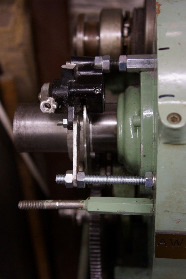

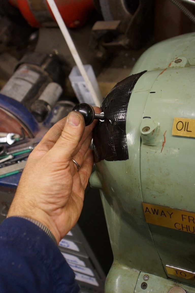

09/09/2014 12:45:40
I recently sold my old colchester roundhead student which started the motor directly when lifting the starting lever and upon dropping the lever it switched off the motor and allowed the spindle to coast to a stop however if you wanted it to stop quicker you could press down on the lever it applied a brake..very usefull if you are in a rush when a large 4 jaw chuck is mounted with a large lump of steel in it.
My new lathe came fitted witha matrix clutch which is great...only starting the motor once a session...but no brake with a clutch model..
So I bought a secondhand bicycle disc brake caliper made a disc out of stainless plate 2.5mm thick mounted that to a carrier and grub screwed with dogged screws onto the lathe spindle...mounted the caliper onto 2 studs tapped into the gearbox casting and it works great.
I was going to use a cable to remotely operate the caliper but after mounting I tried it out with just a bolt in the actuating arm and thought ..just a hole in the panel with a knob on the shaft and it'll do
I hope the pictures are self explanatory
