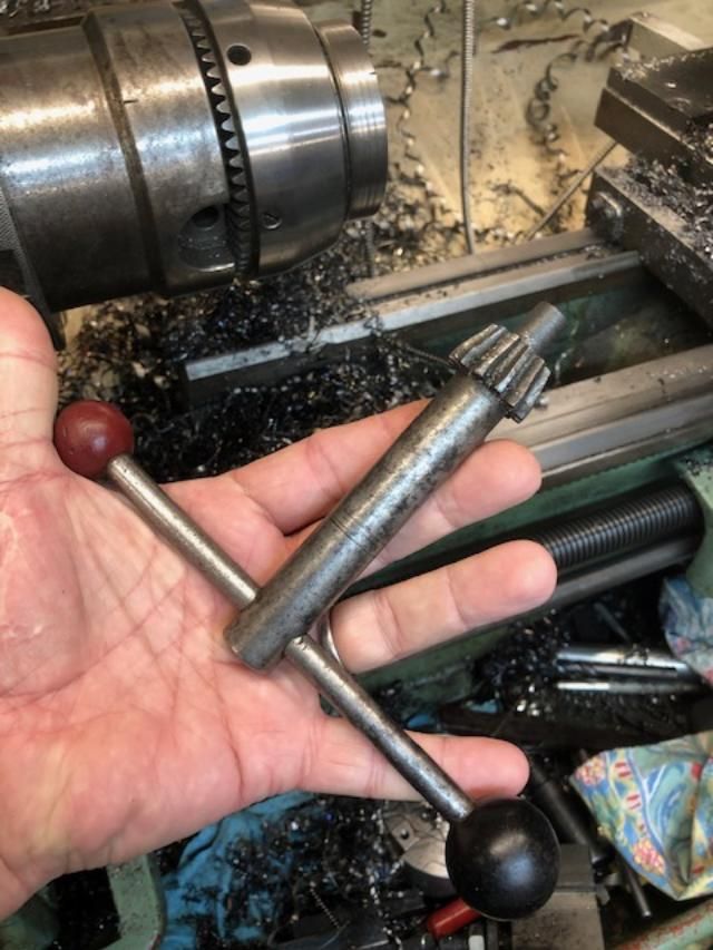

Thread: Warco GH600
25/11/2019 09:04:57
Did you start the lathe with the red ball hanging over the end of the splash tray and start power feeding towards the chuck?
