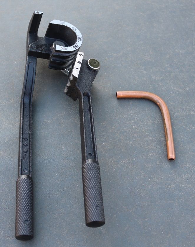

Posted by Rik Shaw on 19/08/2014 20:04:07:
In ALDI today found these pipe benders reduced from £9.99 to £4.99 so I grabbed one. It will do 6mm, 8mm and 10mm. I did this bend OK on 8mm copper tube, it flattened it a little on top of the bend but a quick squish between the vice jaws bought it back again but increased my target bend angle from 45 to approx. 50 degrees.
Found that by decreasing the bend angle from 45 degrees to about 40 degrees and THEN squishing gave the required 45 degree bend.
Not a bad bit of kit for less than a fiver.

Now they look worthy more so at that price, will be keeping an eye out for them here when they land down under.
