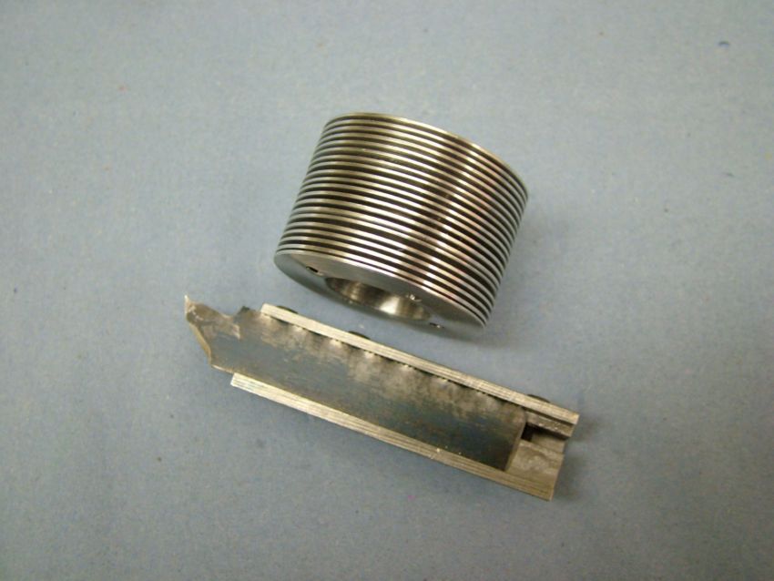

I made one for doing some deep fins on a cylinder head. I don't have any dimensions to hand but this is what it looked like. The blade was clamped by small cap head screws, the holder then held in a Dickson Quick Change Tool Holder as normal
It's quite a while back but I think I hand ground the end of a slot drill to give the slight angle (dovetail) on both lips which worked well enough to give a good grip on the blade.
Hope that's of help

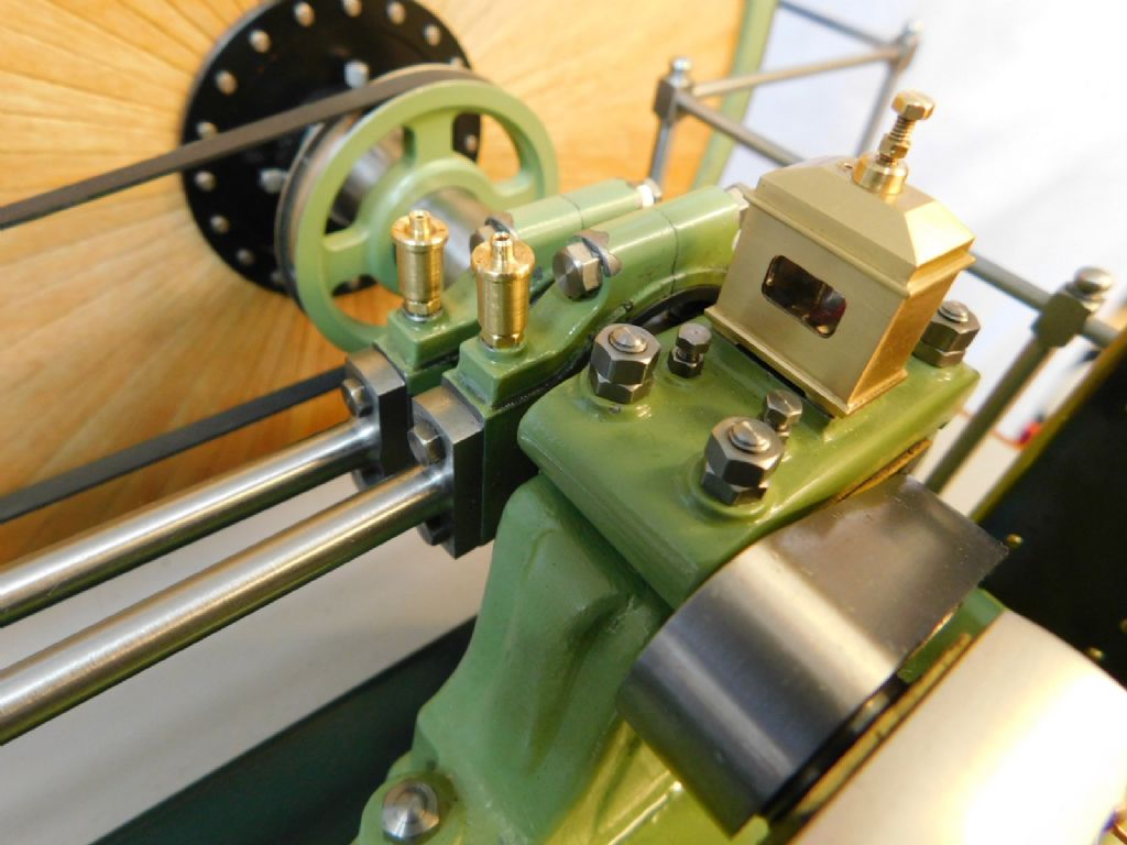

Doc, a small tip.
Where the eccentrics (and pulley) sit turn a shallow slot just wide enough for the grub screws to sit. Use a dog point on one and a cone point on the other screw. Use the dog point one for initial setting and once established tighten the cone point to fix it's position securely. By turning a shallow groove you won't deface the surface of the shaft with the grub screws.
You can slot the flywheel in the lathe easily enough but getting the two exactly 120 degrees apart won't be unless you can move and lock the head the desired amount - not easy on an ML7with it's 65 tooth bull wheel unless you have a dividing method that locates in the rear of the spindle.
Personally I'd just do the one if the dividing becomes an issue.

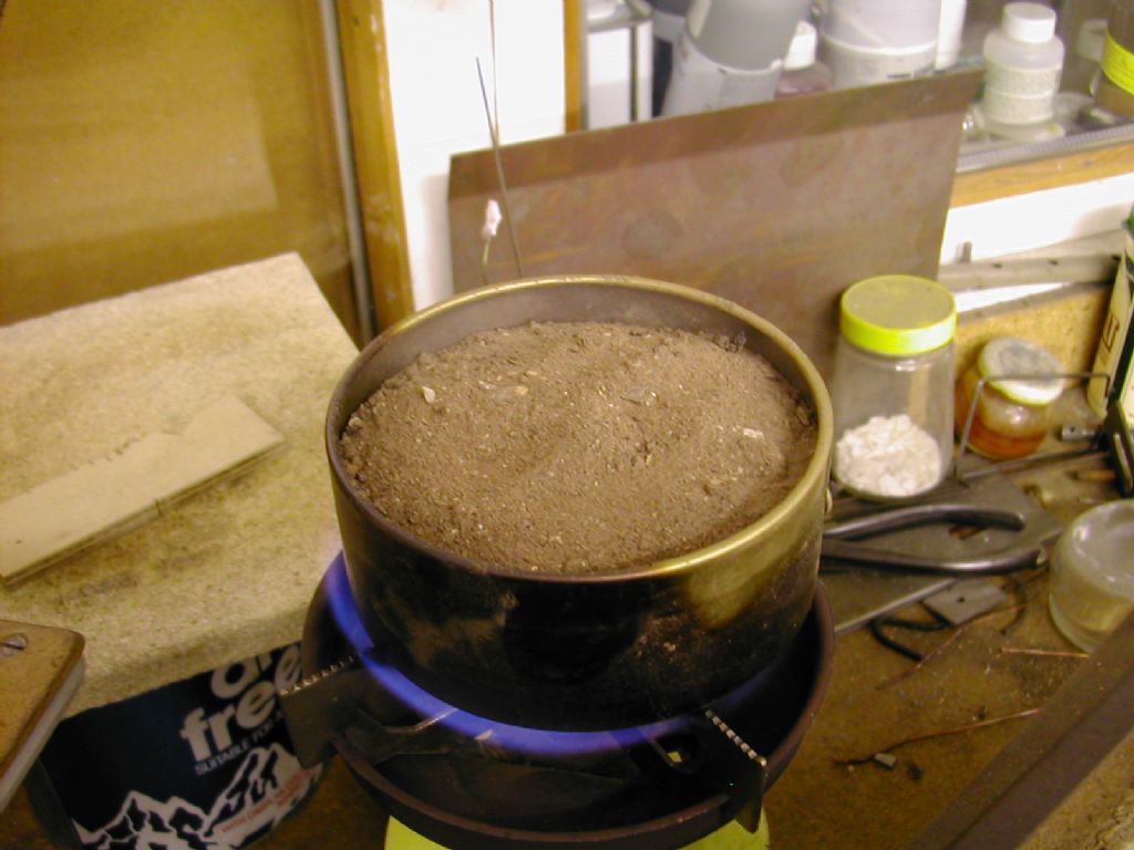

John if the cover is as hard as it would appear likely you could try annealing it. The secret for success on that for cast iron is allowing it to cool as slowly as possible.
If you have, or can source, some fine ash from a fire this is about the best you can get for a home job.
Heat the ash in a container as hot as possible then heat the component to a good, uniform, bright red heat. Form a cavity in the ash and drop the cover into it and rapidly cover it over with a good thick layer of ash. Just leave it to cool right out as long as possible. Don't be tempted to pull it out to check it too soon as you may risk chilling it again! Though it will look pretty crappy once done you won't damage it and you can do it again if necessary.
Here's my simple set up for treating bearing balls so they can be drilled for governor weights
Cooling in very hot sand
Hot dry fine sand will do the same but you need to slowly reduce the heating of the sand to get a good result - ash is much the better.
Doing it in a barbeque is another option - just let in cool away from any breeze in the embers but you have less control over the situation.
Personally I'd go for the ash treatment every time

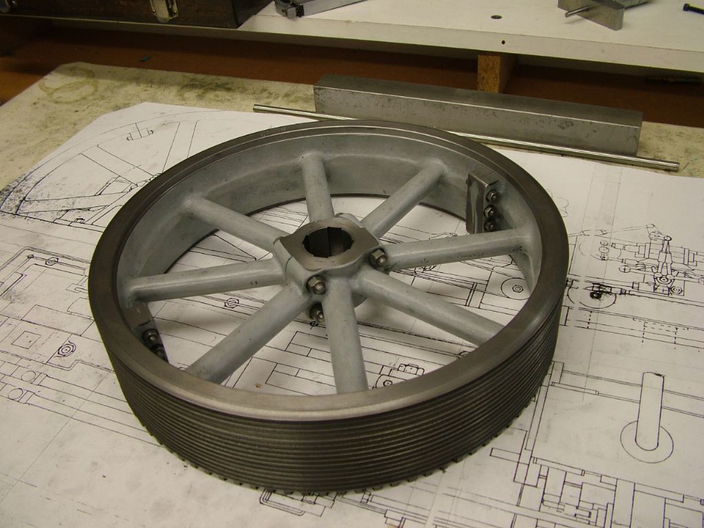

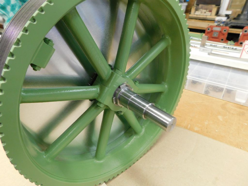

I can't recall how it's shown on the drawing Doc and couldn't remember whether I used a key(s) or not.
Found the answer here in this image!
A compromise at best, if I recall correctly there were three at 120degrees and as with the governor belt something that always irritated and I wished I'd done something better.
On the Corliss I tried to replicate full size practice and use eight slipper keys - four shallow slots at 90 degrees in the flywheel
The shaft has four flats milled on and the flywheel held in place by four keys each side
I confess there is a well disguised grub screw in there holding the wheel from any lateral movement !
That may be of interest to you. The big thing with multiple conventional key ways is ensuring they are all in line with each other - slipper keys give you a small but helpful sideways leeway.

24/07/2022 14:46:51
So when do we get to which locknut nut goes on first !!!
I have quite a few books on industrial stationary engines and it's quite an eye opener when you look at the various images to see where the 'right' way is used - quite rarely in fact.
Same with washers - I prefer not to use them but it's a good point on spoiling the paint however a tip to help prevent that is to chamfer the lower corners of the nuts before fitting. Usually quite successful providing it's not 'graunched' up home
