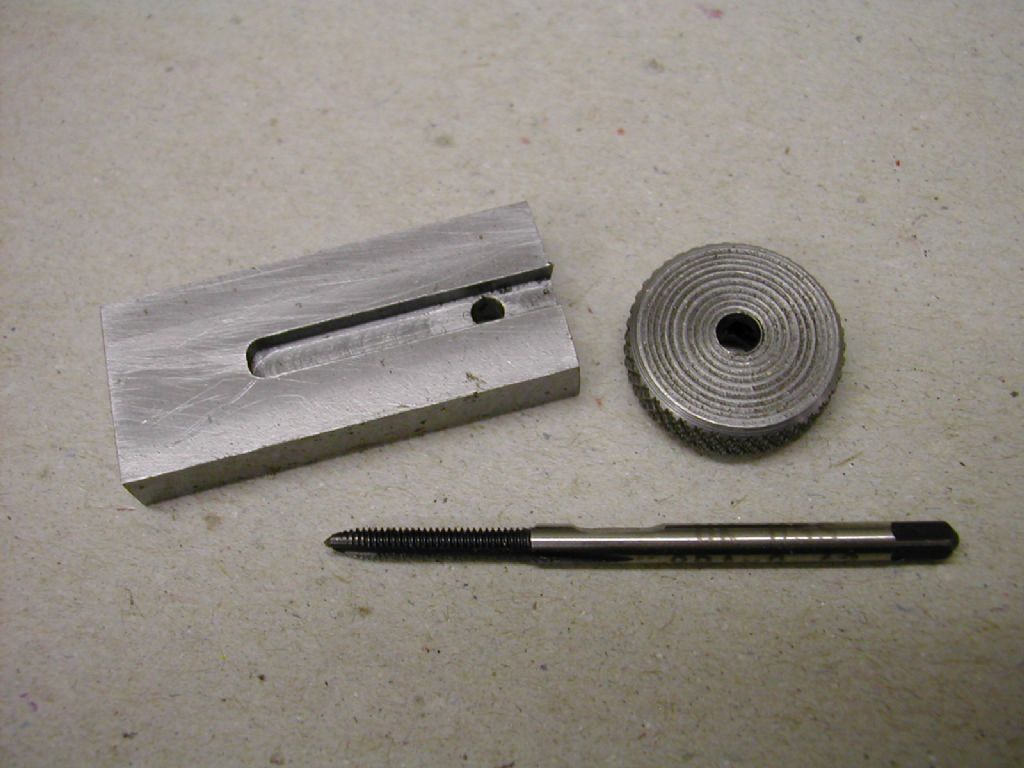

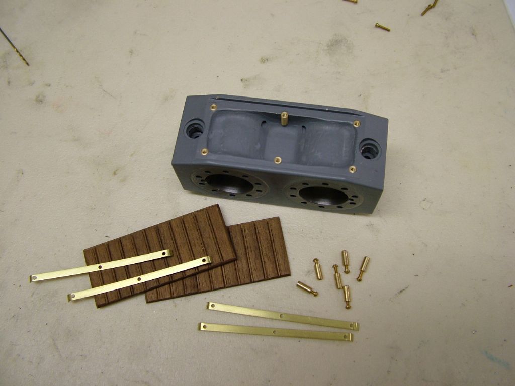

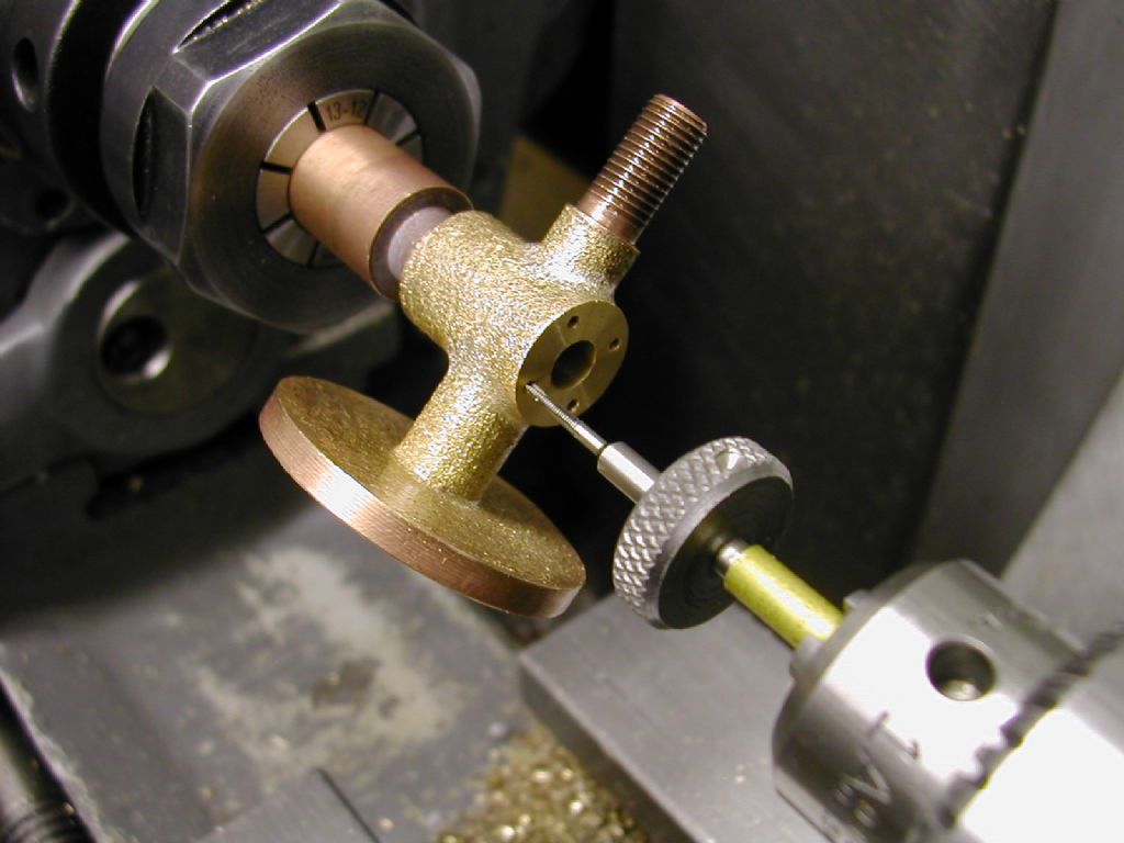

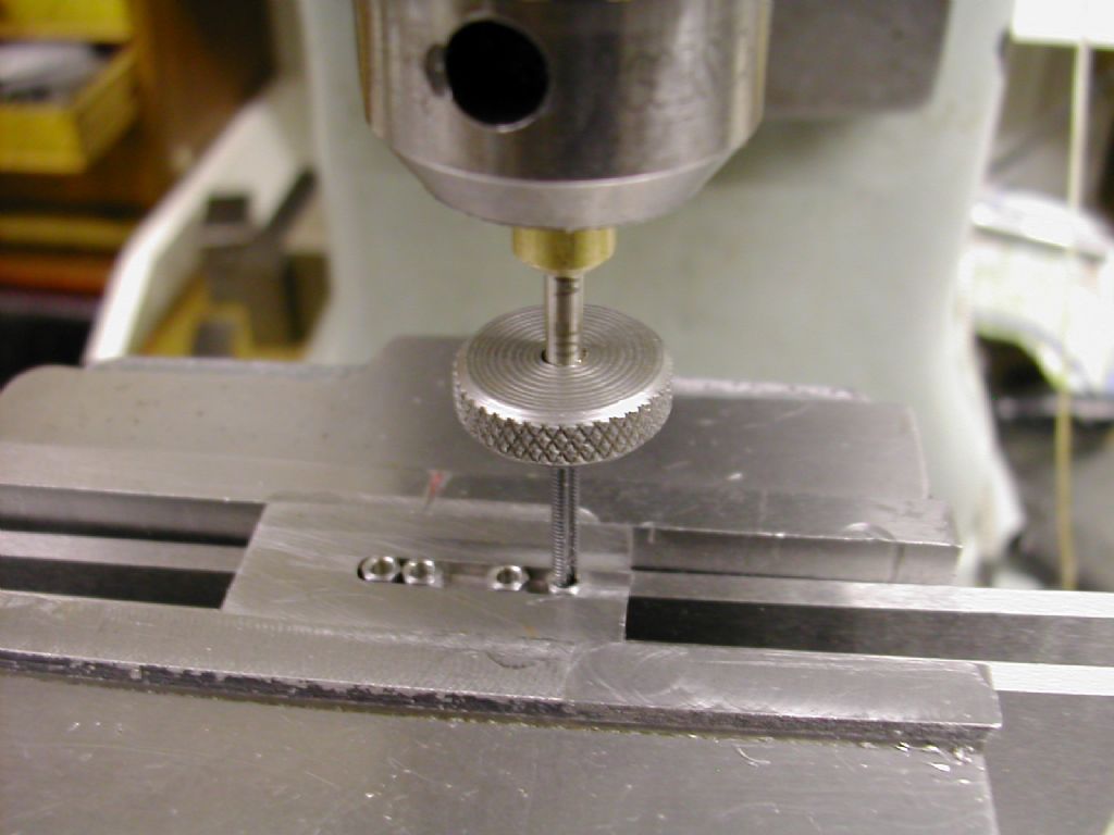

With regard to drilling and tapping very small holes in cast for such things as lagging bolts things can be eased slightly by using a slightly larger tapping drill but a much safer way (safety as in looking after the tap) is to drill and tap small brass inserts on the lathe and Loctite them into pre drilled holes in the casting.
If you are unfortunate enough to break the tap then at least it's not in the casting.
Best - Tug

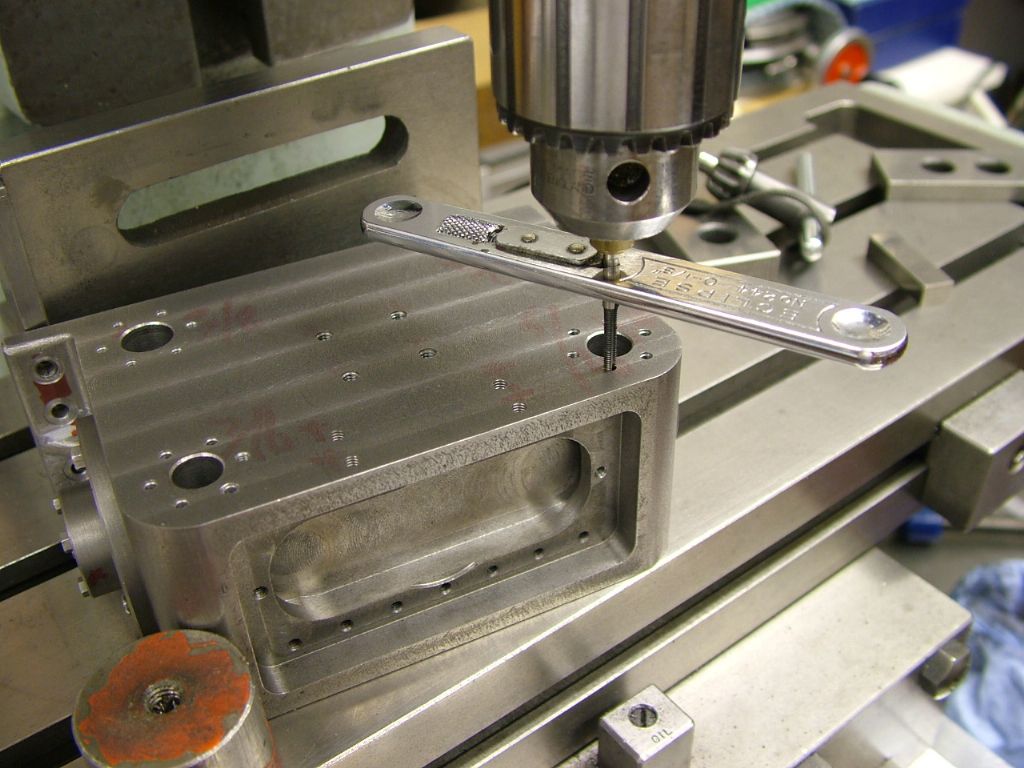

I don't like the internal support cone centre for one reason - you need three hands particularly to keep the contact with the tap as it drives forwards.
I much prefer to hold the tap very loosely in the chuck and use the method Jason shows but always grind a small flat on the side of the tap for a positive drive even on small taps down to 10/12BA. Tap shanks are not always a standard size but if a brass tube can be drilled or found to fit and held in the chuck as a guide even better
I don't think these small Eclipse tap wrenches ae available any more but are ideal for this. This is tapping 8BA - 48 holes on two cylinder blocks without a hitch. For the smaller 10 BA and below taps I use a circular tap wrench - just a slice of 3/4 dia knurled MS with a grub screw in it to drive the tap - again on a flat on the shank. The tap is turned between finger and thumb - very sensitive feed back from the tap
I don't know how many small (5BA down) holes there were in total on the above build but all were put, without breakage, in this way or by gently gripping in the drill chuck, turning the drill on then off and as the spindle runs down use the residual motion to drive the tap in four or five threads until the drill stops. Release the tap, remove and finish by hand.
Hope that's of interest too

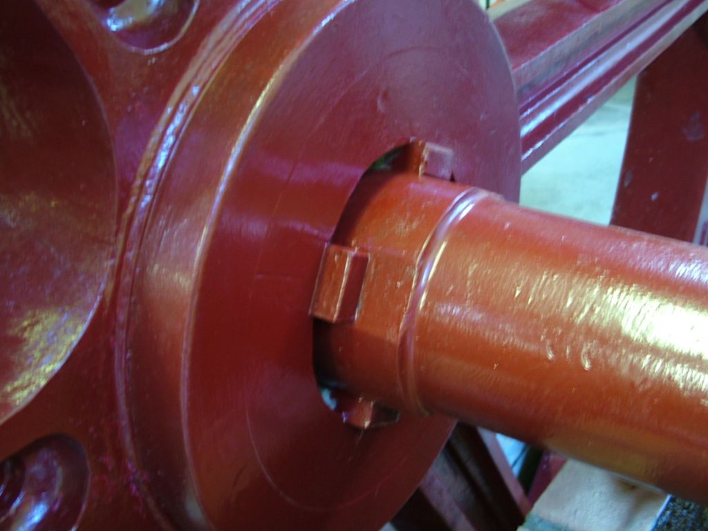

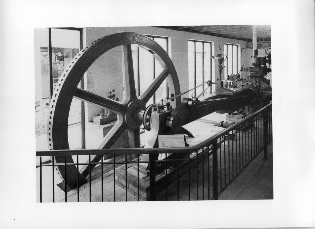

You can only just see the staked keys on this gorgeous McNaught Corliss valved engine in the Science & Industry (not Technology as previously said) museum in Manchester

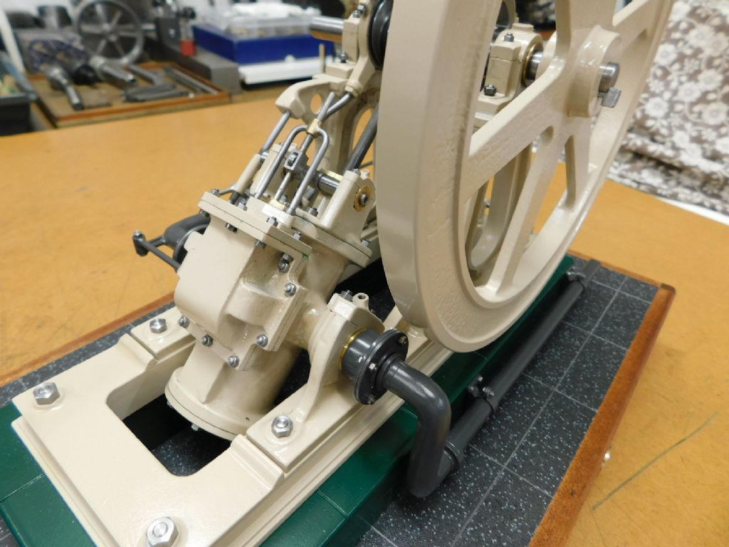

This is the flywheel on the Galloways piston drop valve cross compound engine at the same place

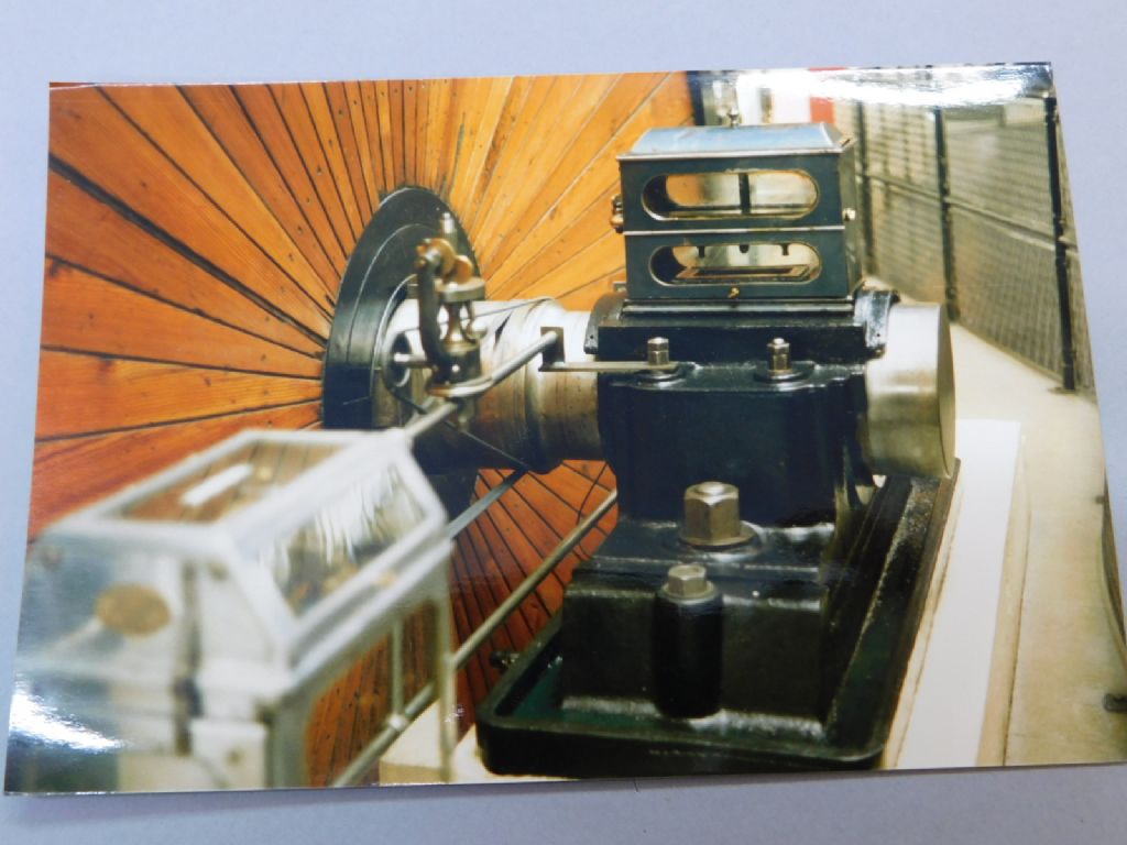

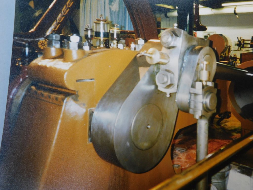

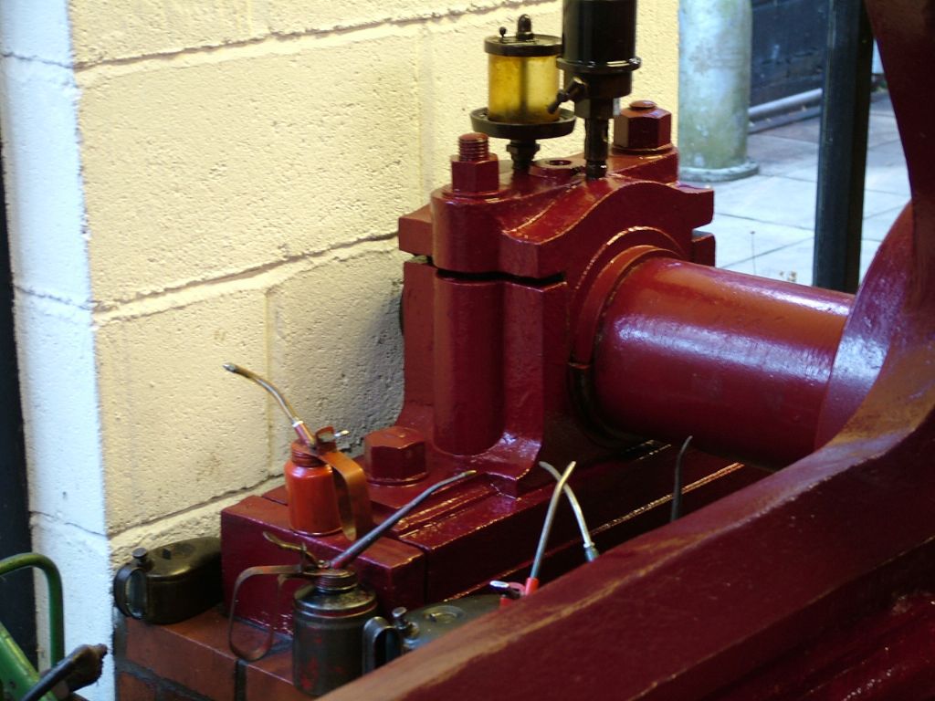

A main bearing on another cross compound in the Kew Bridge museum. Built by Simpson it has an identical twin which was situated in the Strumpshaw St. Eng. Museum in Norfolk. Note the centre in the shaft, no key in the crank web and thin nuts on top plus other details.
And another main out rig bearing, more in keeping with Doc's intentions on the Hick and Hargreaves Corliss valved engine in Forncett. Note the typical variation in nuts on a renovated museum exhibit

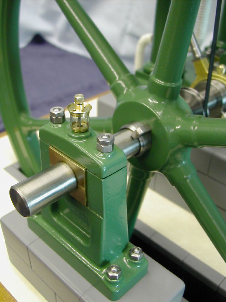

Hick 2
With regard to the actual machining a slot or keyway. Like most matters there's a huge variation on the manner in which to achieve either. Regrettably however, most are not conducive with doing it on an ML7 with limited kit - to my mind that is the major factor to be taken into consideration before offering advice that the recipient would find difficult if not extremely unlikely to be able to put into practice.

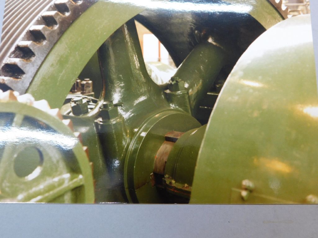

I have found some old photographs this afternoon taken at the Science and Technology museum in Manchester. I can't scan them but I can take an image so will do so later. there are several details that may be of help.

I found this pic of the 'staked' flywheel on the Corliss in the Forncett museum - a bit dark but you can see the annular gap and the four keys if you click on it

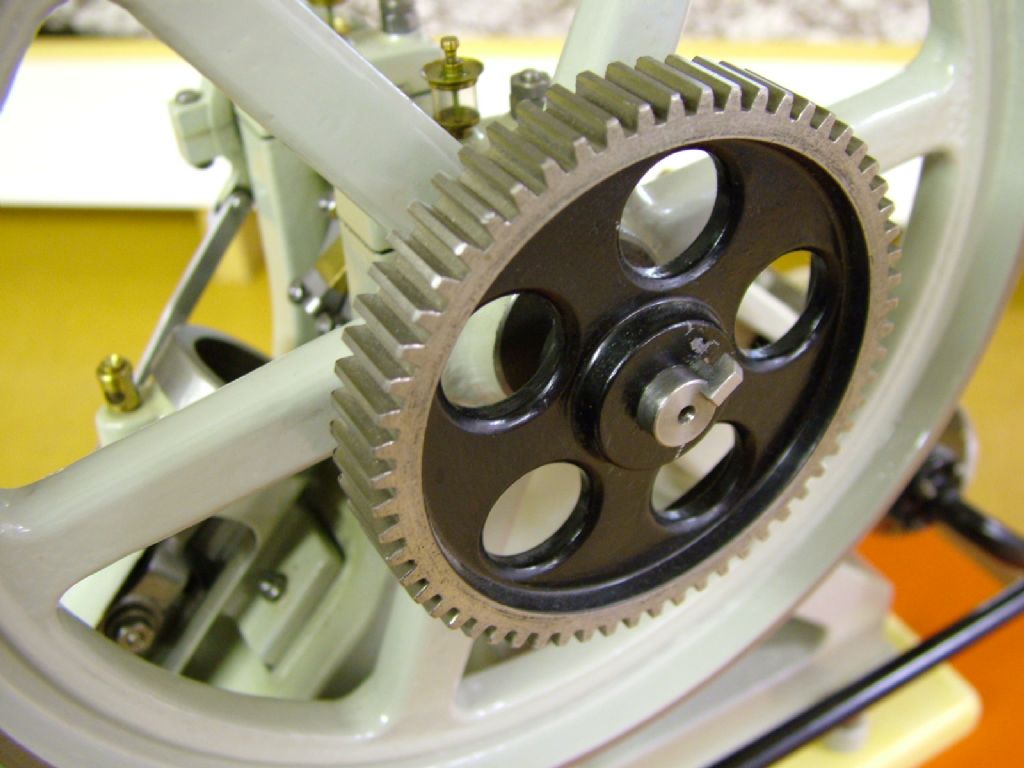

I really must be getting old! I just checked the Waller, Double Diagonal (which is as far as I am aware a true scale model of the original) and the Mc'Onie.
All have headed keys as shown in your sketch Doc but I know I made them parallel, slightly over thick then filed them with a very slow taper so they bind tight - they are all of course driven from the ends of the respective shafts
(This shows the drive gear but the flywheel is done in the same fashion).
There is nothing wrong with this method but you were saying that the key you have will only stop where it touches and then be held by a grub screw. The small area of the key will soon wear from the inertia of starting and you will have a rocking movement develop quite quickly - only my opinion of course but that's how I see it and it's there for what it's worth.

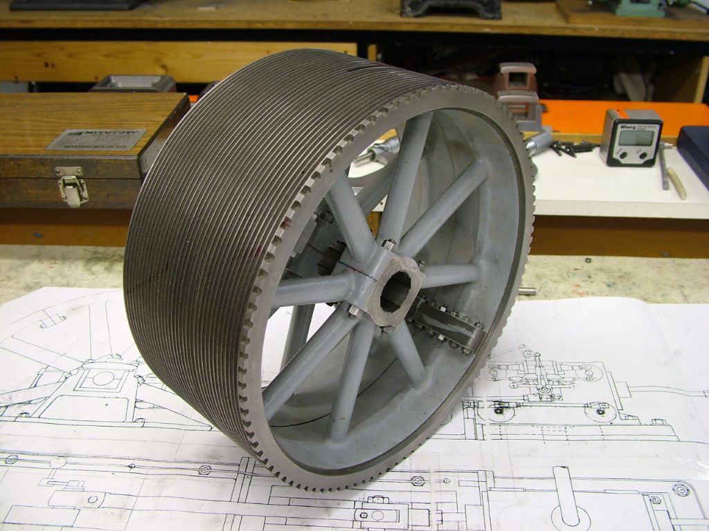

Doc,
As mentioned previously, yes you can machine the tool bit from Sil St and it should do the job fine but just harden it, I wouldn't temper it. The tool needs backing off on all sides - particularly the width otherwise it will rub and wear as the slot deepens producing a key way with tapered sides! Definitely not what you want.
This op on a lathe is one that has to be done slowly, even with a one thou cut, the force require is considerable. Again on an ML7 with that small saddle wheel as a driving force a huge difference from a Marlco broaching set up - and a larger lathe of course. The wider the key the more force required. Jason's idea of roughing first is one way of getting round this but to my mind at no more than 3mm wide it's best done in one hit.
The tool/ toolbit holder needs to be short and reasonably substantial if flexing is not to occur. That will produce a tapered key way of unknown angle.
It’s not like me to simplify things, but I can’t see any huge issues? *
(* disclaimer - I’ve never done this before)
This is not a difficult op Doc but it has many potentials for slight error that will be only too obvious when fitting the key(s)

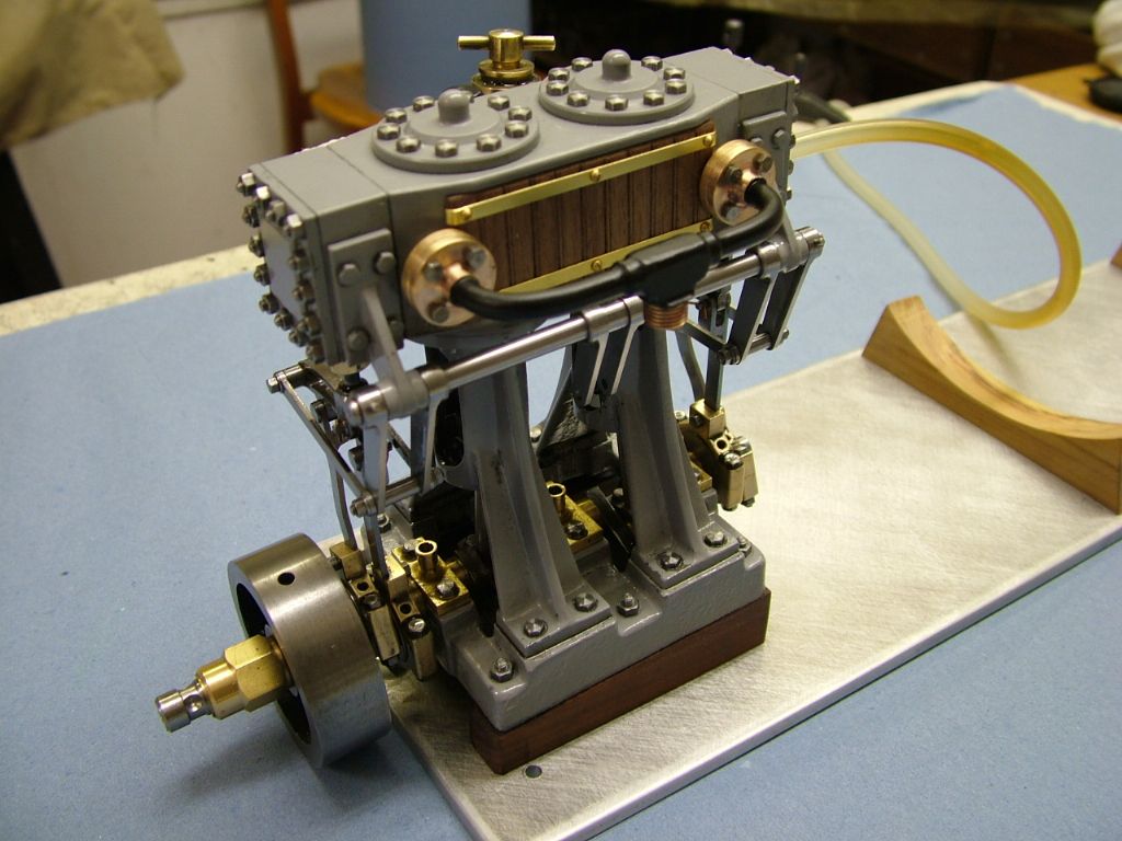

I have just cut the keyways in the coupling and flywheel drive ends on the Marine Compound. The issue how to hold them in place poses the same question so a discreet grub-screw it is.
Sorry to quote myself guys but that is exactly what I said - once more bearing in mind the kit at Doc's disposal ...
The slot in the shaft for the key is obviously parallel and done on the milling machine or in the lathe if you have a cross slide milling attachment and can lock the spindle
The keyway in the flywheel is for the most part and certainly in Doc's case likely to be cut using the lathe as a shaper. The only difficult part about that is A, to accurately shape a cutter of the desired width and B, to position it dead on centre line. The spindle does need to be held from rotating and he best way to do that without a purpose made spindle lock is to use the lowest back gear.
Getting the two keys at the same angular position however without a positive dividing device on both is flying on the seat of your pants - as said before personally I'd put this to one side - idealism is one thing reality is another but as always it's about choice. It's a lot of 'accuracy requirement' for little or no positive effect save for the satisfaction of trying and possibly some scale effect.
I made a slotting head for the Super 7 that can be set to cut a tapered keyway but have never had to use it in that fashion save once on the Bentley but that was at an angle on a tapered surface.
Here it is being used last week on the couplings referred to
There is still the difficulty of grinding the tool bit (by hand) to the right dimension at the same time as keeping it equal about the tool bit diameter but for a one off this could be milled in silver steel with far more accuracy.
Despite being very careful in slotting the shaft the slots were slightly oversize so a stepped 2-2.15mm key had to be made at one end and slightly less at the other
