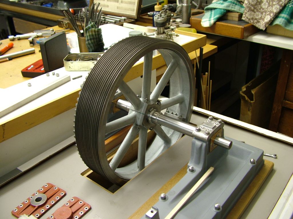

25/08/2022 17:42:45
Doc,
I can't think of a single full size crankshaft with an axial pin to prevent the crank moving but there are the odd few that have a tight fitting axial key. As far as I'm aware all full size engines of the size you are replicating would have had the crank shrunk on so a key is unnecessary. Loctite 638 or similar replicates this with ease. The crankpin(s) is just Loctited but I make the last mil or so on the spigot a tight fit in the crank web hole
Apart from one, all the cranks I have made so far then have been Loctited and pinned but with a radial pin going in from the outer diameter of the crank through the shaft and just into the crank opposite. This gives the strongest shear but with only one face to disguise the pin on and a curved one at that - much easier to do that than a flat one if using the likely file and emery paper. The odd one was an attempt at shrinking on but it was well and truly stuck before reaching it's location - never attempted it again.
Crankpins are never pinned but I do make the last mil or so a tight fit as the crankpin reaches its location
That said the shaft and pins are both pinned on this latest one, mainly to assist in reinforcing the shaft as a whole, a 2.5mm pin if my memory serves right. Getting the pin to be invisible is a bit of an art if the crank is a finished item but easy enough if gone about the right way - that can be covered when you get to it. You can just get a hint of it on the upper surface on the right

25/08/2022 13:17:43
I suppose that depends on how the bearings are finished off - I don't see this as an issue as you can see the bearing face on the Corliss is just that circle on both sides so the bearing face area is the same either on crank or shaft.
The important thing is that there is clearance on one side or the other so it doesn't matter which side as long as the crankshaft is captive and not allowed to float. Trying to bring both faces on each bearing to a smooth running fit risks the possibility of a tight fit but then the bearing could be tweaked on the faces if so.
This really is a choice thing I guess but I prefer to use the inner faces to keep the shaft in place axially - after all if you don't have a second crank but a pedestal then that's all there is. dscn0966.jpg
As you say Jason, all interesting thoughts throughout a build such as this especially from Doc's perspective
Regards - R

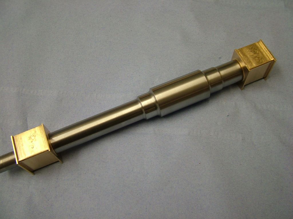

25/08/2022 11:31:52
As an addition to the last post if you take a look at this image again you will see that where there is need for location - Crank web and bearing seats - the radius is reduced to virtually nothing and the mating parts lightly chamfered to accommodate any slight radius in the very corner - no undercuts required.
All other shoulders have a radius - why would there be a need to undercut such and besides it will probably lead to comments such as "What are those undercuts for ?" if you do - horses for course etc
Best - R
Edited By Ramon Wilson on 25/08/2022 11:32:33
25/08/2022 10:34:17
I would agree to a degree with Jason here Doc as I didn't take on board that the steps were so shallow.
Even so there is no need to undercut unless something is going to sit firmly against the shoulder in question - money and choice are the keywords but an exposed undercut in a shaft for no practical reason is not going to look right - well not in my book smiley
On the other hand if the shoulder is to locate something then yes an undercut would be needed if the step is minimal.
Though I have quite a few Dickson toolholders I don't have an extended version - just using a longer piece of HSS is enough if the occasion warrants it.

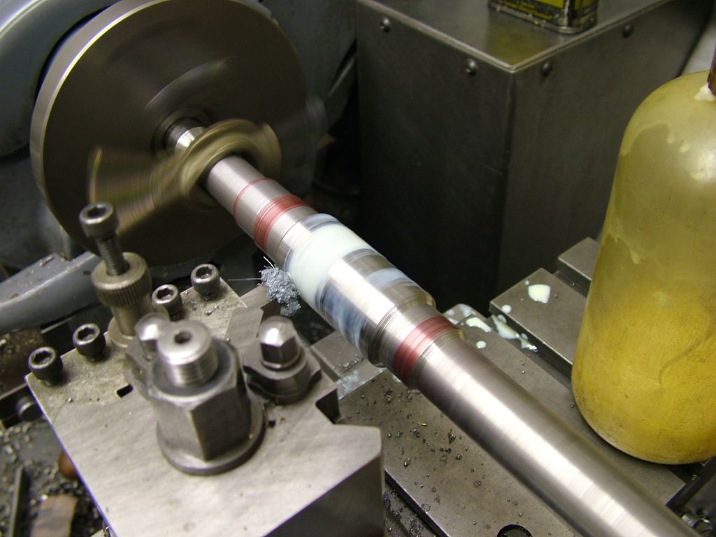

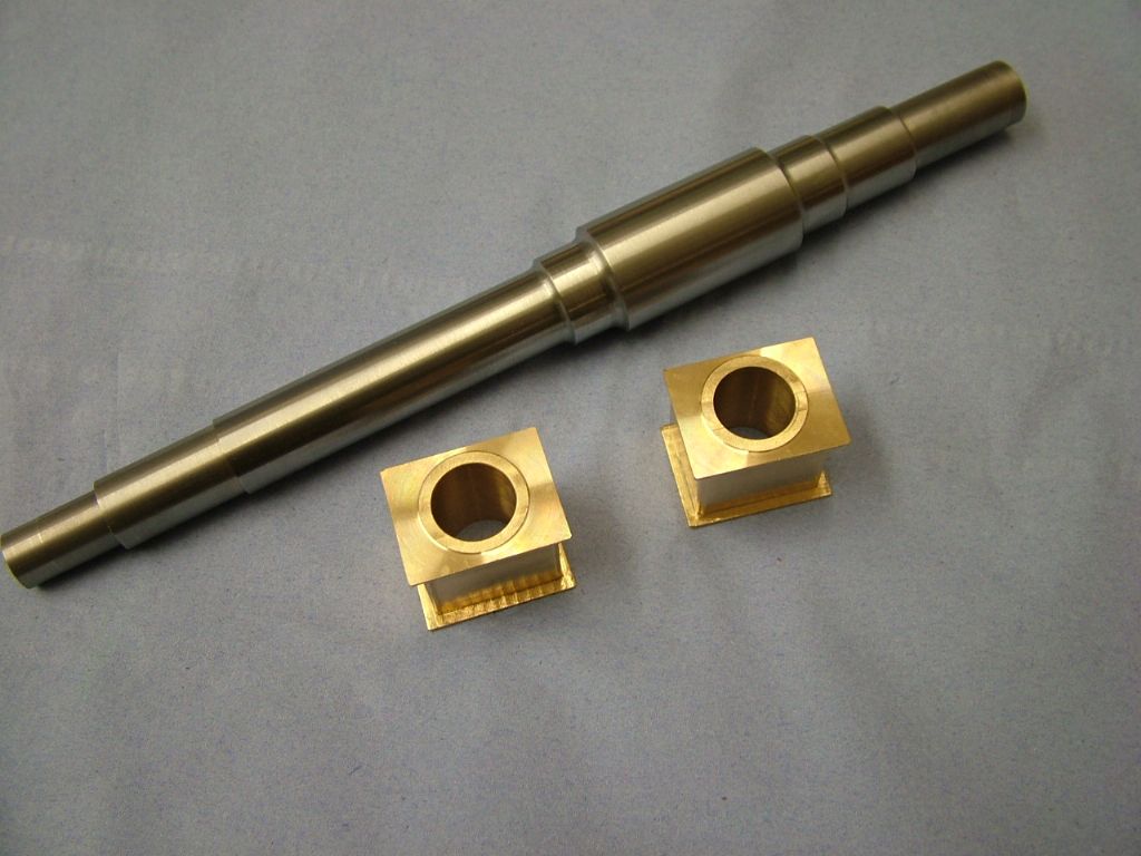

Thread: Stuart Twin Victoria (Princess Royal) Mill Engine
25/08/2022 08:51:47
Doc,
I don't use the top slide for turning unless I'm turning a taper and certainly would not use it to turn parallel - just too much effort to get it set right only to lose it as soon as it needs moving. You can soon get bogged down in how to set the TS dead parallel which for this operation simply isn't required but, advice is what it is, you do the choosing.
I can't recall my ML7 but setting the topslide parallel interferes with the tailstock on the Super 7 when turning between centres giving restricted movement on the cross slide. My top slide is permanently set at 15 degrees for that very reason and only gets moved to change the angle if required
There really is no need to undercut the shaft, there's no justification for doing so besides it's not full size practice.
The tool you have ground is fine - you may just need to tweak it a bit to improve the cutting - part of the learning process in grinding tools by hand. Here's a short version of the one I posted previously roughing out the crankshaft for the Corliss engine - virtually the same as your shaft just larger
It was finished with the other, longer, tool shown previously. Note the radii - an undercut would be considered to reduce a crankshaft to a thinner diameter for absolutely no practical reasoncorliss project (66).jpg
If you have a dead stop then use it in this case. Carefully face a small length(s) of steel to the dimension(s) required and set the stop. With one hand on the hand wheel lift the self act lever a little before the stop is reached and finish off the last few thou by hand. A dead stop is not designed for running into under power! As Jason I have no DRO on the lathe - doing the above provides an accurate method by simple means.
As always though the advice is based bearing in mind on what kit you have and how I would tackle it as such. You do the choosing
Best R
