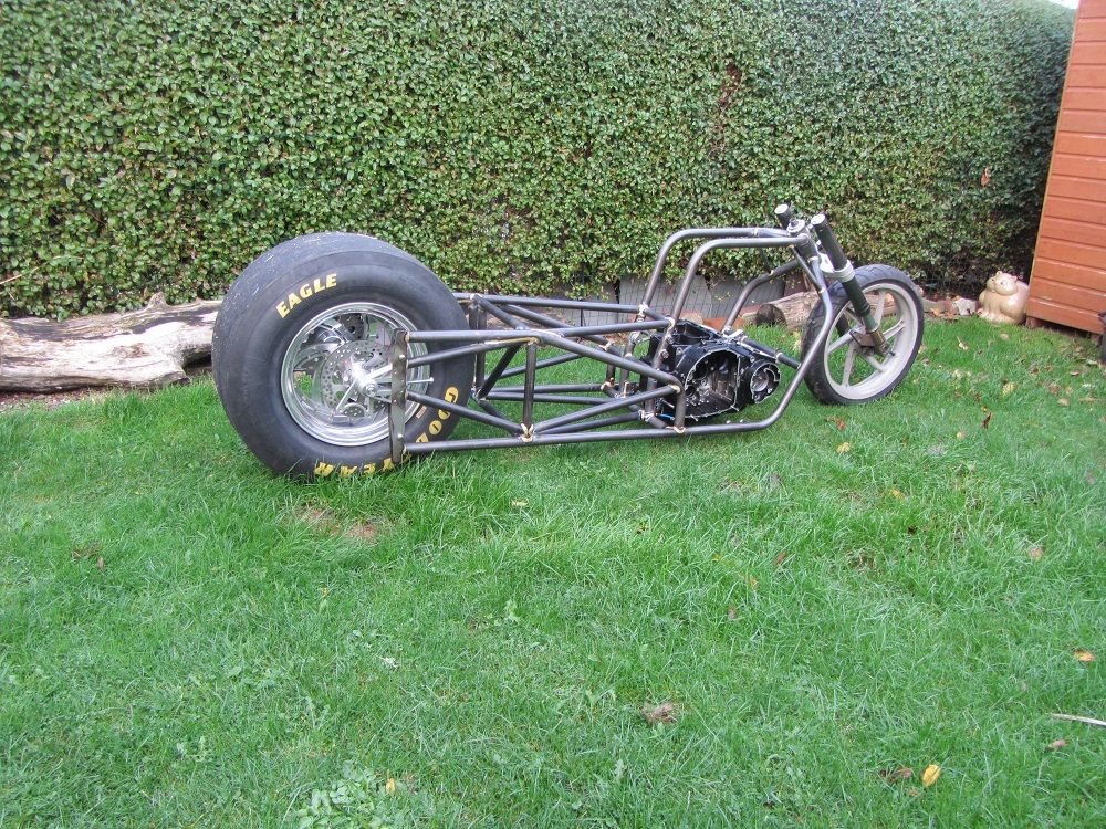

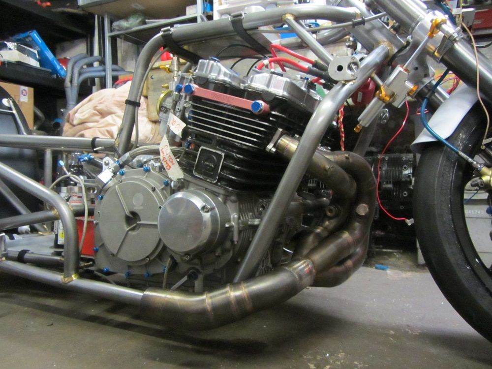

22/12/2017 14:55:25
Posted by Phil Crossley 1 on 22/12/2017 14:36:12:
Few pictures of my motorcycle. Built from scratch in my sisterscellar. It's been quite competitive so far, winning the 2016 championship and 2nd this year too.
Lots more info and build stuff at **LINK**
Edited By Phil Crossley 1 on 22/12/2017 14:39:20

Andy Swinging Arm Slade and his group will be in the second episode Andy has been officially timed a year ago at 222mph at Elvington on his motorcycle not bad having only half an handlebar to use.
He might be at Pendine speed record attempts
The Model Engineering and speed attempts whether water or land is like a big family and helpful advice is always available.
