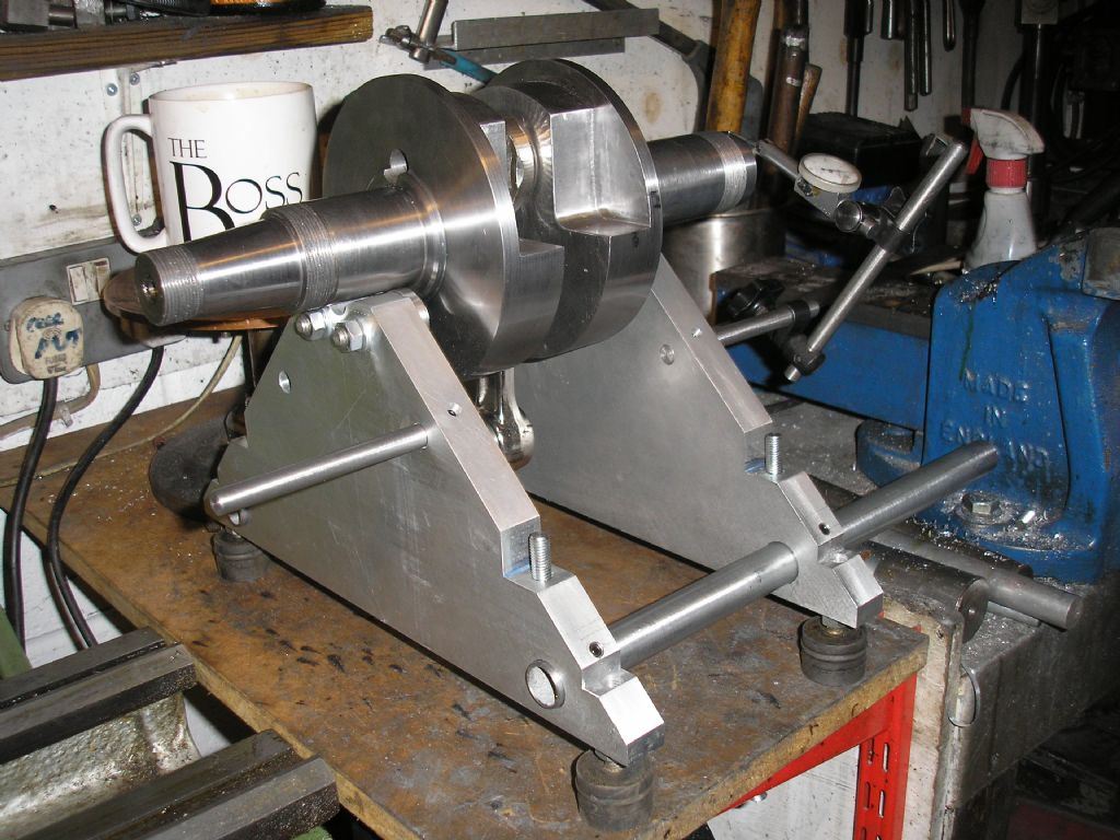

29/11/2018 13:49:39
Yesterday was talking to two fellow motorcycle speed record nuts hopefully next year a Gem gas turbine streamliner will be tested.
Friend Graham should be giving a talk at PEEMS club early next year about his steam rocket bike a work of engineering excellence.
Myself finished last night my crankshaft aligning with detachable straight edges for balancing jig.
The base feet and straight edges can be adjusted for levelling.
Apart for £2 for shims everything else was from my spares box the 20mm ally was donated by another speed enthusiast.
Crankshaft aligner and  balancing
Crank aligner
Edited By Windy on 29/11/2018 13:56:46
