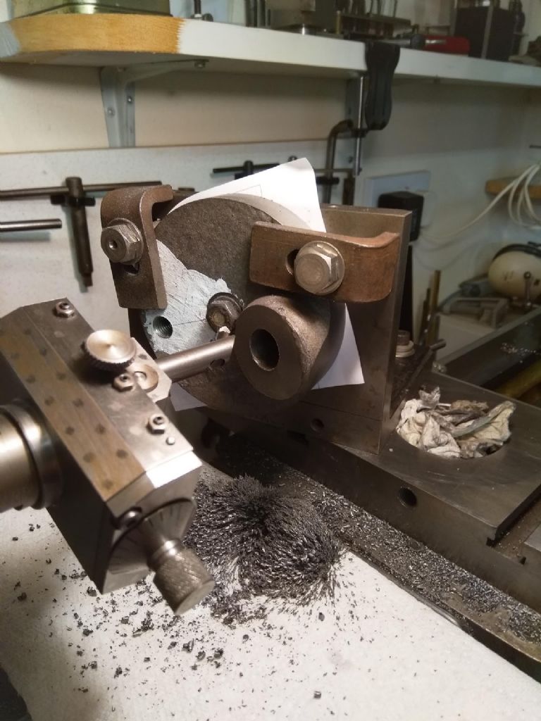

When I machined my tailstock turret castings recently I used a magnet under a piece of paper towel, this saved a considerable amount of cast iron dust from scattering around but as Howard says doesn't totally eliminate it. What amazed me when I came to do the final clean of the lathe was how far the dust travels. I stand on duck boards in front of my lathe and when I lifted them to clean underneath the floor was black from the dust with very little other swarf.

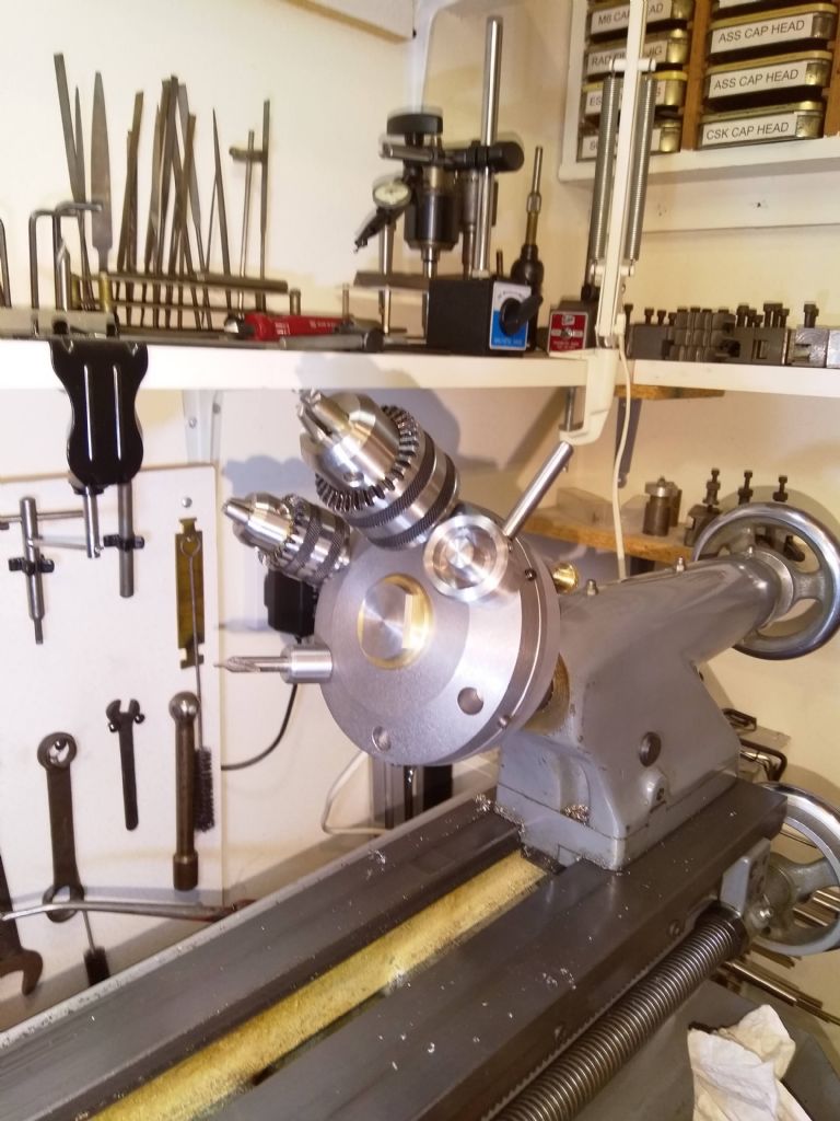

Having finished the turret a few days ago I've realised that I've not been keeping this thread up to date, so to continue.
I assembled the turret and mounted it in the tailstock and utilising the spring detent l was then able to rotate the front casting to pilot drill the six holes required for the tool holders.
Having opened these holes up to 3/8" reaming size l discovered that my only machine reamer of that size was blunt on the tip, for a hole only 5/8" deep a sharp one was paramount, so I had to wait a few days whilst a new one was ordered. Note to self - check these things beforehand!

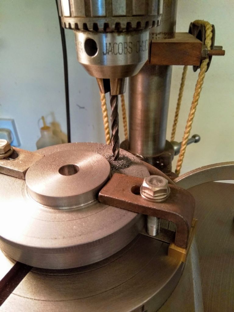

The final machining operation on the casting was to drill the six holes on the periphery for the locking screws that will retain the various adapters and toolholders. This was done with my rotary table mounted vertically on the drilling machine.
Having tapped the locking screws holes, the turret was then reassembled and fitted with some of the adapters/ tool holders that I'd previously made for the final photo.
Having spent all this time making this turret l really wonder how much use it's going to get, but that aside it has been a very interesting exercise although I'm not impressed by how much time I've had to spend since in stripping and cleaning the lathe to remove all the cast iron dust.

Here you can see the rotating casting mounted on the rotary table on the drilling machine to have the six detent holes drilled. If anyone is wondering, the cords each side of the drill column is my crude method of counterbalancing the weight of the drill table. Its something that I rigged up in a hurry probably 30 + years ago and have never got round to improving but as they say "if it ain't broke don't fix it ". As you can probably imagine the drill table, rotary table and the casting being drilled all cast iron is quite a weighty lump to manoeuvre around, so I was quite glad of the counterbalance no matter what it looks like.

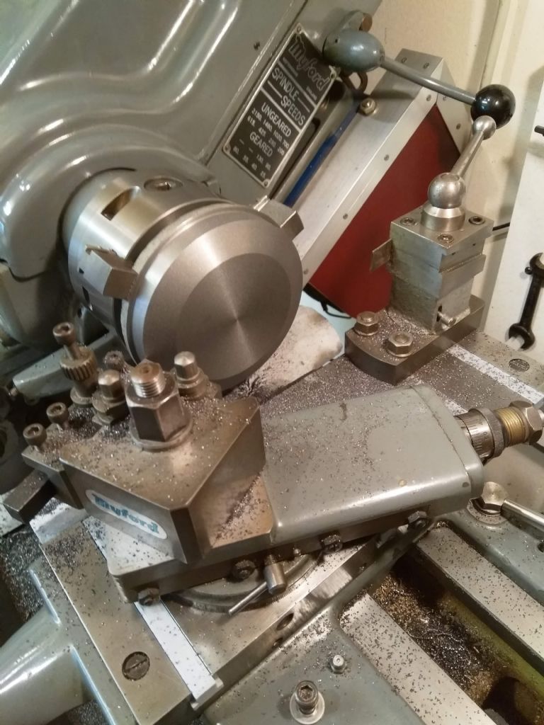

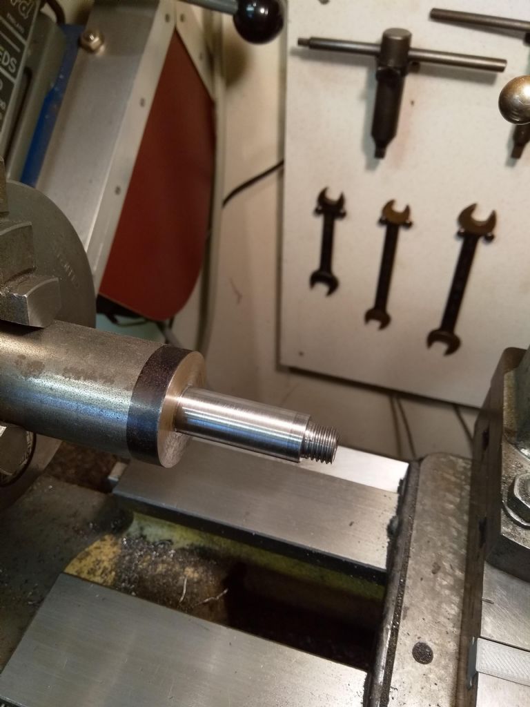

The next stage was to make a mandrel to mount the rotating casting on to machine the reverse side. This was made from a chunk of 1 1/4" b.m.s. which when this duty is finished will be modified to become the securing bolt that holds the two castings together.
img_20210308_144511.jpgAs I had turned the mandrel to be a very close fit in the bore of the casting i was more then pleased when I could not detect any runout of the casting when it was reversed to finish the machining.
img_20210307_145937.jpgNext will be the drilling of the detent holes on the rotary table.

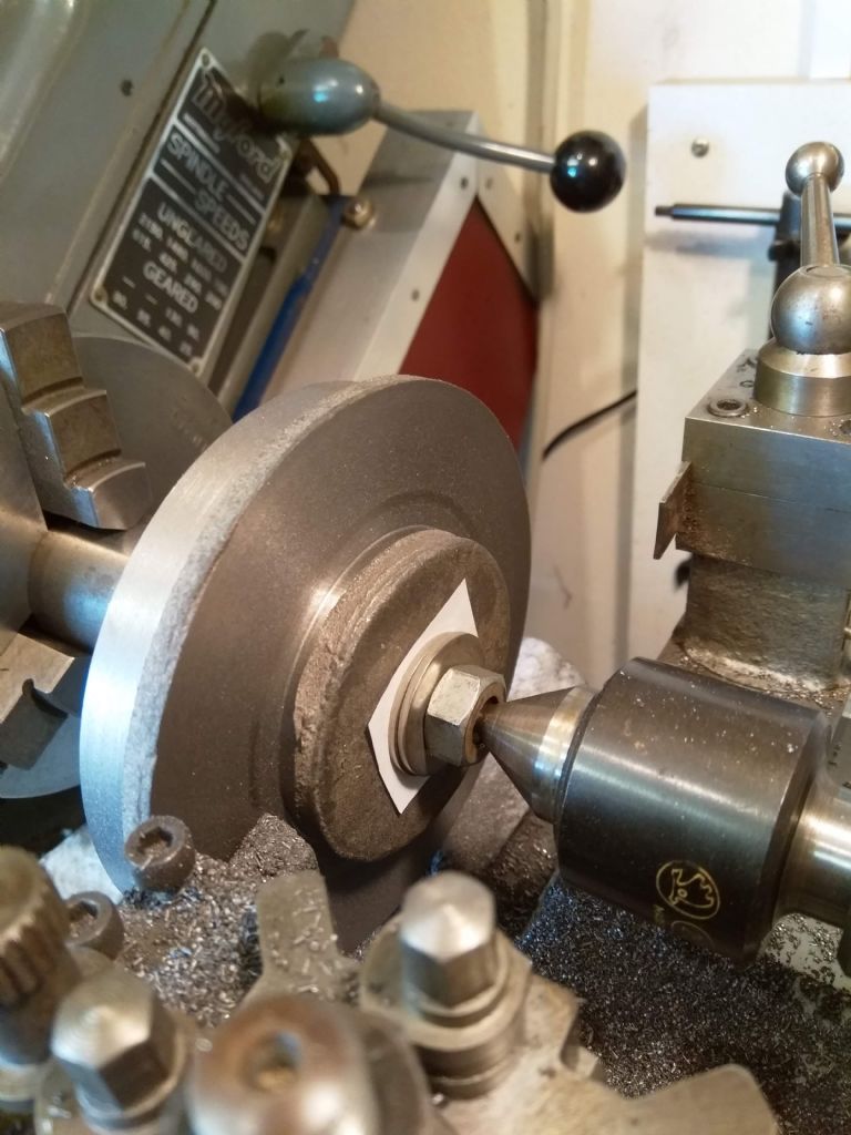

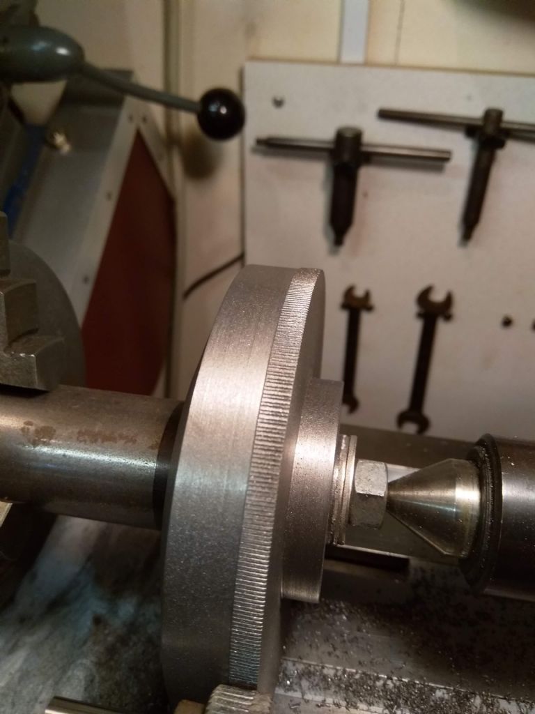

I was originally going to show this photo in my thread on building the tailstock turret but I feel it's more relevant here. With this casting at 4" in diameter the chances of finding a clamp type knurling tool are pretty remote, so l decided to do a straight push in knurl with the tool held in the tool post. Even with the lathe in slowest back gear the knurling wheel was whizzing round far too fast, so I reverted to a handle in the lathe mandrel and turned it as slowly as possible. Now I am aware of the strain that knurling puts on a lathe but I had no idea how much until I was knurling this casting, I could feel the strain being imposed on the bearings and how difficult it was to turn the feed screw to increase the depth of knurl, not least of all the difficulty in turning the mandrel handle. Ideally I would have liked to have had a deeper knurl but I just didn't want to put the lathe under any more strain. I realise that this is perhaps an extreme example but it's opened my eyes as to how much strain knurling can place on our hobby sized machines. Phil.img_20210308_142900.jpg

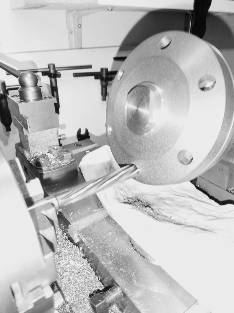

So the next stage with this turret is machining the rotating casting, a great deal of head scratching and thought was required to enable me to machine this and maintain concentricity where it matters. The raw casting was mounted in the three jaw chuck using the outside jaws and the outer face of the casting was machined to size, the 20 degree tapered section was a minor problem as swinging the top slide round to achieve the angle meant the feed handle was fouling on the cross slide, so I had to remove the handle and replacing it with a convenient piece of scrap to enable me to rotate the feed screw. The part of the casting underneath the jaws that can't be machined at this stage will be removed later as concentricity is not important here as this area is just knurled to provide a finger grip. img_20210301_143016.jpg
The next stage was reasonably easy, the casting was drilled about 10mm dia and then opened out to finished size with a boring bar, there was a lot of spring in the bar so multiple passes at each setting were required before finishing with a 1/2" reamer. img_20210301_155713.jpg
The piece of paper towel has a weak magnet behind it to collect the worst of the iron dust but l won't be sorry when all the machining of the castings is finished it really is messy stuff!

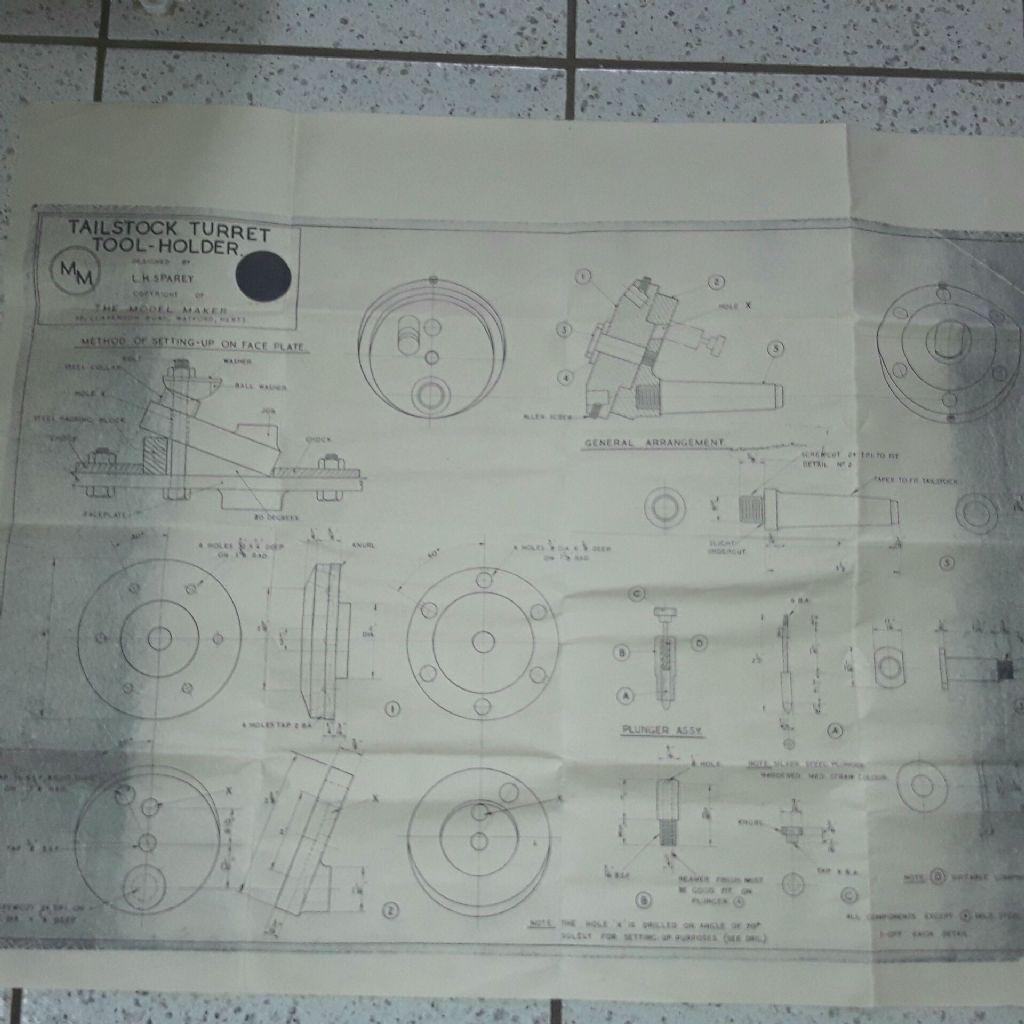

As I'm going to build this i thought I might just as well document it as it may be of interest to others. I decided to start with the body casting as it is the trickiest then the rest must be easy! However, I've hit a snag before I've even started and that is how to hold the casting for machining. If you look at item 2 on the drawing the left hand face needs to be machined and a 2" register bored with a 3/8" tapped hole right through. I can't hold it in a chuck because of the spigot on the rhs is too large to allow the casting to sit in the jaws of the chuck.
20170508_095508.jpgI could hold the casting in the chuck and drill and tap 3/8" from the spigot side of the casting and then mount it on a threaded mandrel, then carrying out the various machining in the lathe but I'm concerned as whether a 4" diameter casting hanging on a 3/8" mandrel is pushing my luck a it too far. It can be seen in the top left of the drawing is a suggested method of holding the casting for machining the spigot, but that's not much help for what I'm trying to do. Any advice and suggestions will be most welcome. Phil
