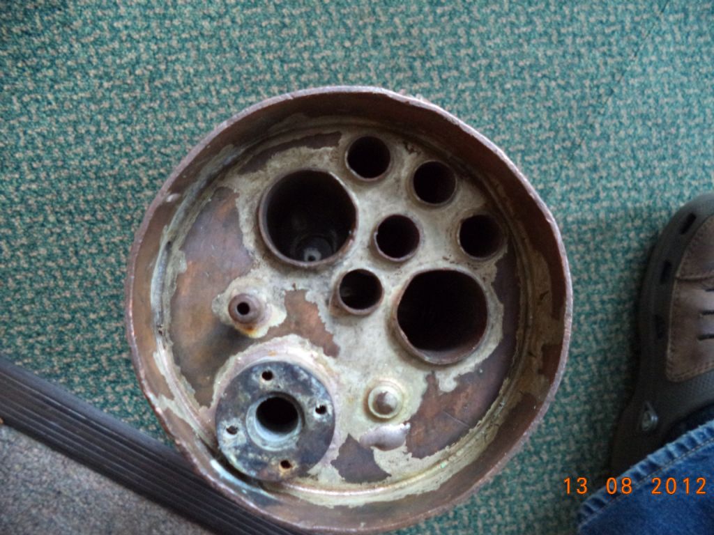

29/03/2018 07:35:58
I've been in touch with another club member and he remembers Glyn building the boiler with another member Ron Maddocks:- its an experimental boiler for Juliet with a deeper fire box to try and increase the efficiency. Glyn was the clubs boiler inspector for many years and I'm sure they would have the fundamentals of the design correct by the looks of it they tested it as well but the boiler was never stamped up, the years caught up with these two wonderful model engineers before they could complete the project.
I'll give the boiler a good check over to ensure that they got the design parameters correct and give it a shell test and stamp it up with a number and offer it to another club member who I know who is building a Juliet, if they don't want it would any of you guys be interested ?.
Stew
28/03/2018 09:46:40
A club member recently passed away, and the club was asked by his relatives to disposing of the content of his workshop. Among the effects we found a completed 3 1/2 gauge boiler that looks well made but no one can identify the locomotive it was intended for so can any of you Guys identify it?.
Cheers
Stew

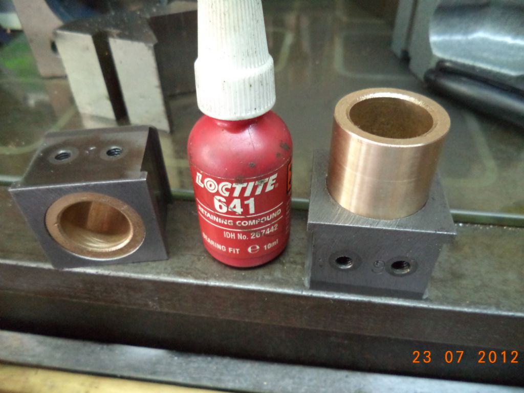

26/03/2018 08:51:25
Just to keep you updated on this.
I've repaired the worn bearing by pressing in a oilite bearing I did both journals just to keep that axle the same.
This is how.
First made a new axle.
Then centred the mill on the unworn axle block using a co-axle clock.
Zeroed the DRO and locked the slides and with a vice stop
Bored out the worn axle box.
Then bored the unworn bearing out.
The Oilite bearing were over size on the OD so made an expandable mandrel.
Turned the bearing down for a tight fit in the axle box
Pressed the bearing in with a spot of Loctite for good measure
Job Done
Stew

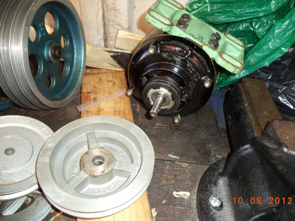

25/03/2018 16:38:49
I've just acquired a Perfecto Shaper I think its a no 3 the 5" stroke model, its complete except for the tool holder and drive belt and the motor needs mounting and wiring up and the drive pulley needs re-bushing, but all sortable issues.
I've emailed lathes.co for information/manual.
But has any one got any info on it, particularly regarding the size of V belt
Her's a few pictures of it hot off the press.
Cheers
Stew

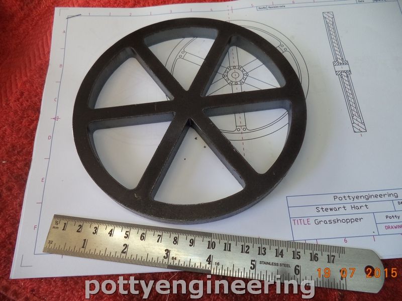

04/03/2018 12:20:06
Posted by Linda Thompson on 13/02/2018 17:11:48:
Hi, can anyone tell me where I can get a 5 spoked alloy flywheel with a diameter of between 10in & 11.5in
You can try getting one laser cut there's plenty of jobbing shops with laser cutters around all you need to do is send them a drawing and ask for a quote
This is one I had done.
And the completed fly wheel
Stew
