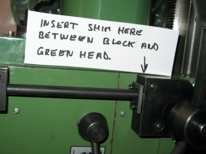

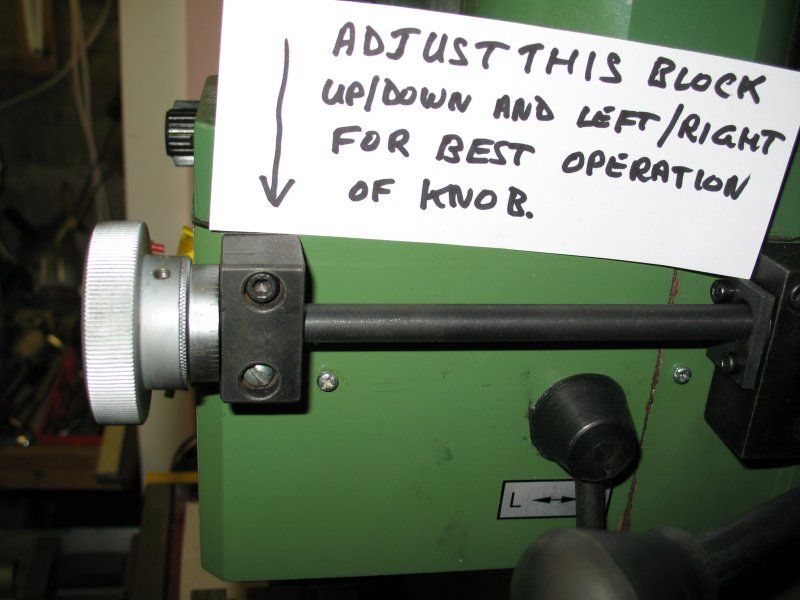

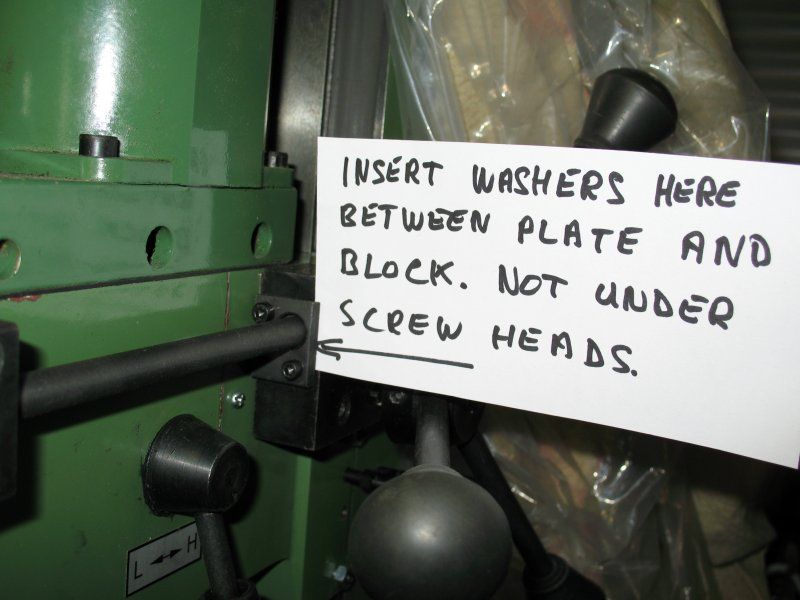

05/07/2010 13:55:35
Three photos which I hope will make it easier to understand what I did.
Here goes.....
Does this help? If not ask again.
In the top photo, I used a piece of shim steel about 15mm wide and the full depth of the black block. It has one hole through which the top screw fits. The shim then just hangs there until clamped by both screws. Th idea is to twist the block round vertically so that the horizontal shaft moves away from the milling head itself.
In the second photo, the two washers are placed between the cover plate and the block and over the screws. It can be fiddly as they are small, and drop off easily.  The idea is to lift the cover plate away from the block thus allowing the worm inside freedom to rotate.
In the bottom photo, the idea is to move the block around  until the shaft can rotate without binding, and the knob can rotate without binding against the block. It could even be that turning the black block round through 180 degrees sideways could help. It all depends on the location of the various holes. Mine are very poorly drilled, and I have plans to replace it sometime.
Regards,
Peter G. Shaw
Edited By Peter G. Shaw on 05/07/2010 14:04:31
