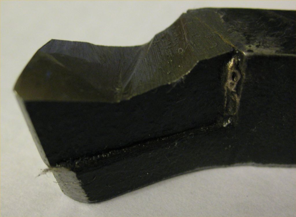

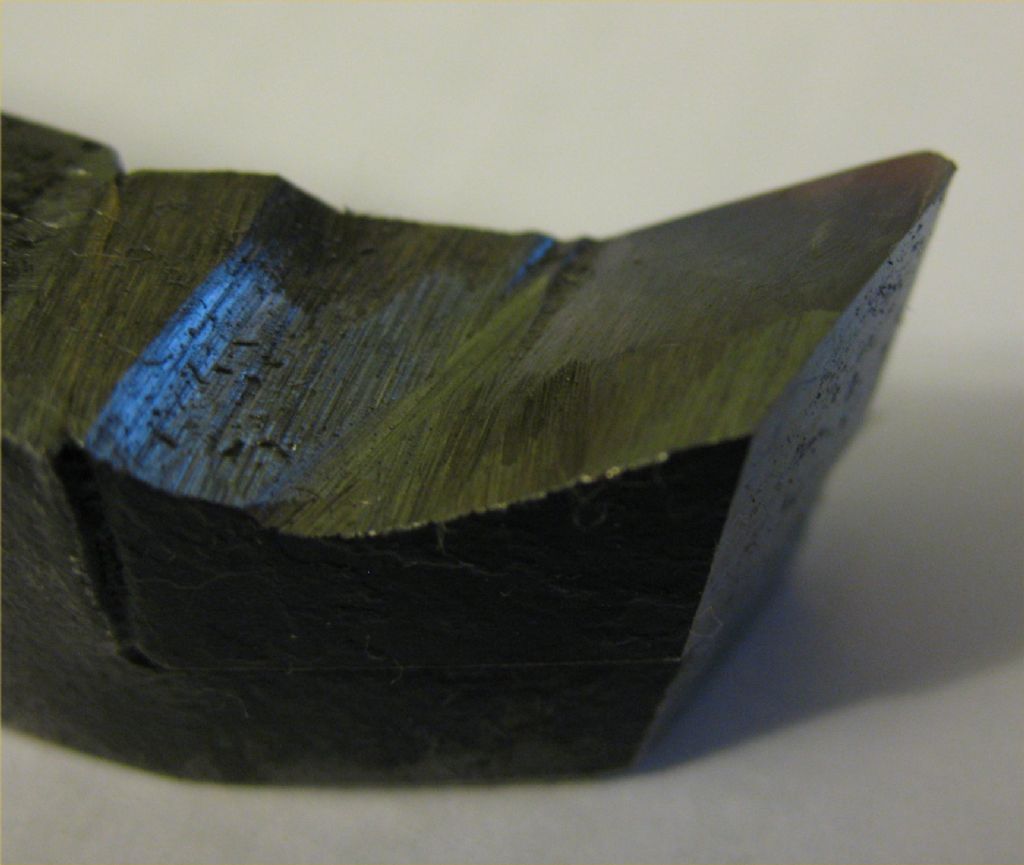

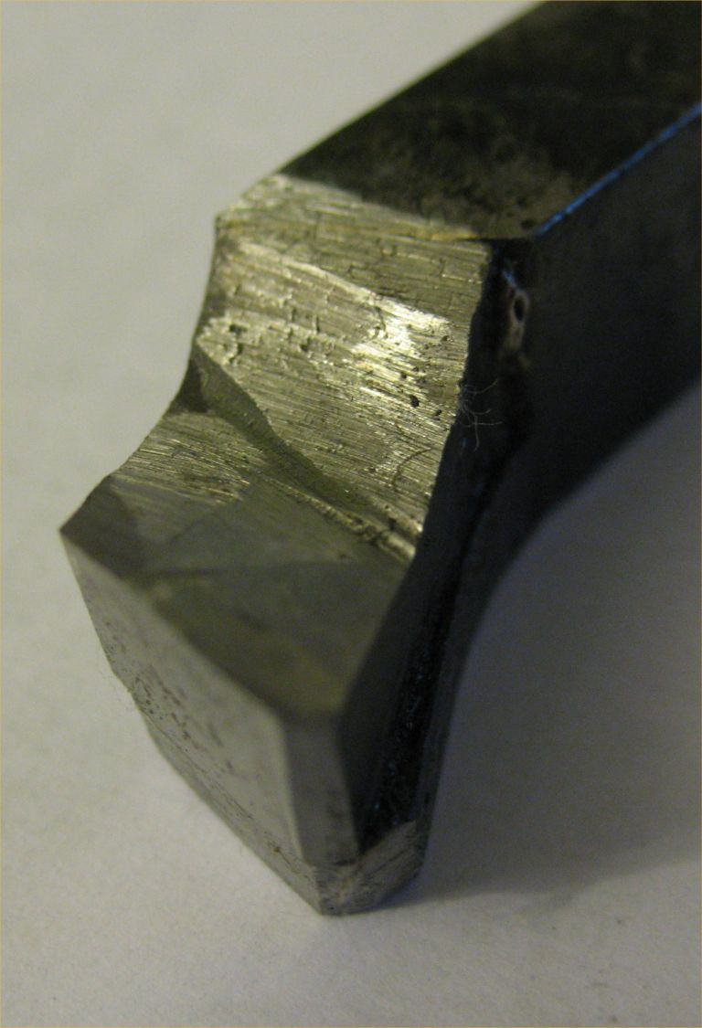

Thread: Tip build-up
02/02/2011 14:05:42
Hi PekkaNF & Versaboss,
I did initially use a TCT tool, but not very good. I do suspect I wasn't cutting deep enough anyway, but I was conscious that I didn't have that much thickness to play with. Agree about using higher speeds, which I did try - I seem to think about 710 rpm.
178rpm is only as advised by Tubal Cain using HSS on tougher steels. If using TCT, he does recommend using 50% to 75% faster.
'Good' tool versus 'bad' tool are purely descriptive. The 'good' tool is one that was bought ready formed and whilst it has been re-ground, as far as I can tell, the angles are more or less as bought. The 'bad' tool is an attempt to make a tool as per Tubal Cain's sketch 'E' on page 5.5 of his Model Engineer's Handbook Third Edition. (Different page nos in earlier editions.) These photos show what I ended up with. It's a piece of HSS brazed onto a MS shank. Sorry about the slight fuzziness of the photos. As you will see, it's hardly a text book piece of grinding, and yes, a tool & cutter grinder is on the 'want' list. However, despite the ugliness of parts of it, I did hone the relevant parts that do the actual cutting and swarf removal.
Strangely, it does actually work, and there wasn't that much difference between the two tools, except that the good tool developed the tip build-up. Which perhaps suggests that more rake would have been better.
Regards,
Peter G. Shaw
01/02/2011 13:01:00
Hi folks,
Thanks for all the comments. Here are some replies.
Terryd.
I wasn't aware that other materials can cause tool build up like that but it isn't surprising, my lack of knowledge that is. However, this may explain why my homemade tool appeared to have tiny edges appearing where there shouldn't have been but I can't really say that they weren't there when I started although I do deliberately try to ensure that all corners are sharp and clean.
I do use DMT diamond hones. I have the full set of double sided diafolds, and for small items, the full set of minihones. This is how I have been sharpening the TCT tools and honing the HSS tools. I've no 1200 grit paper or crocus powder - never needed them before.
As you correctly guessed, the Neatcut is applied by brush onto the work, usually lots of it all round the circumference before I start turning.
Ramon.
The tube is welded.
I have had both chatter and ringing, cured by reducing speed to 250 rpm which according to Tubal Cain is about right for finish turning on BDMS or black steel of 35mm dia. From what I've now picked up, I suspect I may be better going down to 178rpm which T.C. seems suggest is better for harder/tougher steels.
Keith.
Of course I understood you were suggesting whatever you could think of. And I'm grateful for that. Interestingly, Tubal Cain somewhere has said that he always used black steel in preference to BMS because the black steel hadn't been stressed as much as the BMS in the manufacturing process. (My words, not necessarily technically correct, but should give the idea.) In addition, despite my reservations re cutting dry with HSS, I also note that T.C. cuts dry when 'levelling' his lathe(s). And that he recommends when milling to either cut dry, or to flood the work, his reasoning being that damp fluid simply creates a 'mush' which then gets under the cutter and hey presto, bad cutting, whereas the other two don't do that.
Gordon W.
I use scrap steel because I have it! Some of it doesn't seem too bad depending on it's ultimate purpose, but I've come to the conclusion that for my purposes, I am going to have to use freecutting stuff if I want any sort of precision. It does go against the grain having to buy new when I may have something which might do, but I've always got at the back of my mind a comment from somewhere along the lines of 'if it's a bit of good stuff from Jones the scrap, then you could be better off getting a piece of known specification.' Interestingly, my grandson used a bit of scrap and produced a perfectly turned section. Which just goes to show that not all scrap is bad. Experimentation is the name of the game.
General comments.
When I first started this thread, I was interested in the tool tip build-up which I had not come across before, except for aluminium. As I have said before, I do not have any engineering training, hence this is all learning by experimentation for me. And so Terryd's explanation was very helpful.
In respect of the present project, I had the tube doing nothing; I had seen BogStandards article elsewhere on making the squares from tube; so I thought 'why not', I've nothing to lose and everything to gain. And when I started, the thread on different steels hadn't started otherwise I might well have thought again. As it is, I've learnt quite a lot, and apart from a bit of time, I've not lost anything. So what I'm going to do is to order up a length of EN1A, or whatever it is and start again. In the meantime, I will experiment further to see if I can improve my tool sharpening, and try a lower speed.
So, many thanks to one and all.
Regards,
Peter G. Shaw
