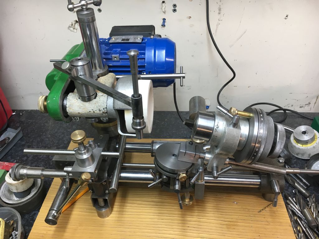

Finally got around to a trial assembly of a much modified Quorn based on Mk2 castings. Still some work to do but the end is in sight. A trial grind on a few drills (4 facet) and HSS lathe tools showed promising results. Not quite got the right settings for the drill geometry so need a little more thought on that and maybe a setting jig for consistent results.
Edited By Gray on 07/12/2018 16:35:14
