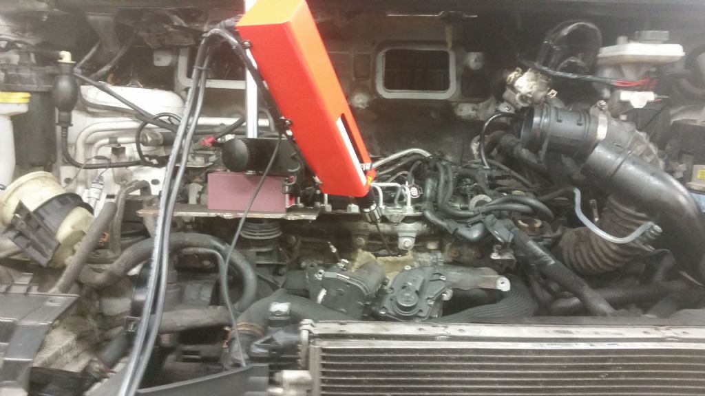

Posted by Antony Powell on 06/05/2017 08:04:16:
but this is the best....
A portable spark erroder unit, this has saved many an engine which would otherwise be scrap, In this picture I am spark erroding a snapped off easyout from a snapped of Glow plug
We didn't snap them it was a job to correct work carried out by a well known car parts store......
Got the bigger brother to that one. Awesome machine.
Biggest job it has had to do was remove the rusted in allen screws from the bed of a 72" Lumsden grinder.
These are big vertical face grinders and the bed consists of many triangular segments that contain the coils for the magnetic table with the top surface being held on by a zillion allen screws. Because these run continuously under coolant when the coils short out it's a major job to replace them.
The small machine like the one in the picture takes about 20 minutes to remove a M10 allen screw. The larger machine takes about 5 - 7 minutes.
From memory, total time to remove all the screws was about 4 days
